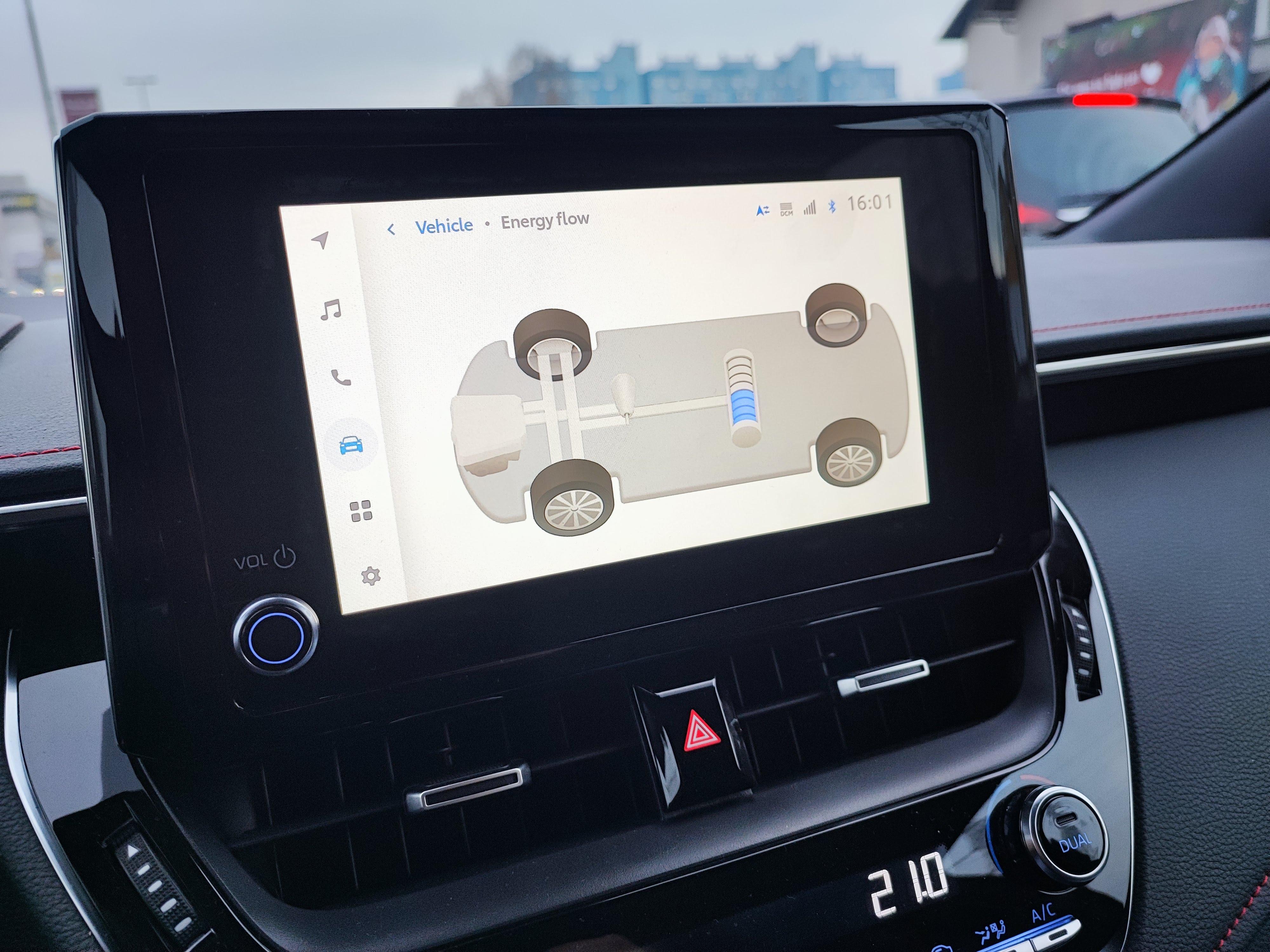

Do we have new graphics after an update?
Not that I have noticed. It was a update to navigation and voice recognition.
Look here.
1 hour ago, Marxon88 said:
Look here.
I don't think I have ever tried to zoom out that far before so I cannot say whether it changed with this last update.

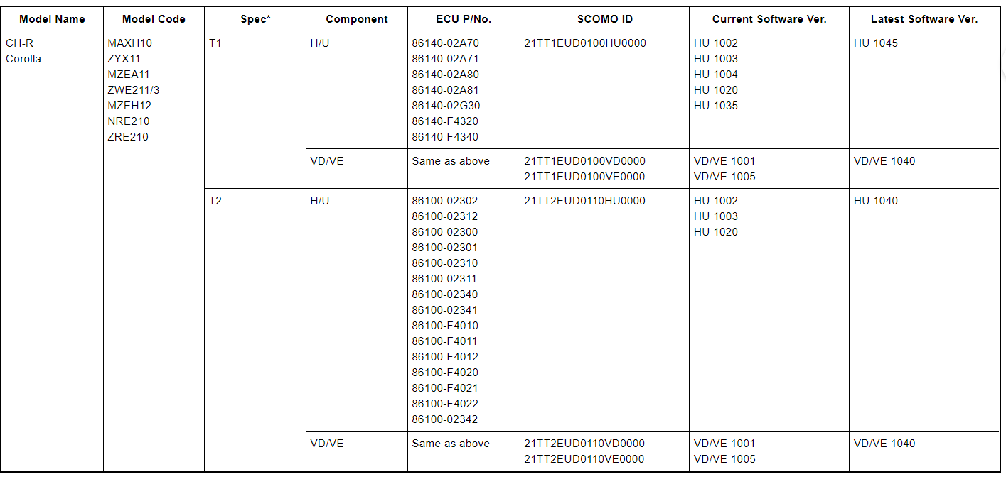

Latest update takes headunit from 1035 to 1045 on T1 headunit and 1020 to 1040 on T2 headunit and fixes:
This Software Update addresses the following phenomena:

11 hours ago, Devon Aygo said:
Latest update takes headunit from 1035 to 1045 and fixes:
My version numbers are different. Updated from 1001 to 1020 in September after numerous Error 110 failures. This month updated from 1020 to 1040. Never had 1035 or 1045. Are there different versions for different models, trim levels or engines?
AFAIK all UK C-HR & Corolla are T2 Spec so would have followed per the chart above
