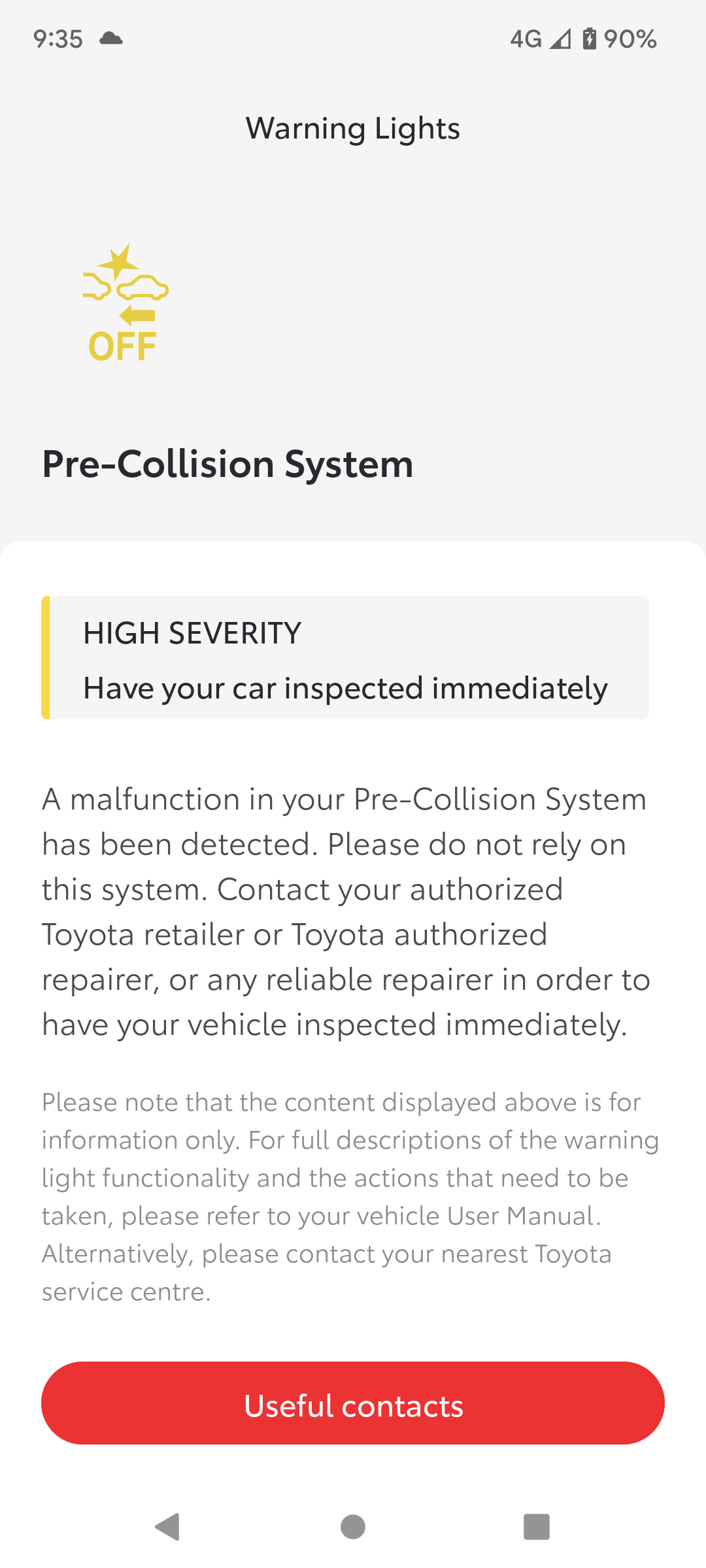

Had this appear on my phone earlier - but this was while the windscreen was being replaced so obviously the camera was unplugged as part of the process.
