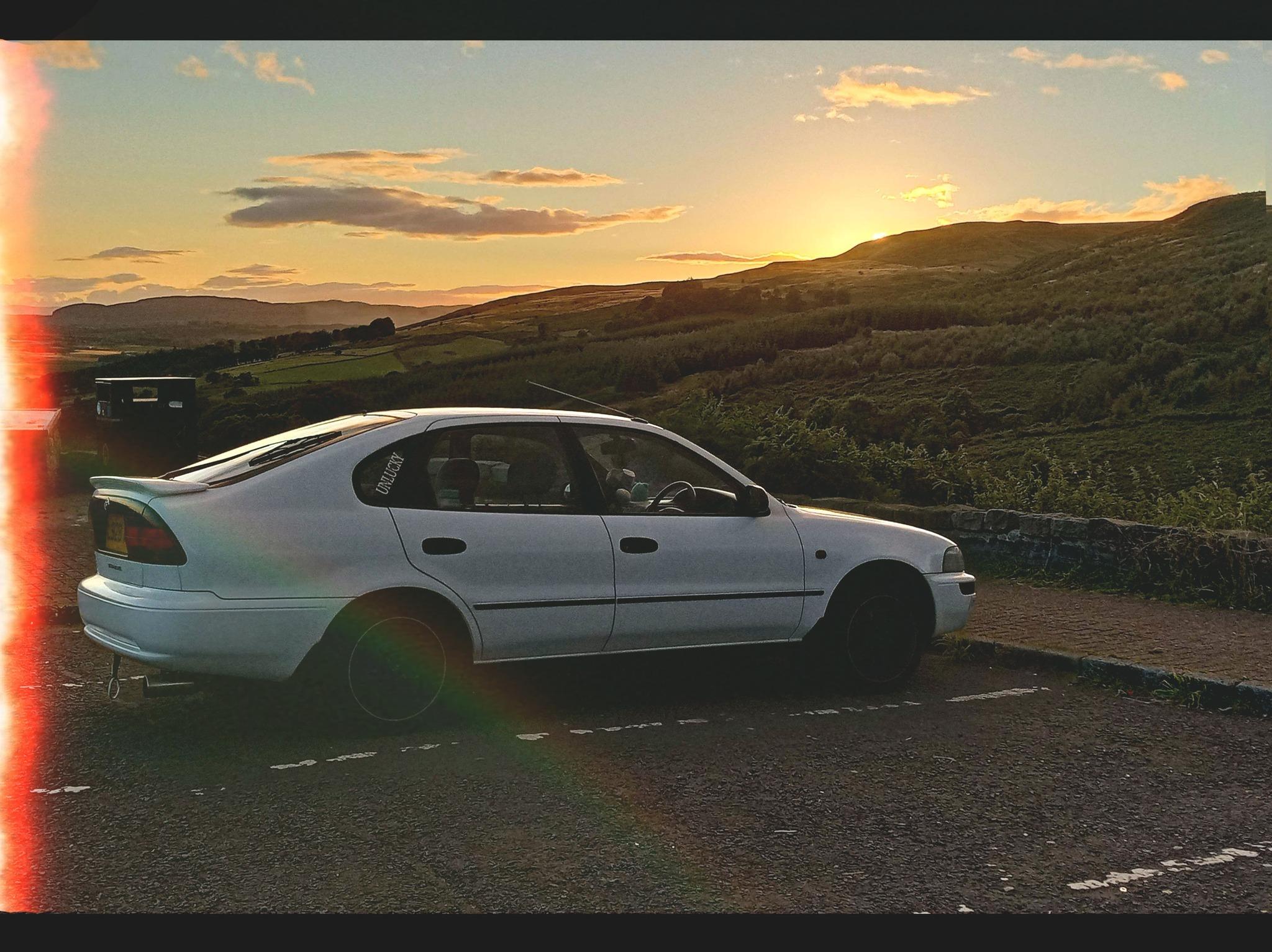

Hi all,
I have a 1993 E10 corolla (1.3L 4EFE) with a clutch pedal that's giving me problems. I've had the car for two years and it's always been pretty hard to shift up and down smoothly without the use of perfect rev matching. But recently the bite point has mostly disappeared in it (and does seem to move around) and it's very very hard to tell where the clutch engages without looking at the tach to see the revs fall/rise at the bite. When pushed the pedal is almost nothing until a good 2-3 inches then it firms up, using the term firm loosely as the pedal is quite soft. It wasn't until I drove one of my friends hondas and noted how easy it was to shift smoothly, and also feel the bite, and that has got me wondering what's up with mine. It's also very hard to pull away in 1st smoothly as said, the bite point changes and it's very hard to feel where it is.
The car has 54k on it, 2 owners from new. The clutch shouldn't need replaced on it with such low mileage is my thought surely? The clutch doesn't slip at all, it struggles a bit getting into reverse but otherwise it shifts and accelerates fine.
There is a leak somewhere, oil is dripping down the middle seam where the engine and bellhousing meet, never been able to find exactly the cause, but more than likely is a main seal and not related to this issue. I've changed the gearbox oil about 1k miles ago. Is it possible it simply just needs new clutch fluid/flush/bleed to fix this? Hoping it's not going to be anything too serious.
Thanks all
