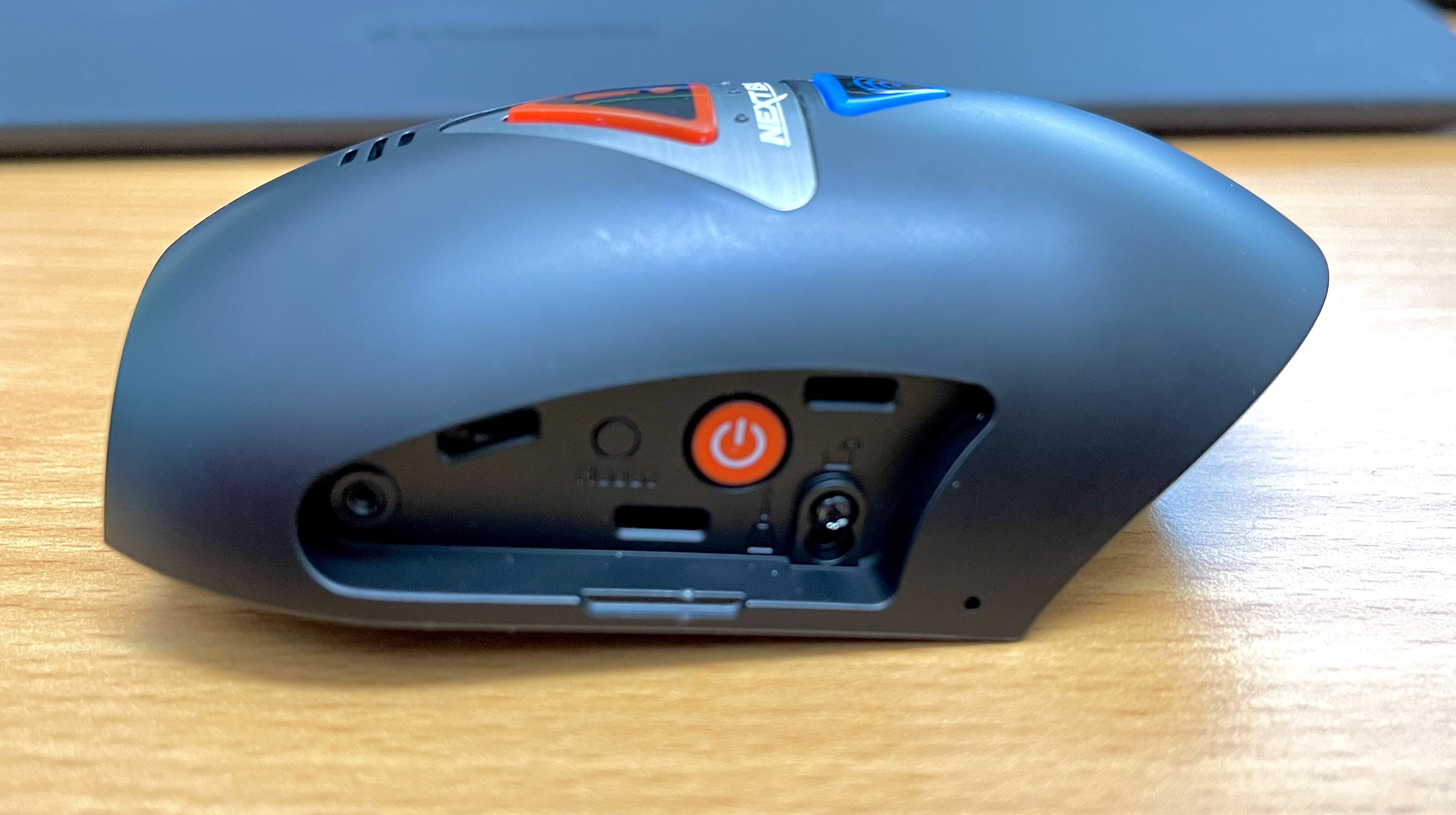

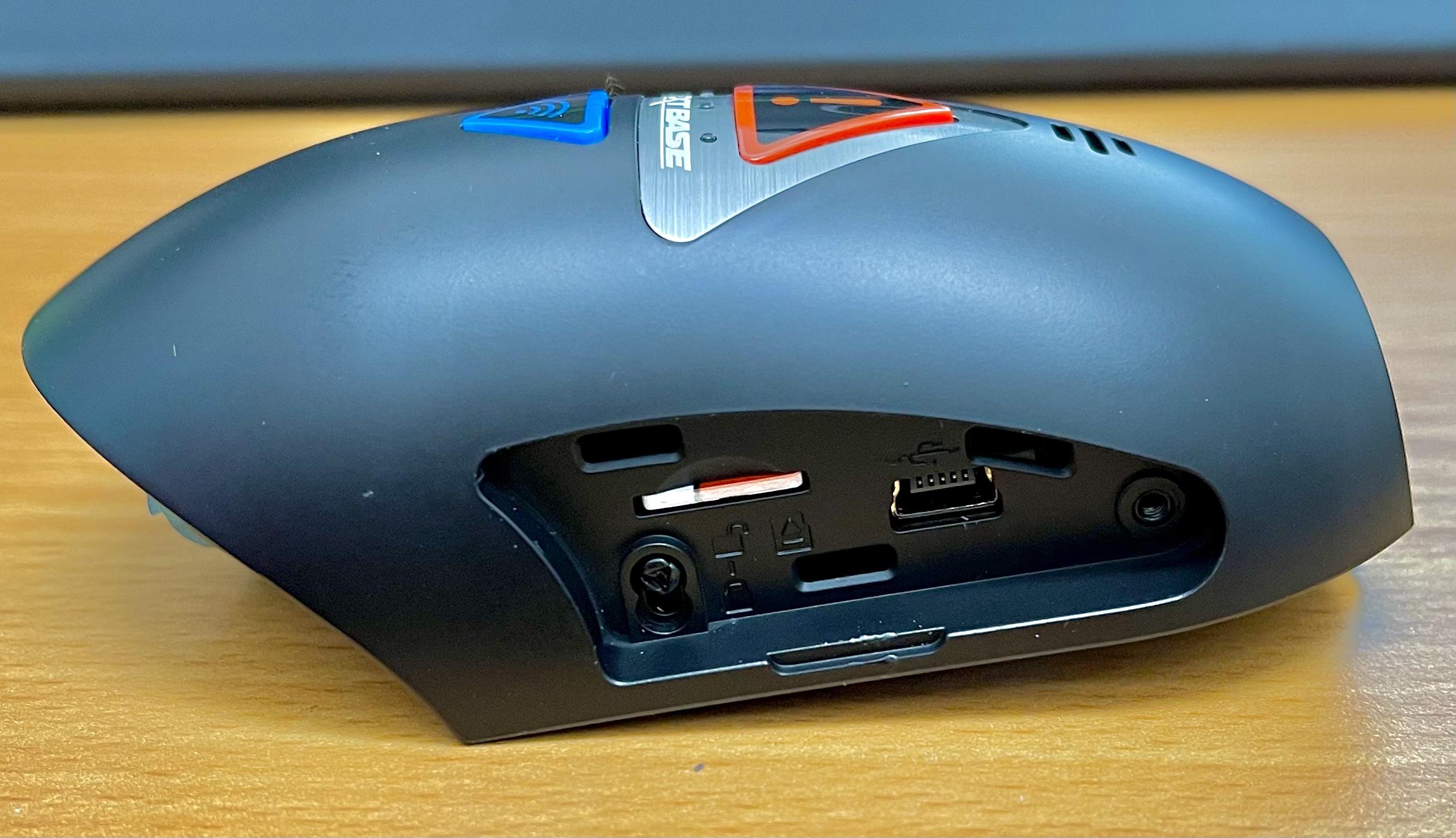

SD card in, and no LED lights. Tried powering both using the mount (had spare wire from my current dashcam) and also plugging in USB port at the side of the camera (using another USB cable from PC) but it's not turning on.

Nope. I've tested with various mini usb cables but it doesn't seem to be powering up.
Tried plugging into the base and also directly into the side of the cam.

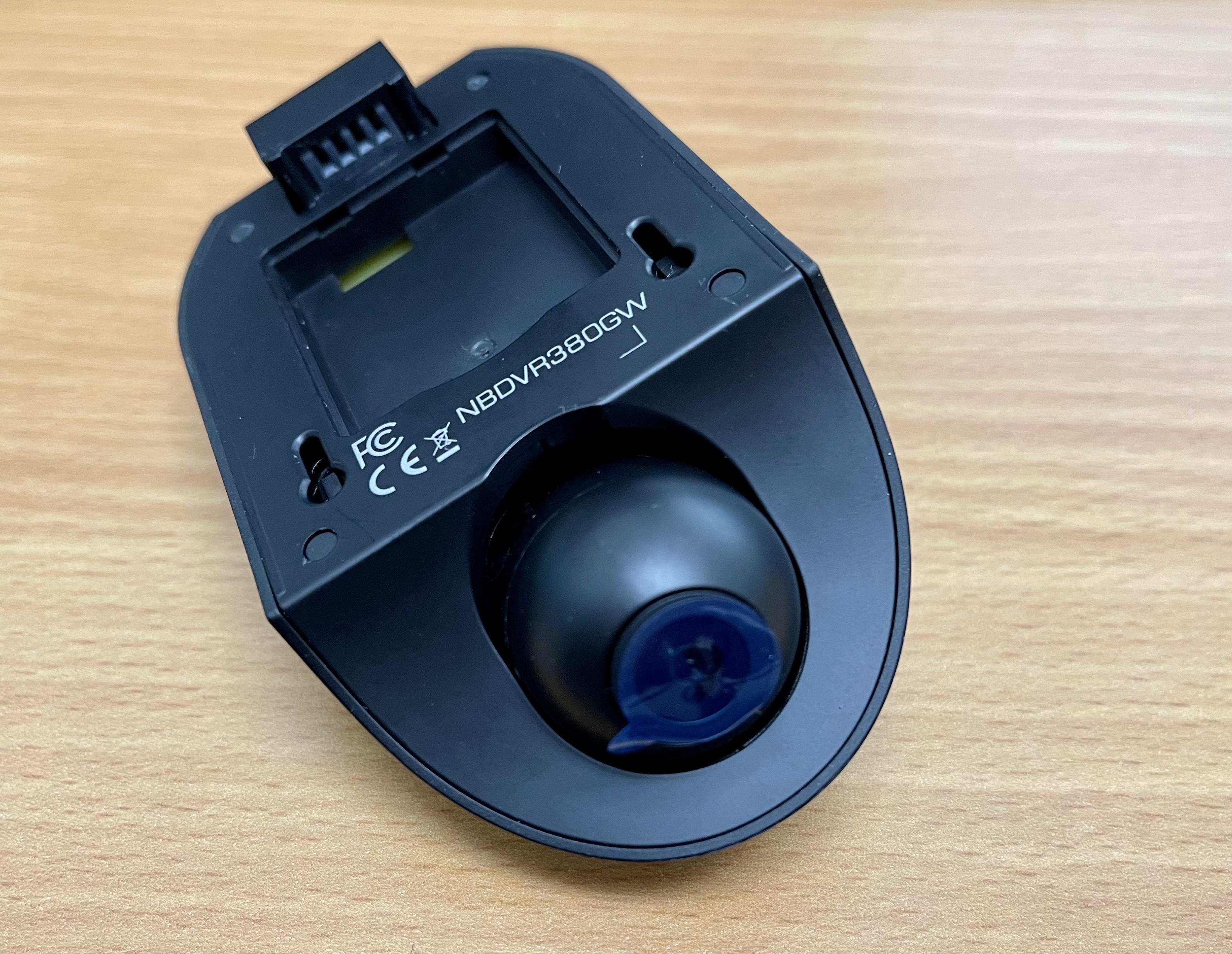

I don't think this is a dummy, perhaps a faulty unit swapped over. It's definitely new though, no scratches and the lens protection film is sitll on!
22 minutes ago, flash22 said:
It may be a dummy unit with a blank PCB as it doesn't have the battery terminals
edit. It's a dummy, the PCB is the wrong colour, plus it's missing a serial number
https://fccid.io/2AOT9-NBDVR380GW/Internal-Photos/Internal-Photos-3-4030279
IMG_20220721_182517_5.jpg.25ac9a9cac3eb6
Wow, great spot cheers! I must say this is a very realistic looking dummy. When I slot the SD card in it has the spring loaded action you'd expect.
It may have the camera in the ball and a blank pcb(s) that mounts the buttons and bits but the casing and buttons are the same as the real thing
