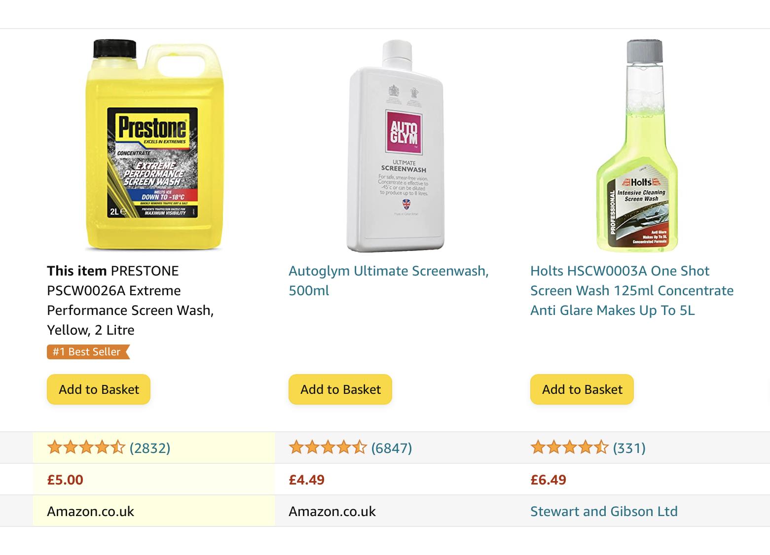

Many of these ready mixed up to -15C° failed this time around., especially to the car owners that drive outside towns and where temperatures went down to -10C° . When extremely cold like it was a super concentrated screen wash can only eventually help. I have this one and is very good, didn’t mixed properly this time and got myself little trouble but found way to sorted out. PRESTONE PSCW0026A Extreme Performance Screen Wash, Yellow, 2 Litre https://amzn.eu/d/02ZtsIz
Also other concentrate that been using and can confirm they are good according to the season. 👍

Think you must have had the last available as is now Out of Stock, unfortunately.

Oops, my order was made a year ago. I did checked other places that sells Preston screen wash and everywhere is out of stock. Tesco, wilko and Asda can have in store eventually, worth checking when do weekly shopping. 👍
Amazon when states dispatch 1-4 weeks or 1 to 2 months, they often deliver within a week but display that to reduce the order numbers so can fulfil their all their orders. Don’t be shy to order and wait, if not delivered on time you can always cancel. This is applying for all products and particularly technology Apple products. 😉👍
