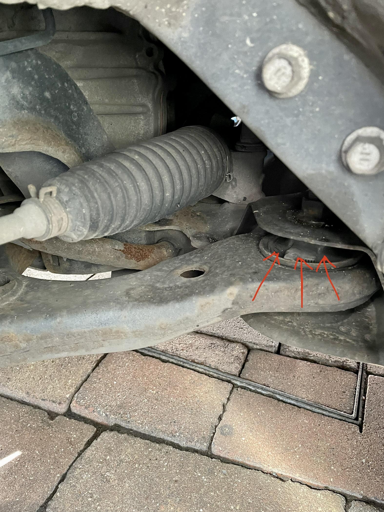

Hi everyone,
I’m new on this forum. I wish to pick your brains.

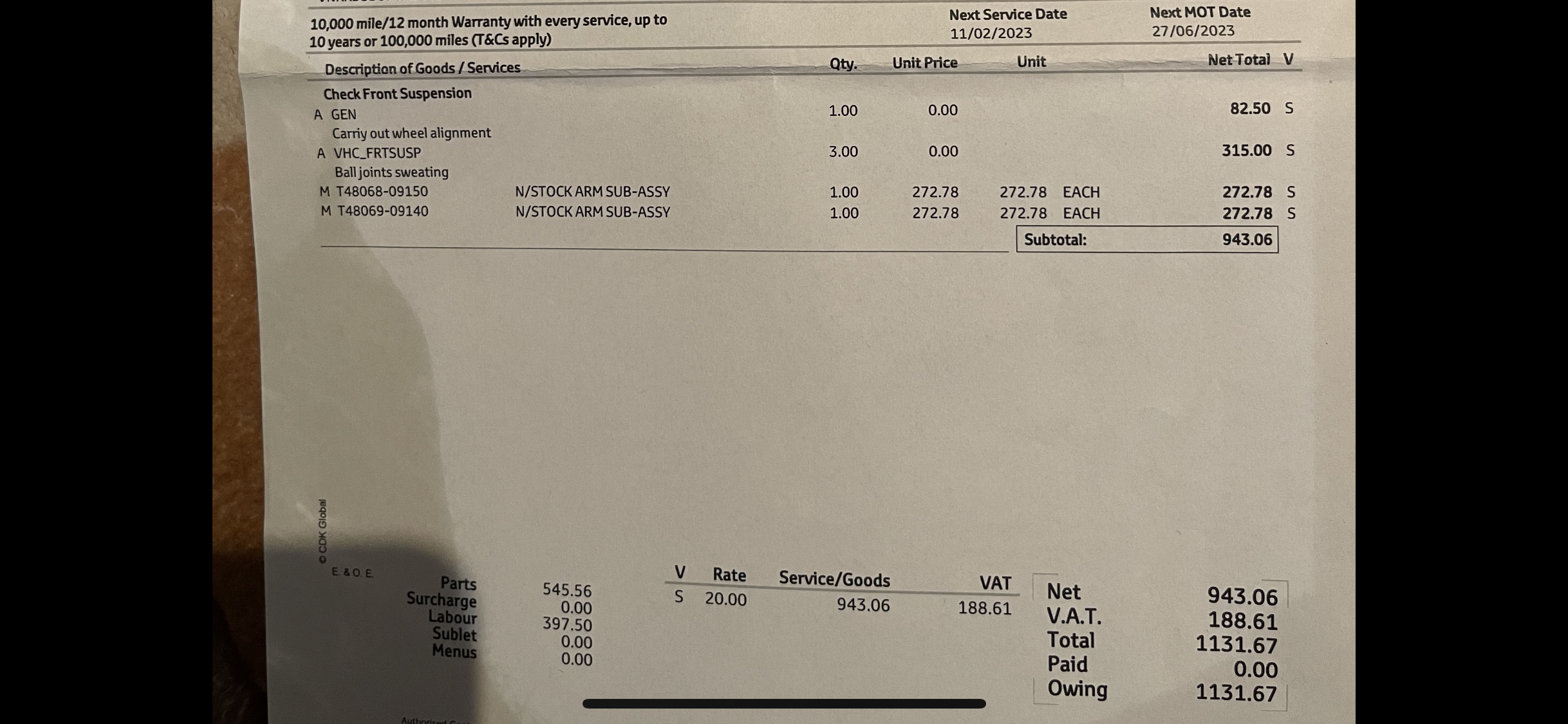

My 2017 Yaris Icon Tech (80,500 miles) is making crunching noises whenever I go over an uneven part of the road and humps. My local Toyota  dealer in Watford said, “The front ball joints are sweating”. The repair bill is £1131.67.
Shouldn’t this be covered under warranty given that every service from new (9 services) have been carried out by them? They’re saying it’s wear & tear.

The rubber can weep some grease, more than likely road grime, if the rubber is split or there is wear in the joint it will fail it's MOT, i have seen it where dealers have sprayed WD40 on things to make them look worse

If the rubber is only a bit wet from lube or road grime just ignore it, this is typical and not an issue at all. Ball joint fail if there is a play in it or very bad grinding noise when turning the steering wheel. When going over bumps squeaky noises comes from suspension arm bushes and those also doesn’t need change but few sprays of silicone lubricant. Job done and no need or repairs. Toyota cars can make their ball joints lube wet outside as soon as only few years old and 20-30k miles, this doesn’t mean failure or anything to be worry about. They will last another 000 000 miles easily if car used outside London, you are inside but even so still they might be perfectly fine.
You can spray some silicone spray on these and see if noises disappear.
  • Like 6

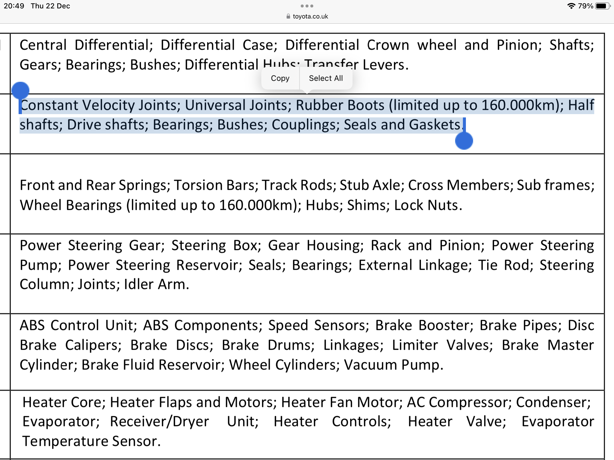

Tell them to gubber off.  It is covered.  If they don’t concede, phone Toyota Customer Services.
https://www.toyota.co.uk/content/dam/toyota/nmsc/united-kingdom/owners/warranty/toyota-warranty/toyota-warranty-ts-and-cs-june-2022.pdf
If above is the case, then the OP should still contact Toyota GB to make a complain and trading standards. If more people do it when this happens then dealers will likely play by the books. What they are doing is fraud.

You are quoting Driveline not Suspension, Driveline covers driveshafts, prop shafts, etc. The warranty also specifically excludes "any parts not mentioned explicitly in these terms" Ball joints are not explicitly mentioned and not covered.
The OP mentions a "Sweating Ball joint" sweating is not a manufacturing defect but a symptom of wear & tare most likely to the rubber boot on the ball joint "rubber parts" are specifically mentioned as excluded and on this model Yaris there are 4 ball joints 2 on each front suspension arm 2 on each steering track rod end again neither of these are mentioned parts so not covered under the service activated warranty.

What you are saying is Lee, that by changing the name from rubber boots to rubber boots sweating, a term that is nonsensical that the most likely components to fail in the suspension are excluded in the warranty.  Not your doing I know but it is rather pathetic.   Everything on the car is subject to wear but I would have hoped that ball joints could do 100k without failure.  That would send me to a third party garage and copy parts, there’s nothing to lose (I’d do them myself but not everyone can).

I’m normally quite matter of fact on such things but I’m 100% with you on this.  Rubber boots are covered on driveline but to avoid paying warranty they’ve invented a term to cater for them not being covered.  Maybe if the rubber boots didn’t “sweat” the flippin ball joints wouldn’t fail.  There are some disappointing things coming out of Toyota UK and whoever came up with that policy is a double agent for Kia.  Man up Toyota, change his lower arms like the world’s supposedly number one manufacturer should if they had no shame and where does £1100 come from anyway?  I’d love to sit with the CEO for a little chat.

£1100 seems crazily high!

It appears they are wanting to replace the entire suspension arm - Is that really not covered??
What would cause the crunching sounds on an uneven road or on humps?
Shall I contact Toyota GB and say the suspension arms need to be replaced under warranty?
