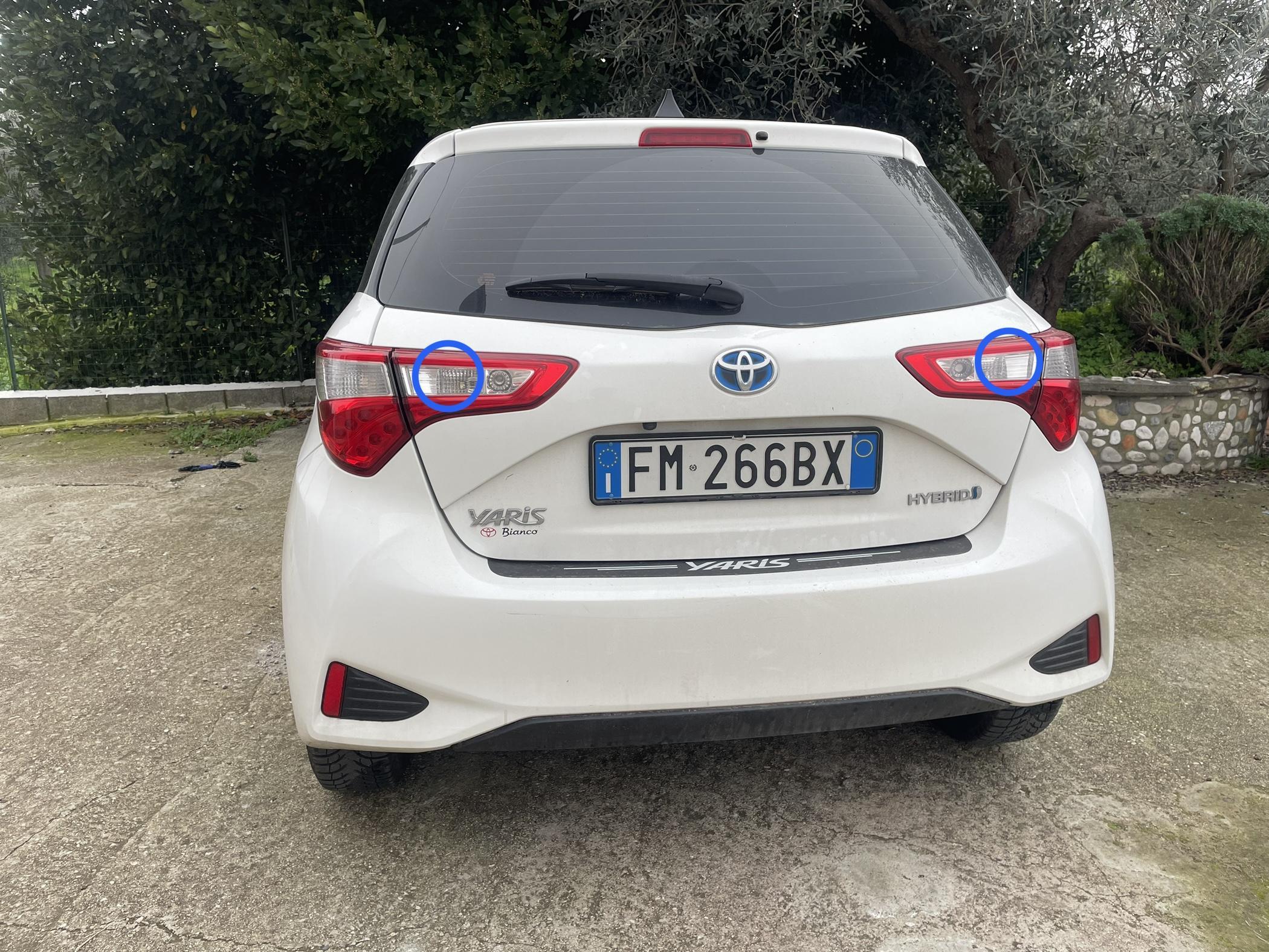

The reverse light on the Mk 3 2nd facelift 2017 are led as it's in the tailgate you could add another LED to the other side like Vins did (base spec cars got a bulb)
towards the bottom of the 1st page
towards the bottom of the 3rd page
Reverse lights are to be seen by, Not seeing with - upgrading the number plate lights will help with the camera
This is not a reverse light, but a rear fog led light
the reverse light is double on the rear, a simple bulb that can be upgraded with a led one (t10 if I'm right)
My mistake, you could use the location as a secondary reverse light as it's in a clear housing tho
My 3rd gen restyle has two reverse light, upgraded the bulbs with two LEDs with lens on the front..really great illumination
