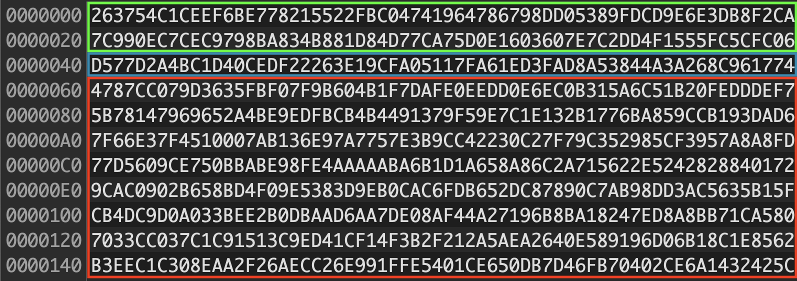

I've been working on making modifications to the update files, so far I've been able to make changes to the files and build an swdl.iso, the updates are aknowledged, pass validation and work up until the unit reboots to actually install the update.
1944406829_Screenshot2023-01-06at11_00_54.thumb.png.8126a69453ded80e3ec8665b306e2281.png
This is from an official update.
The part in green is verified by the following commands:
inject -e -i /fs/usb0/swdl.iso -f /tmp/isodigest.sha256 -o 0 -s 64
isodigest -df /tmp/iso.digest /fs/usb0/swdl.iso
openssl dgst -sha256 -verify /etc/keys/swdl.pub -signature /tmp/isodigest.sha256 /tmp/iso.digest
If successful, you will get "Verified OK"; otherwise, you will get "Verification Failure."
The part in blue has to match the output created by hashFile:
hashFile sha256 /fs/usb0/swdl.iso /tmp/tmp.digest 32768
The part below is where the update starts to fail.
The blue and red parts are base64 encoded and passed to com.harman.service.samSecurity as json in the following format:
  "signType": "appUpdate",
  "signature": "base64 encoded value"
I can't seem to figure out how the part in red is generated, as the verification step then fails when verifyISO is run after the unit is reset, right before the updates are actually installed.
If anyone can help it would be much appreciated.

I'm still trying to figure out how the parts in red are generated.
