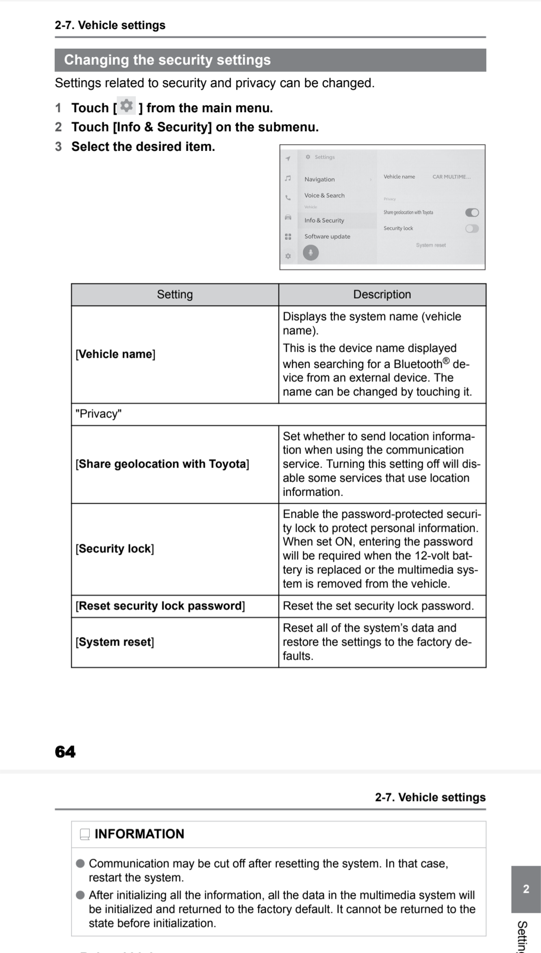

Have you tried a factory reset on the Smart Connect screen - that should in theory remove all user data.
I've never tried it on a Toyota but it's worked in previous vehicles with user profiles linked to smart phones.
Hi. Thanks for the reply. Had seen that in the settings but hadn't  considered it. Will try that option. Thanks.
Just tried this, the system reset is ghosted out, suspect as I'm  secondary user it is unavailable. Think probably  only the primary user will be able to do this.
