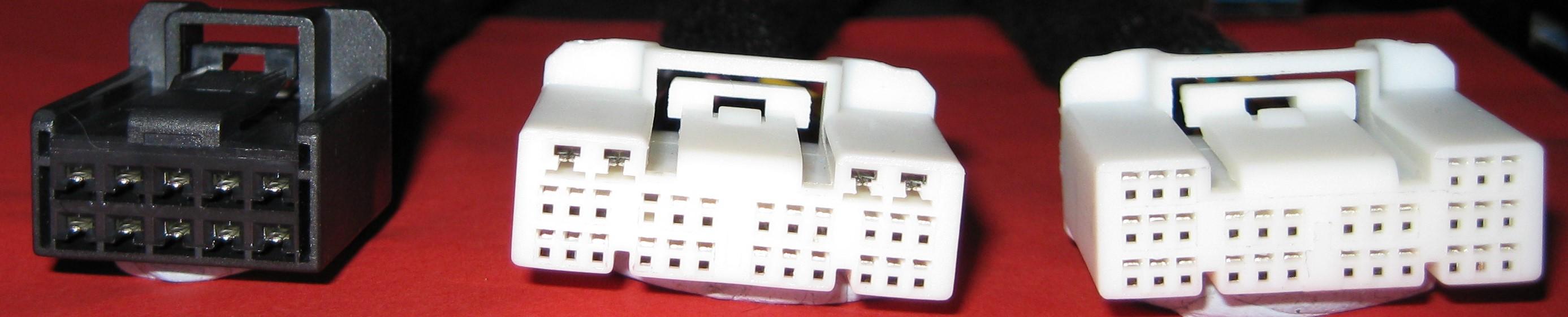

So this is a thing now - working on pinouts and unlisted connections
These are the new Toyota audio connectors 2020 onwards (Mk4 yaris) and 2018 on in various other toyota's
i have only just been able to source connectors/repair harnesses
Pinout information, some provisional at the moment
new gen radio pinouts.pdf

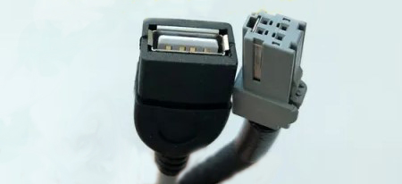

New style USB connectors, I believe these are JAE MX connectors but are unlisted, Female JAE to USB A male (to fit aftermarket HU) are available from the states, JAE to Female USB A, are a mare to find (6-10 week wait from china)
GV (green) and USB (Natural) are JAE MX68 connectors only available as a harness

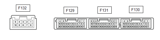

the radio is denso 86140 0d581  , in my car there is no f130 plug i suppose due to i dont have NAV , at the f129  plug, the pinouts it is the same as the pdf ,  but at the f131 the pinout is different for example at the pin 30 i dont have 6 volt line from reverse  but 12volt acc ,  i think that my pin out is the same with this https://www.tavalon.net/617/terminals_of_ecu.html  and with this https://www.tochr.net/437/terminals_of_ecu.html , do u tink that i am correct? do u know where i can find the plug  (g110 / j6) to test it? i ts very dificult to try with the cam and leads to the connector
G110 and J6 are GV (gigabit video) which is a digital connection only
The PDF above is for the MK4 Yaris
here is the pinout from the Yaris EWD
F131
for an aftermarket camera, all you need is pins 28 and 29 for video in (F131), as you get your camera power from the rear light, check for 12v when in reverse on F129 pin 29
you can buy a plug and play lead as above (select C30) https://a.aliexpress.com/_EyFkKwl
thanks for your reply again , on pin 28 & 29 i already have a cable there , possible is going on the foot rest , i have eject tool for depin ,so i depin it and i will plug another that already have from another adapter!
yes, the wiring will be in the loom down to the passenger footwell (LHD)
