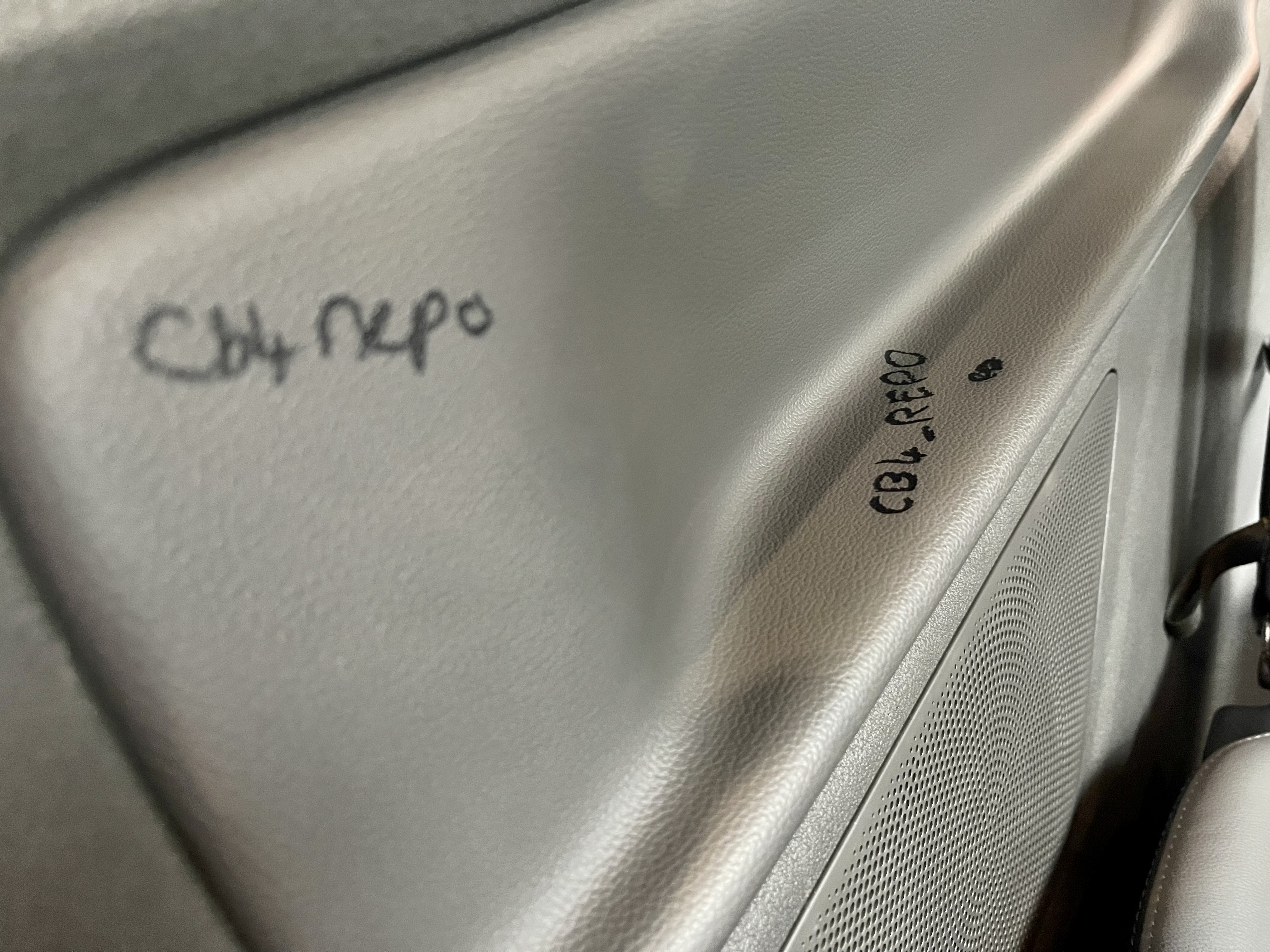

I’m trying to clean these marker writings , but none of my cleaning solutions work …. Koch Chemie PolStar 1:10 and GS 1:10 didn’t do the job. Any suggestions ?
Dab a little rubbing alcohol on a small section leave it for 10 minutes and wipe it off with a dry cloth. Make sure you try a small bit first the you should be fine to do the rest. Hope this helps.👍
If you get stuck, you can colour over it with a dry erase marker, and then clean it off.

I will give it a try …

This is a great trick; Used it many times where people have used permanent markers on an interactive whiteboard and nothing else would get it off... :rolleyes1:

Isopropyl Alcohol aka IPA , nail varnish remover 50:50 with water but be very careful and rince it off with hot soapy water asap
did you ground them for a week or a month ?
PS. after a quick google, CB4_repo (cb4_redo) looks like a TikTok user

I think the dry erase and permanent use the same solvents, just different dyes. So the permanent will soften up again.
Not heard of the dry marker method but the old rubbing alcohol application is also a good solution.

Used some WD40 today and also cotton swab dipped in AutoGlym Tar , but nothing.
next will try some IPA

Not my kids 🙃
