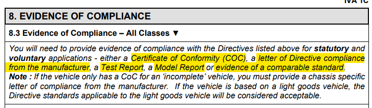

I need a model report for 2022 corolla and yaris Cross.
Vosa have said without 1 of the highlighted I am unable to register my cars here.
Many Thanks

Hi
Iv spent 5 months doing this with dvla now vosa.
Picture attached.
Is the CoC for the IVA i take it

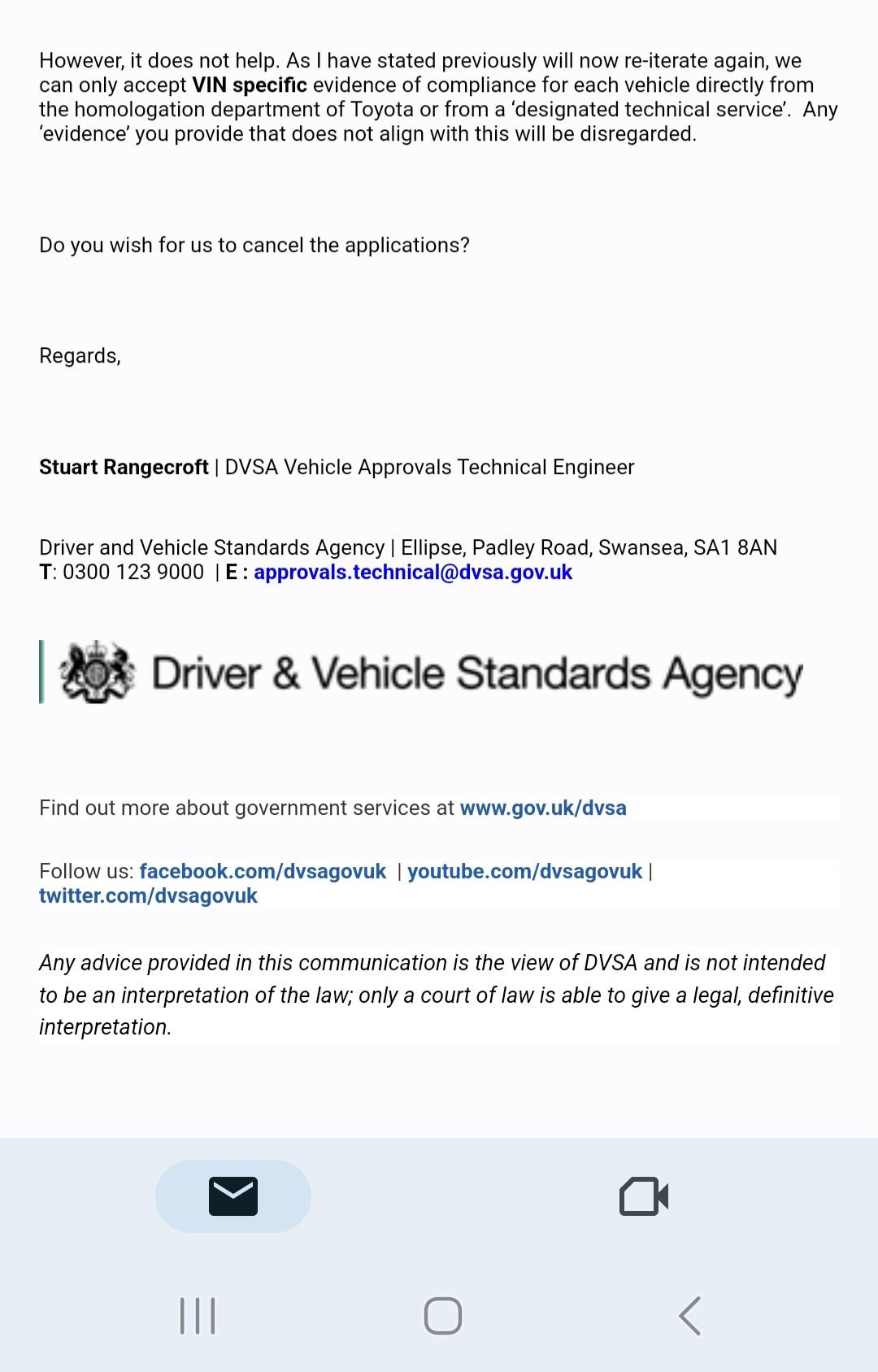

Hi
Iv already been down that route
These are the prices they quoted.
Noise 550
Emissions 2500
Brakes 15k
Never mind the emissions scandals they have been part of and they know full well all my vehicles are euro 6. Yet they want vin specific.

Hi
Mine are from Singapore and the Japanese can only do this whilst they are still in Japan.
Only this highlighted in Yellow is what they want.
Have you any details how to contact them in Japan?
Thanks

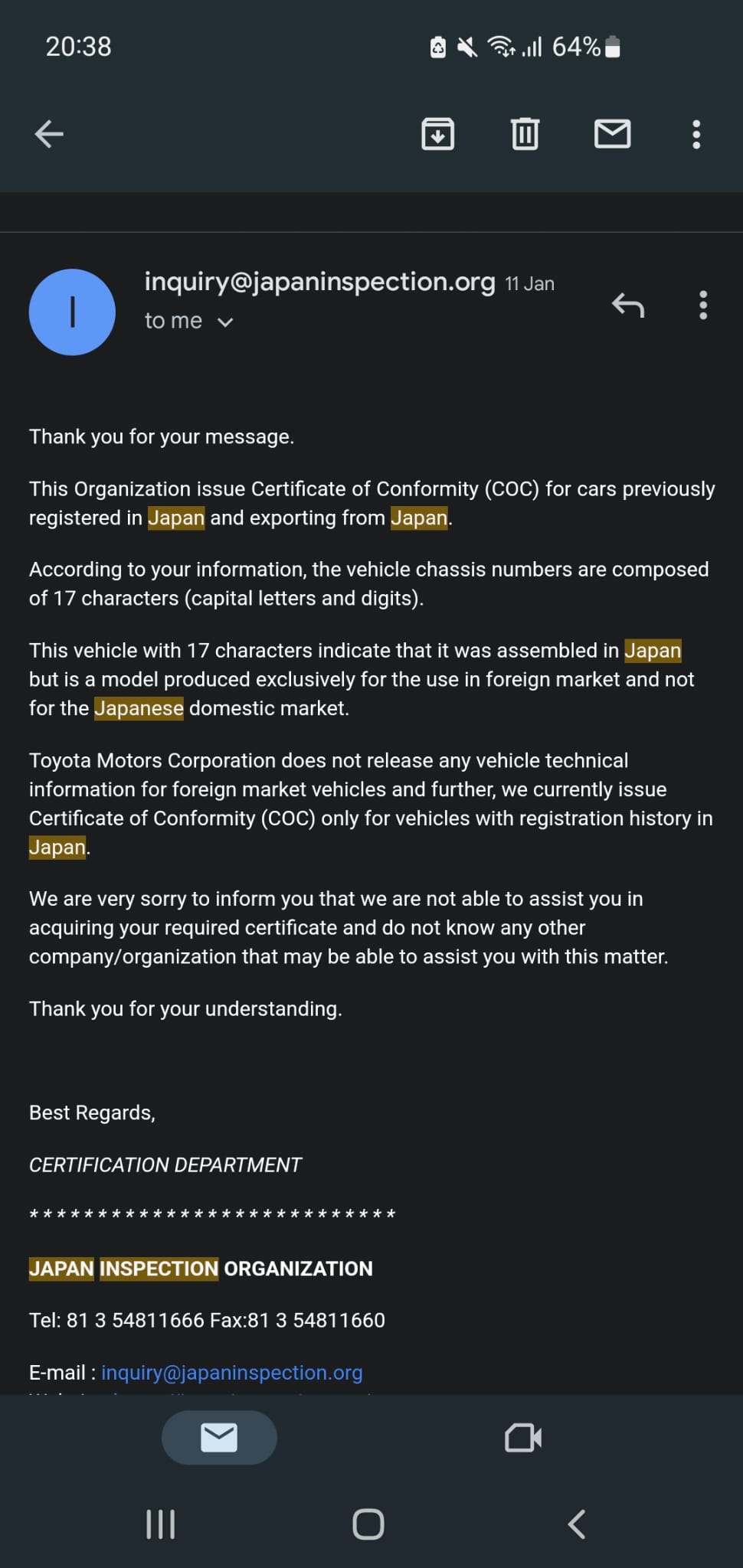

Hi
Iv tried this route aswell
Coc is for EU vehicles
This company couldn't help.
Thanks

Iv tried buddy everything for 5 months. Yes they said they want the cars with them back there to do a letter.
There exact words
As advised letters of compliance can only be issued with a vehicle inspection to confirm if modified. In this instance as the vehicles have left, we are unable to assist with your request.
Thanks

This is what they will accept.
Some are in excess of around 10k each vehicle.
It's Dvsa not dvla and they won't do comparable stardards as all 3 cars are very similar to the UK models.
