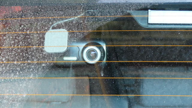

Marlinleg - a few things to think about:  Make sure the rear camera points out through an area swept by the wiper and try to avoid the heated screen wires.  (See pic.)  Also, on unlit streets any car headlights will overwhelm the sensor with the excessive contrast - and you won't be able to record the number plate.

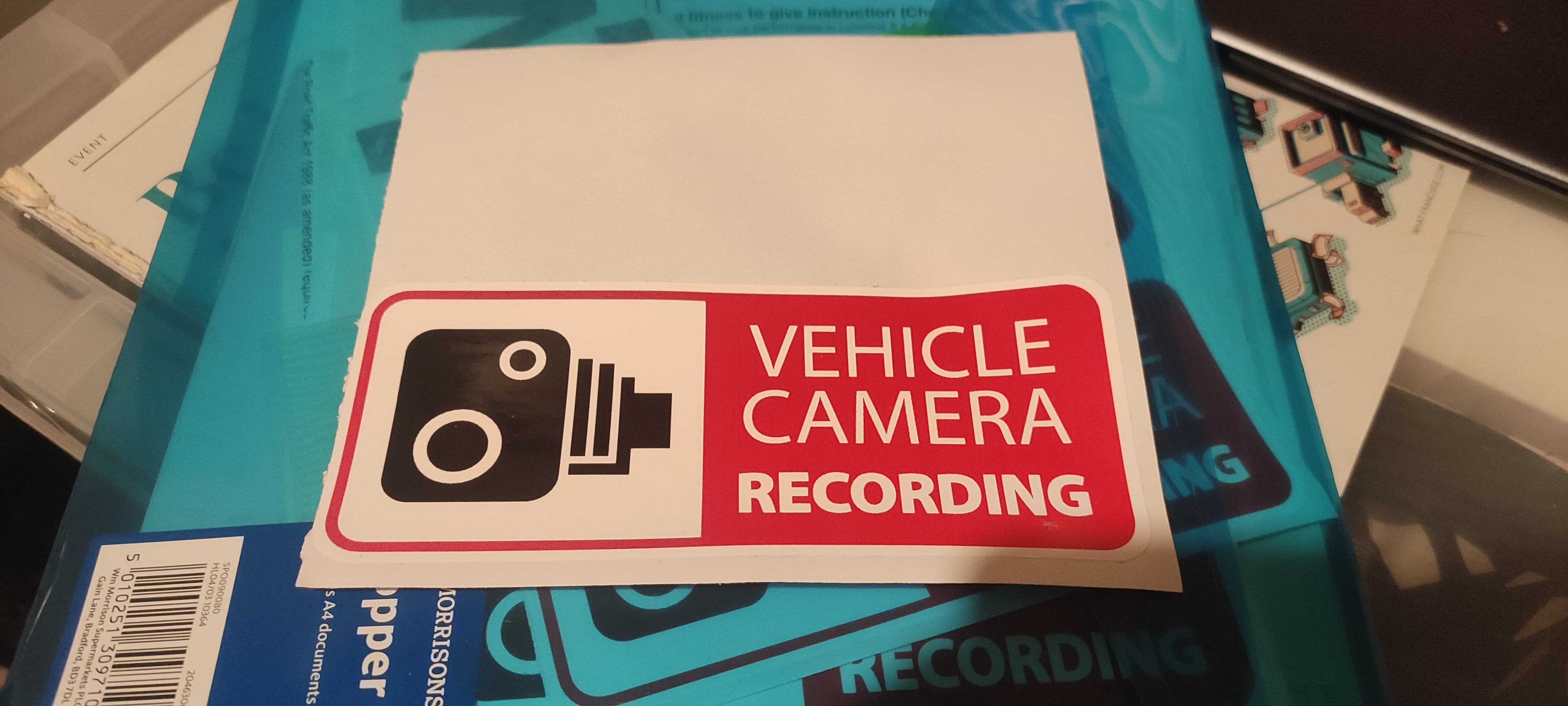

Have this sticker stuck on the rear of the car as am fed up with bad London drivers, it helps a lot, they back off.
Stuck the rear cam to the roof of the boot door - metal part, so not on the heated lines.

Yes, I have a similar notice stuck at the bottom of the rear window glass, on a part where there are no heating elements.
I think it did have an effect initially but nobody seems to be phased by it now and just tailgate anyway.

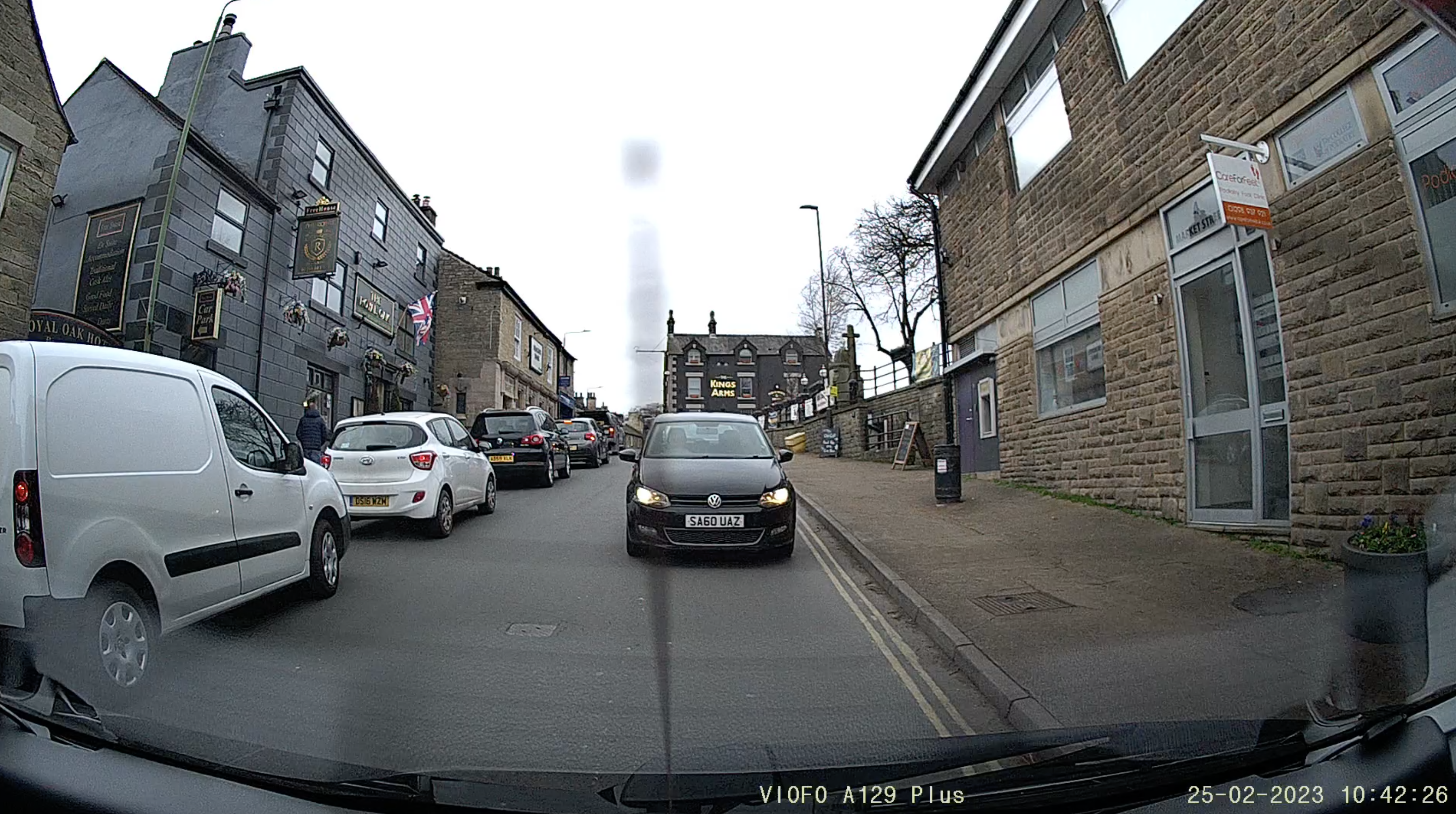

Hi Terry.  My rear cam is dead Centre and high up but within the wiper sweep.  You can see the centre heating element but not intrusive. Someone said dealers drop them to avoid brake light glare and you can see it but it doesn’t seem worse than dropping it.  The dealer fitted a rear cam in a CHR and it’s planted right in the middle - what a mess.  I’ll take some screenshots from the footage as soon as I get chance.

Some front and rear to show the effect of the rear screen heater line and the front to show the field of view.  I’ll get some dark ones after tomorrow night.

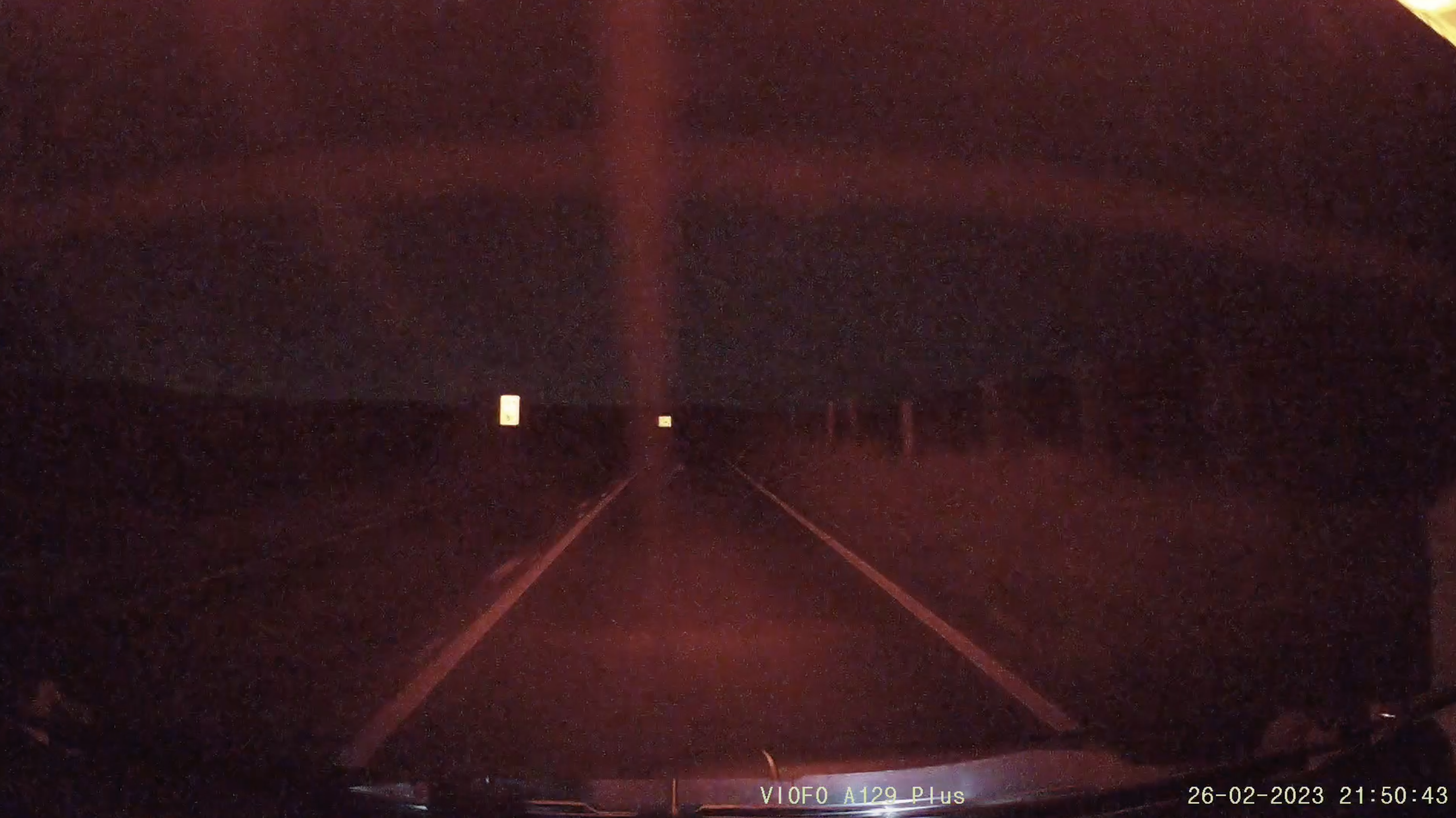

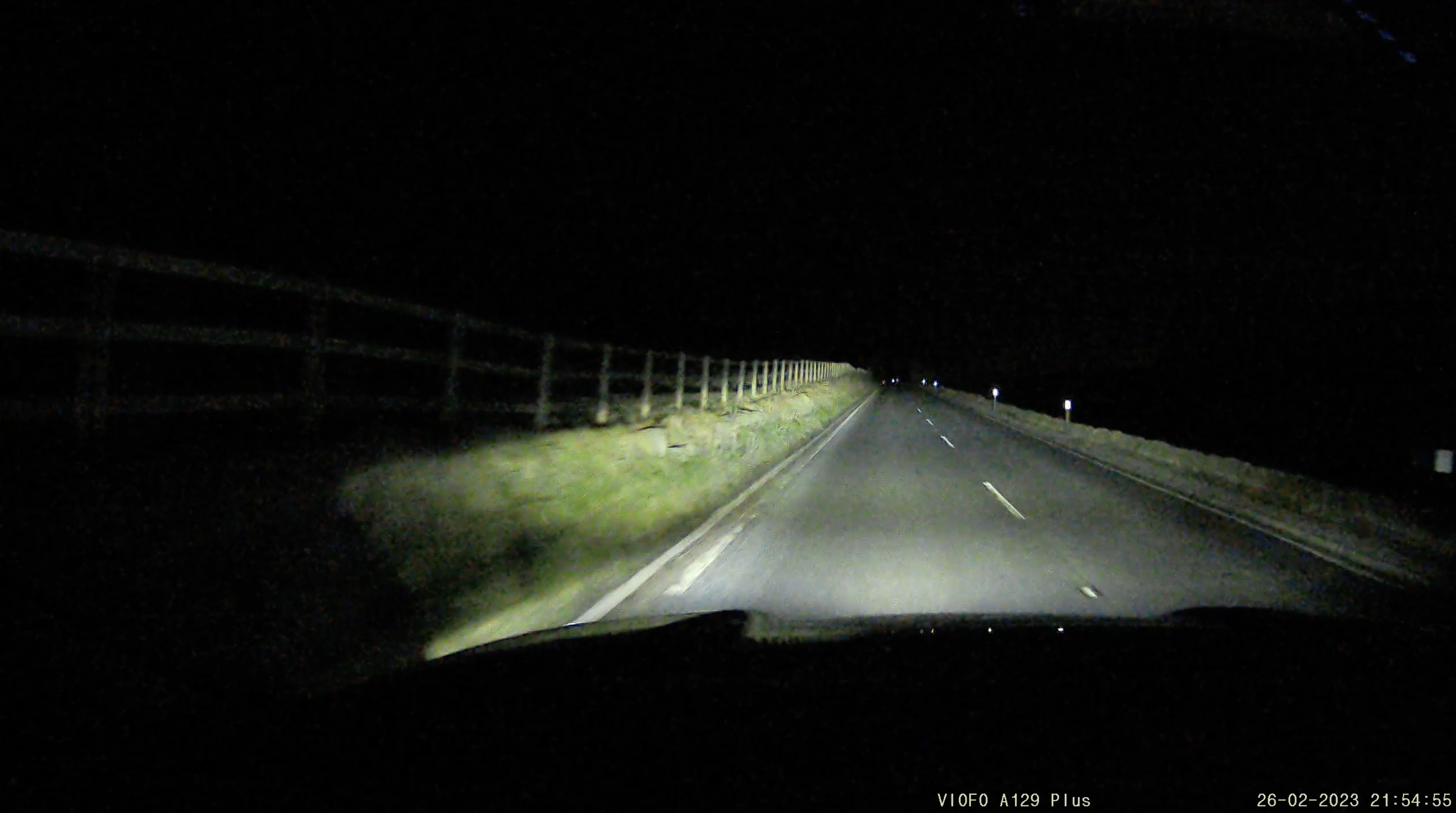

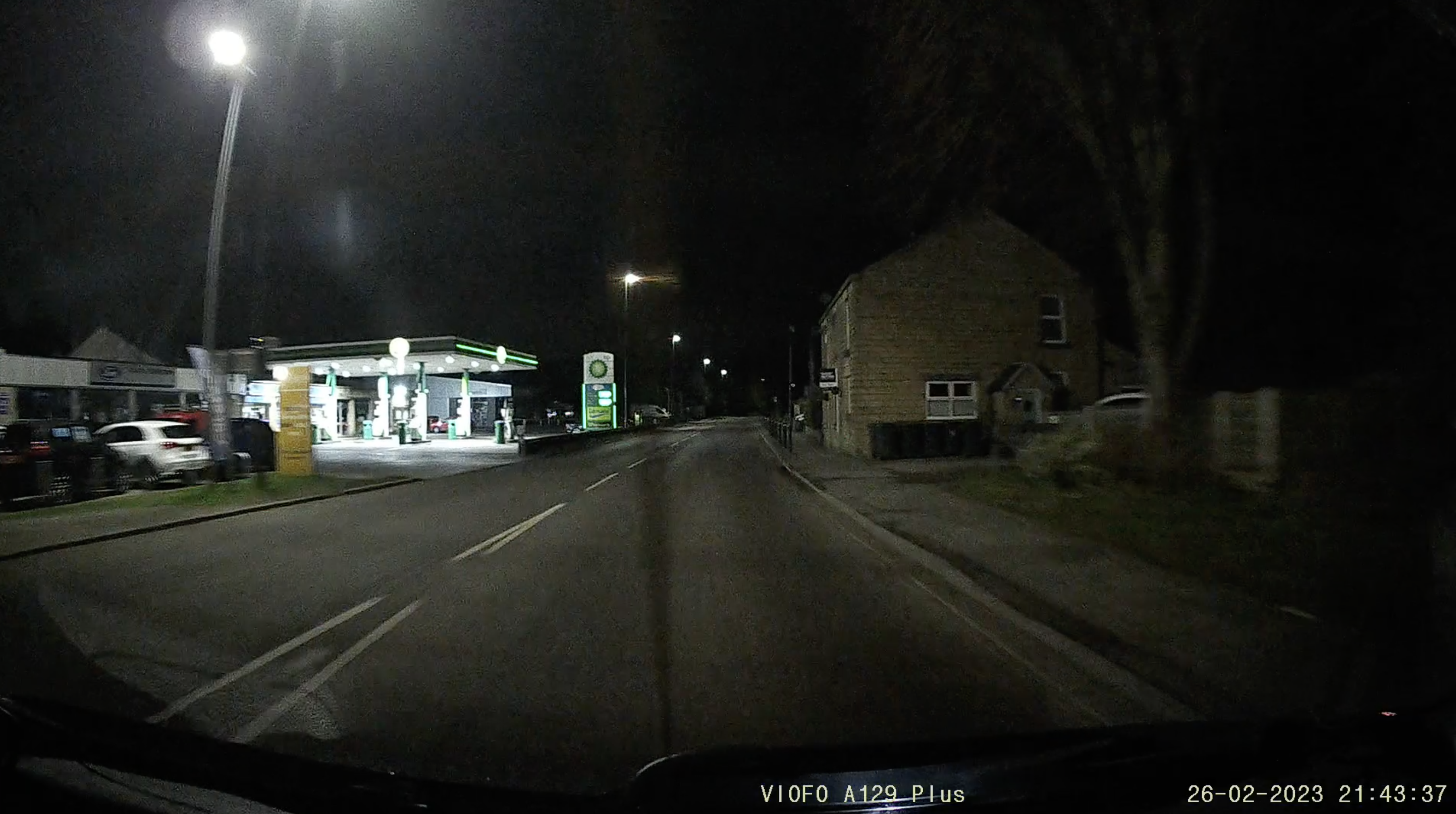

The promised screenshots for A129 at night.  The files show suffix F&R which is useful.  There’s one rear and two from.  One front in town and the other on main beam.  One rear with the brake light on.  Not brilliant for reading number plates.

I like the Viofos too - They have excellent resolution, esp. in the day time when it's bright!
Their only weakness is when it gets darker - Video footage is still very clear, but they don't pick up number plates very well, esp. where there is a significant speed difference, it gets very blurry.
