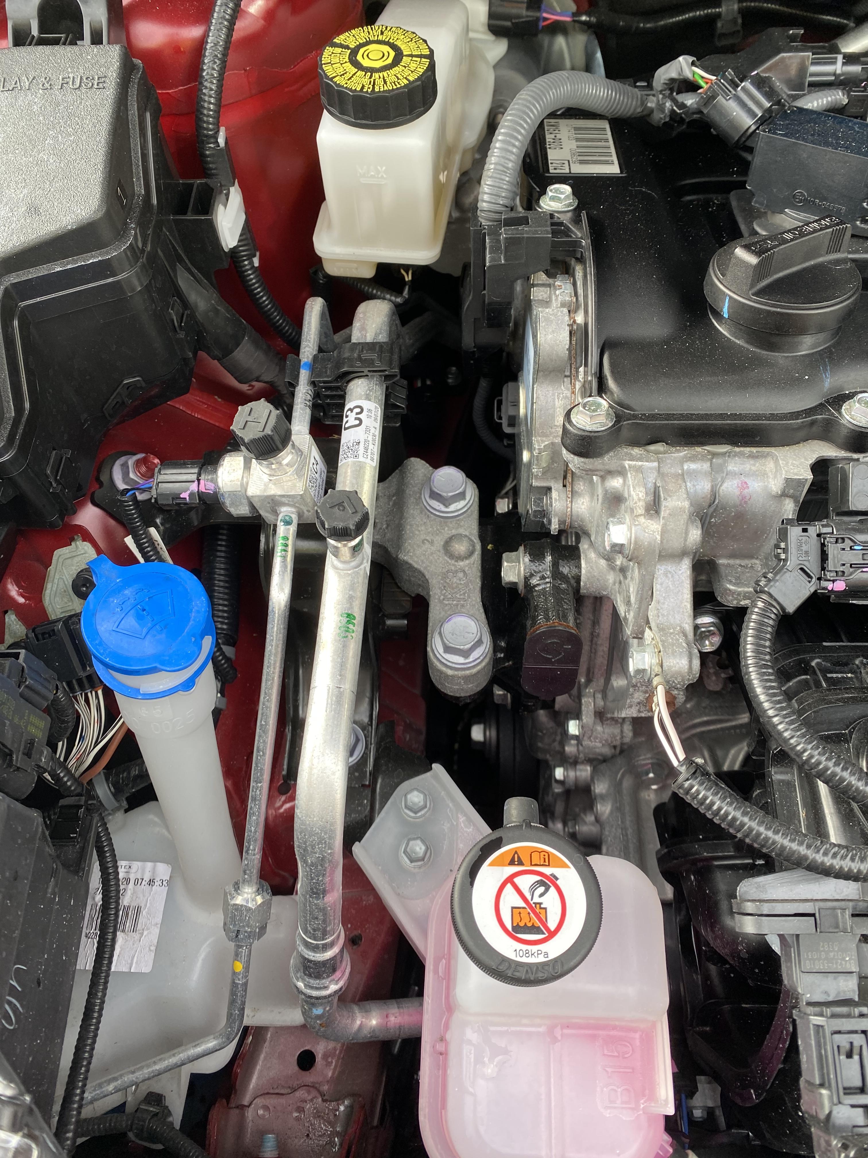

I am a new driver and am not very clear about which caps belong to which fluids. I attached the picture of under bonnet. I just know the blue cap is for windscreen fluid. Would you please advise?
In addition, for Yaris hybrid, is it true not often to refill coolants and oils?
The reservoir with the black cap/yellow writing is brake fluid. The reservoir with the radiator symbol crossed through nearest the washer fluid reservoir is coolant (containing pink fluid).
Do check the coolant and oil levels, but doubt whether you will need to top up either by much, if at all.

Just a note. There are two coolant reservoirs.  The one on the left ( shown in the picture with pink fluid ) contain coolant used to cool the electic components ( electric engines and inverter/converter ) .  There's a second reservoir on the right side ( not shown in the picture ) for ICE coolant.  Unluckily it's not so easy to check the level of the ICE coolant ( it requires a light and some acrobatic contortions 😉

Thank you for both replies. Do we top up brake fluid often? I saw the yellow bottle not quite full. Do I have to buy from Toyota?
Can we top up the pink coolant and ICE coolant with any coolant in any shop or necessarily from Toyota?

Straight answer to the OP - do not touch any of the caps except the blue one, this is for the windscreen wash, check and refill on weekly basis or every two weeks depending how much you use it.
All others if you are not familiar what they are for better leave them alone. Never open the pink tanks or radiator cap immediately after the car was used. And when you checking all fluids levels make sure all are at top mark or between min and max marks including oil level.

I'll add, DO NOT TOUCH THE SMALL BLACK CAPS. They're for the air con and specialist equipment's required.
No.  Its level will drop as the brakes wear and will come back to the top when new brakes are fitted.
If you don't have a leak (which you won't) it will never need to be topped up.

You only need to top up the blue one.  Get some screenwash from the supermarket or Halfords and use it all year round.  If it’s concentrated, dilute it 50:50 with water, if it says ready to use, just put it straight in.  It will help you clear flies and such in the summer and stop you getting into trouble with freezing pipes and blown fuses as many do in the winter. Don’t use anti freeze like my daughter did, that’s not for the screen wash.   All them other reservoirs, leave them alone.  Being a little low doesn’t matter.  Apart from anything else, you can severely scald yourself if you open when hot.  The only one you ever touch is the blue one.

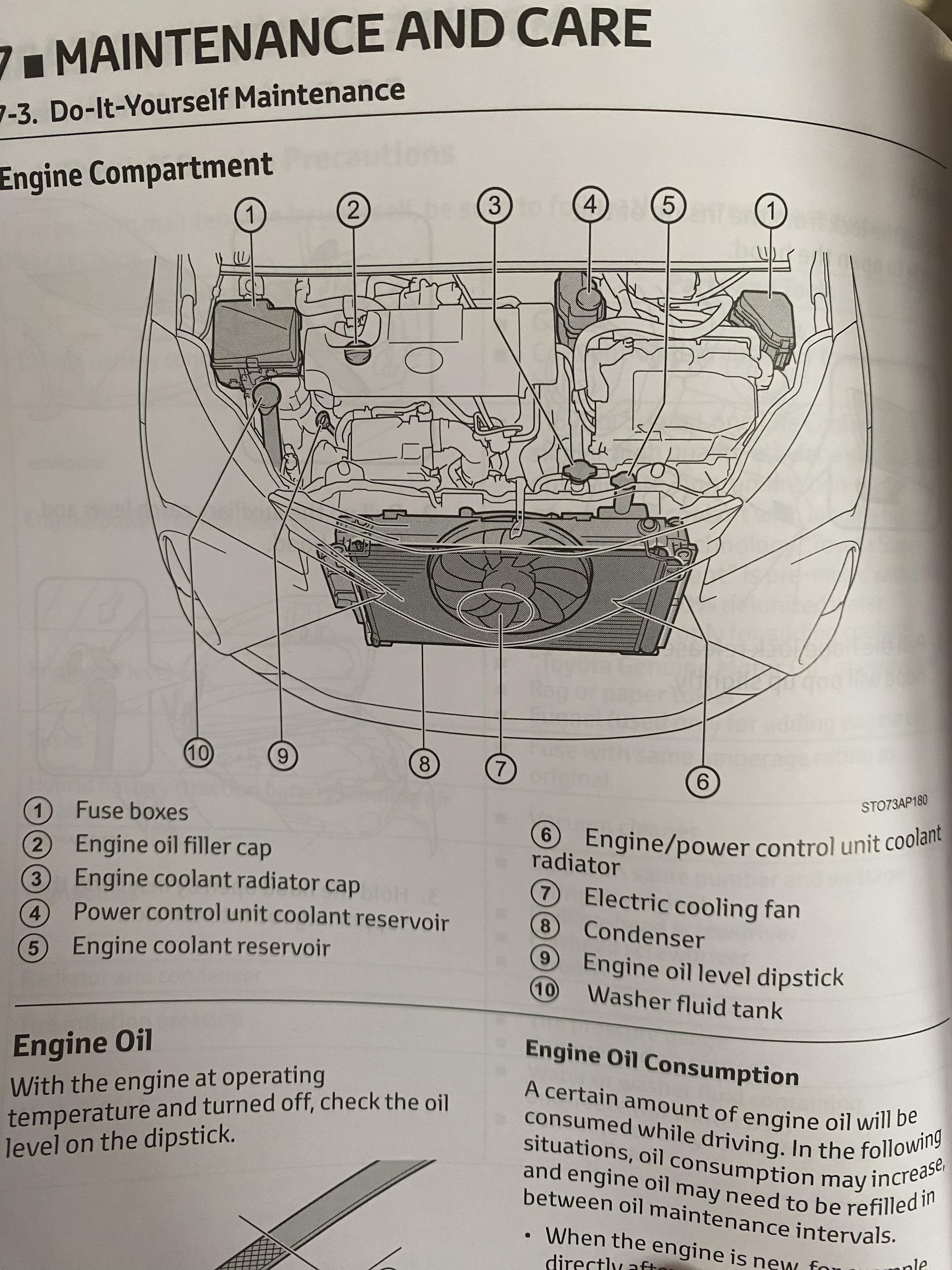

Thank you very much to everyone for explaining that. I did read the manual but being a beginner, I feel a bit confused. I asked the question as the manual picture does not likely look the same as the actual.
