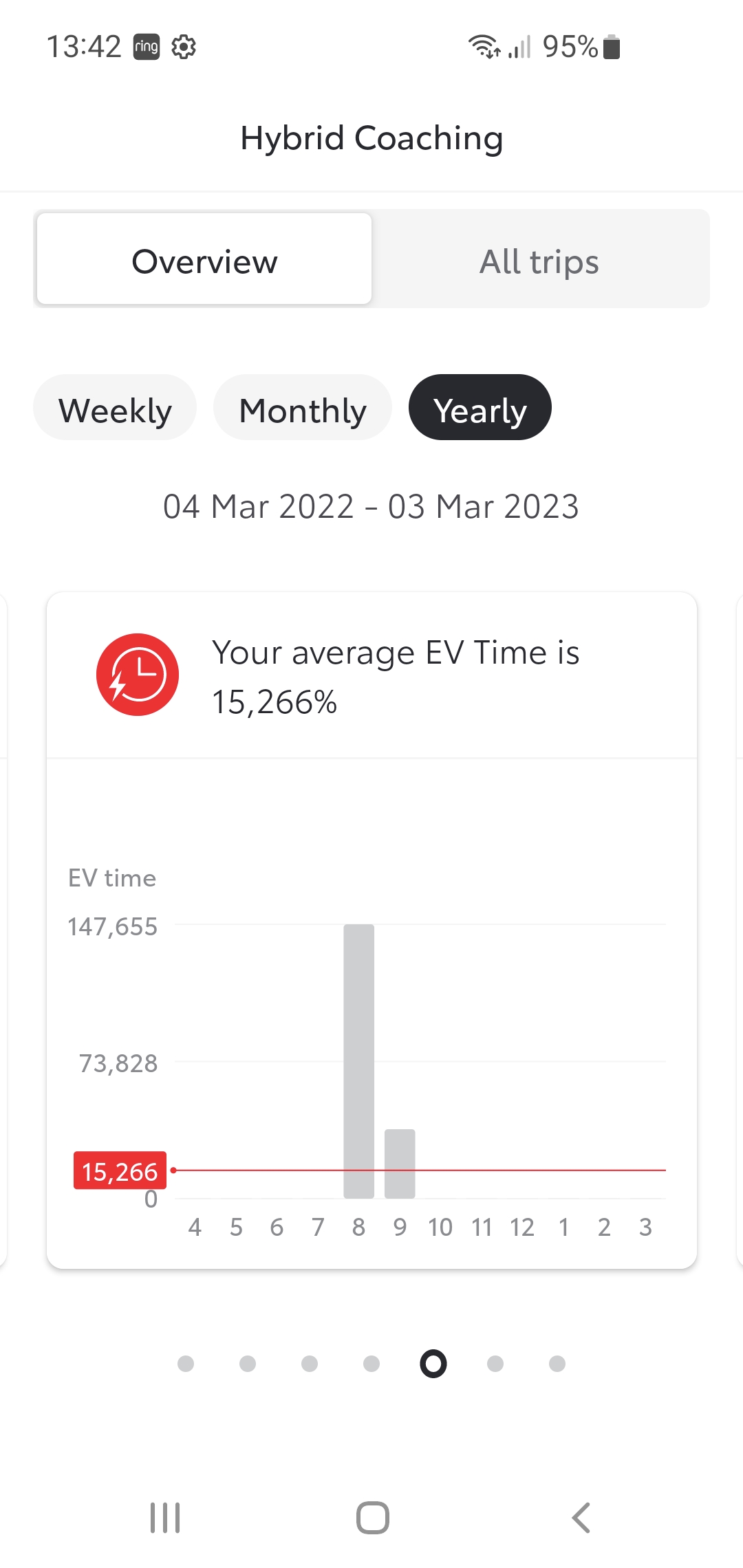

Just looked at my last years stats, this one got me thinking?
(All other screen have data for all the months.)
I think your's is having a melt down Ernie.
My average EV time for the past year is 86%.
