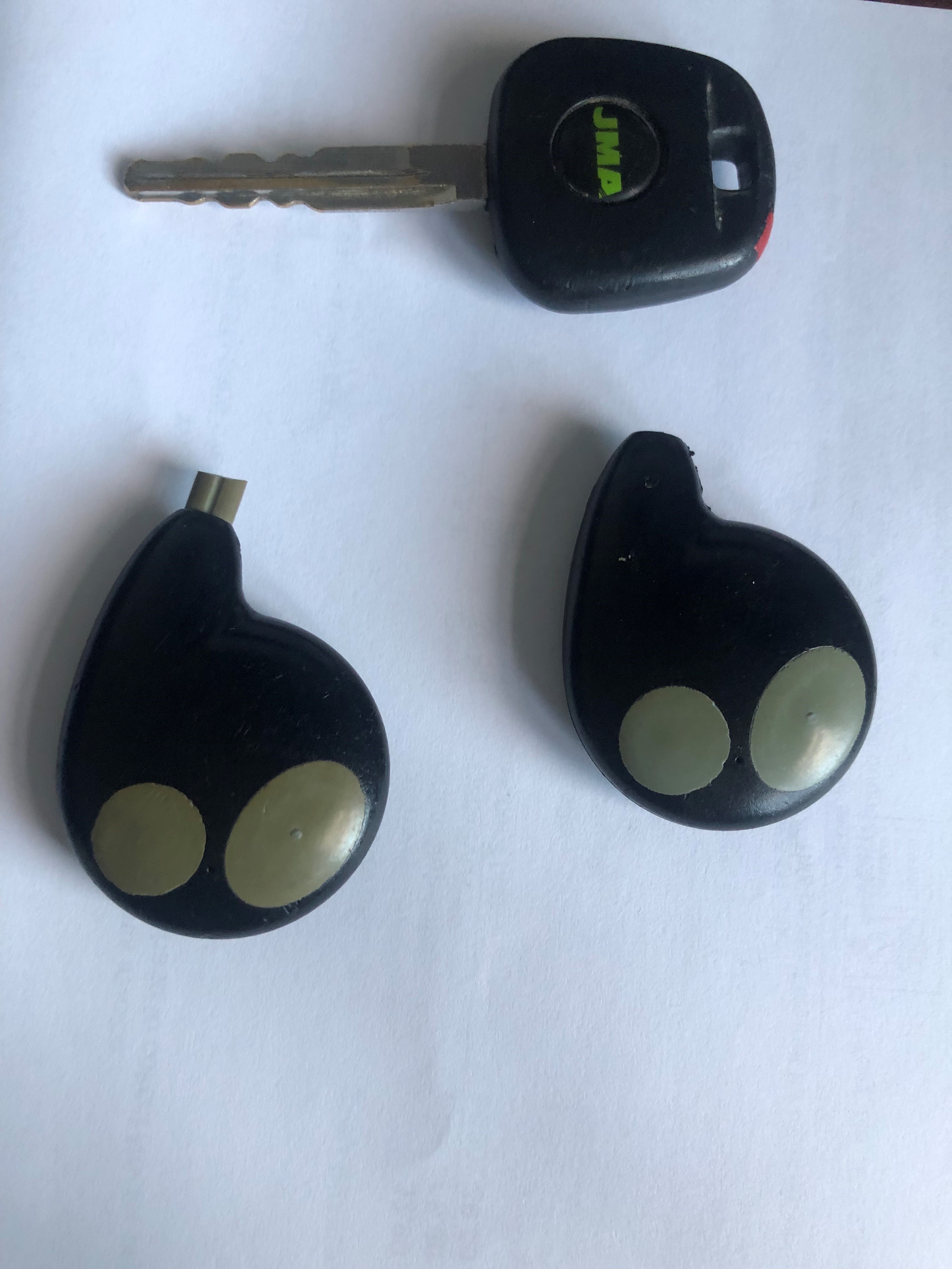

I have a 2003 Yaris and both remotes have stopped working. The remotes are separate to the keys. ie there are no buttons on the actual keys. See photo.
I have tried several methods from the web (closing and opening door twice etc) and nothing worked. Someone somewhere made a comment that it worked when the window was open so I tried that and there was some response. When the doors should auto lock and unlock twice they did it just once but the key fobs did not work. Any ideas anyone please?

That is an aftermarket fob, if memory serves they are standard cobra 7777 fobs - have you replaced the batteries ? (with decent quality. In date cells)
does the car have an alarm ?
does the led flash on the remote when pressed

Your memory is good - the circuit board has 7777 on it.
Yes, replaced Battery (new panasonic).
I believe the car does have an alarm but I've never heard it go off. Is it standard?
Yes, the led flashes when I press the buttons.

It may be dealer fit or fitted later
walk up to the drivers door, and hold both buttons after it turns solid red, let go of the buttons and press unlock or lock
if not
open the door with the key, get in, close the door turn the car on (lights on the dash) within 10 seconds
there are a few other ways, depending on what unit is fitted and its age
Bob, you're a life-saver!
"hold both buttons after it turns solid red, let go of the buttons and press unlock or lock"
This worked first time on one fob and third time on second fob. I had to hold both buttons down for 30 seconds before the led stayed on.
