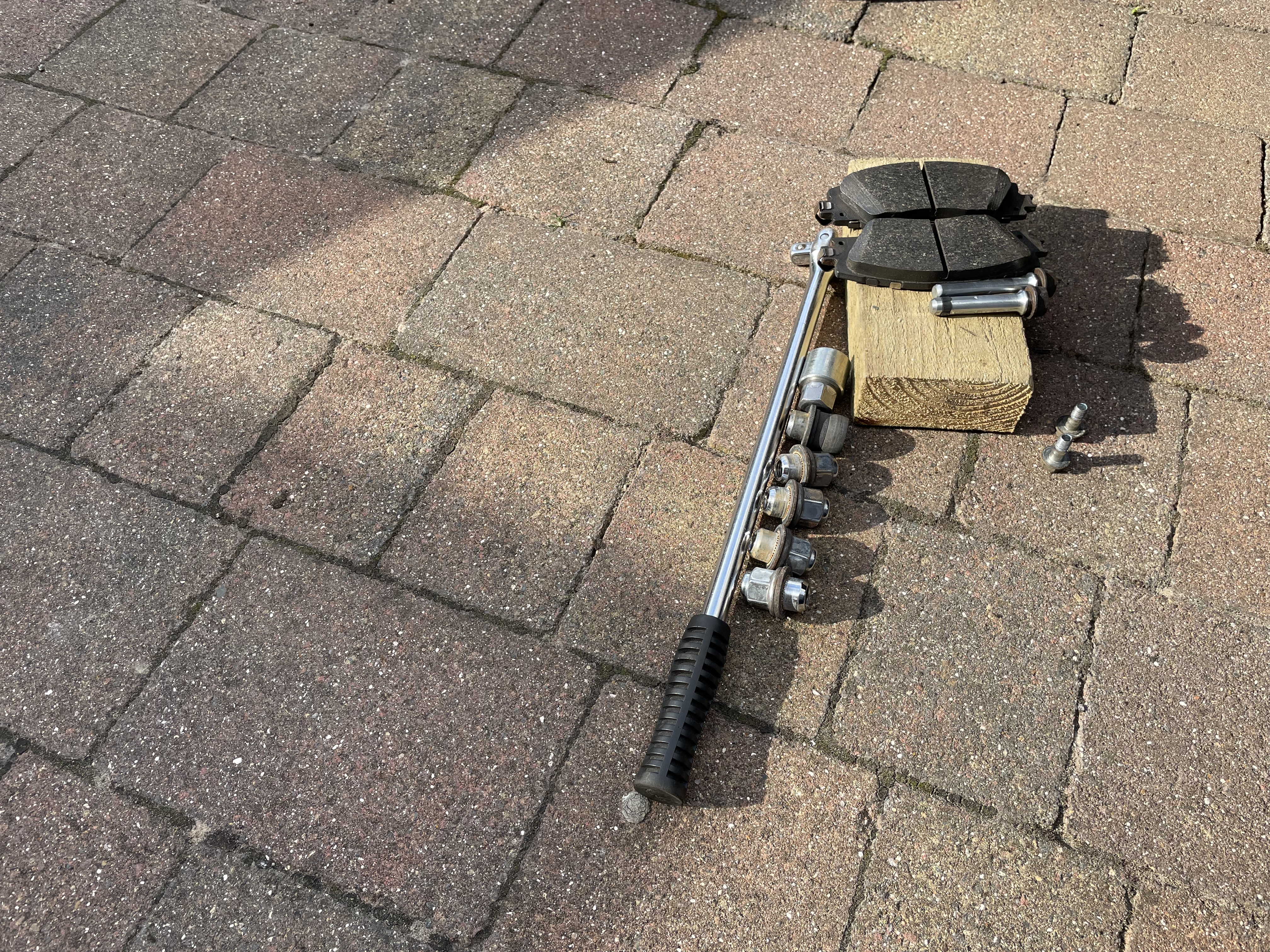

I use EBC Ultimax which are the normal pads and they work really well for me. They seems softer than some others I used previously and add a nice grab to the brake pedal feel, better  than the oem pads imo.
They are not producing any more dust, last long too, but in hybrids they all will do for obvious reasons.  They also smell right , I am not an expertise in brake parts but when been in the trade and ”Textar” were the best in business they had very similar smell.
Here how they look after 88k miles fronts, I didn’t measured them but they seemed almost as good as new. Rears will need change soon  👍
2 hours ago, TonyHSD said:
No offence taken.
