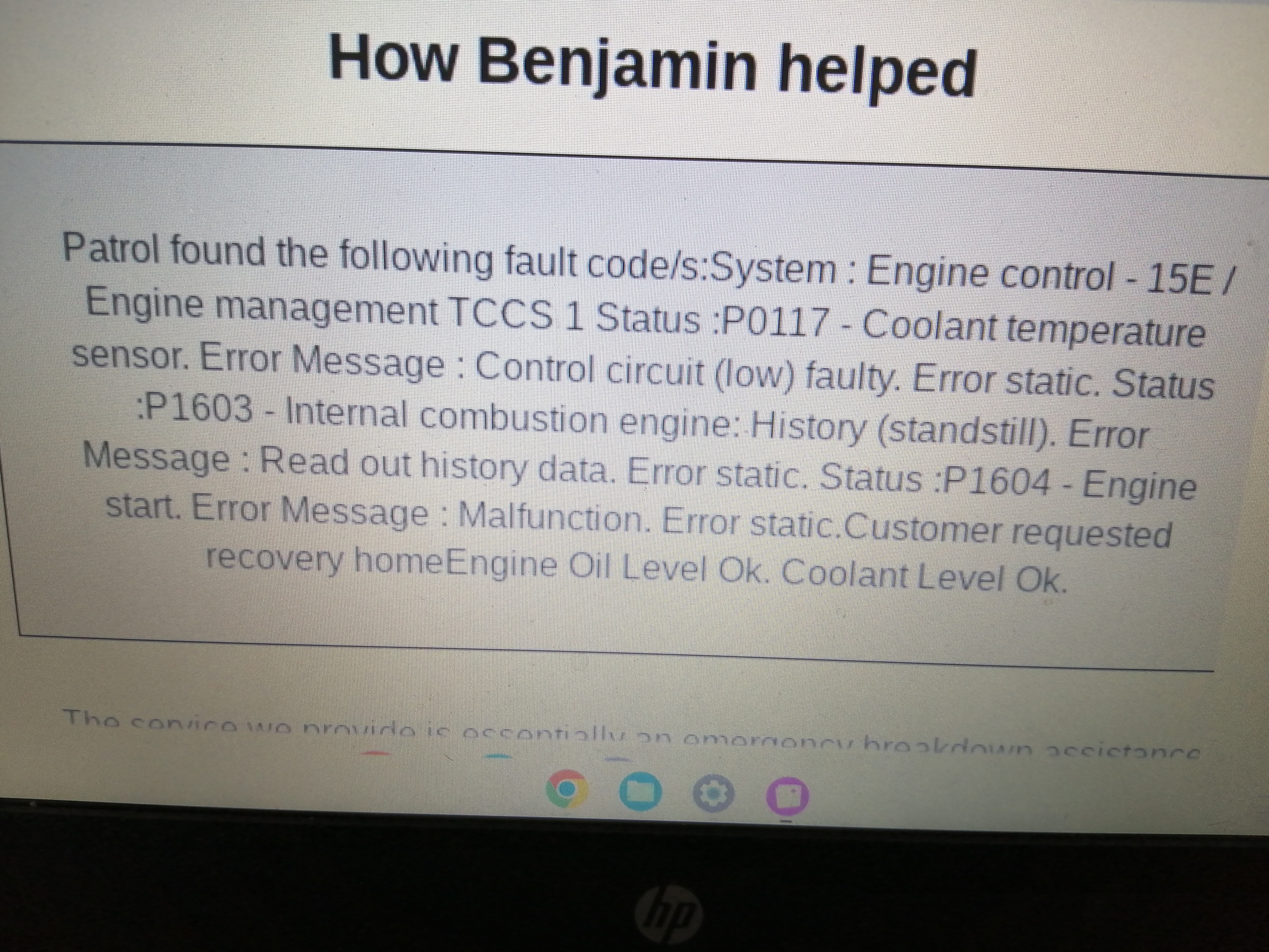

I kept an eye on engine temperature and it stayed as normal.  Coolant reported as OK by AA's Benjamin. Likewise oil. AA report attached, now.

Thank you. See AA report, now attached.

i doubt its timing as it would throw all sorts of other codes and make one hell of a noise if a cam or chain let go, i would disconnect the alternator by taking the power cable off the back and taping it up, or take off the Fan/aux belt and crank it over
P0117 and P1603 point to a voltage problem, if the ecu isnt getting the correct voltage that will cause the P1604

Thank you, Cyker.  Coolant drained, leaking radiator, possibly as a result of a shunt several months before.  It was a £'wedge' but a good decision. I'm in the market for a WAV but not just yet. Take care.
