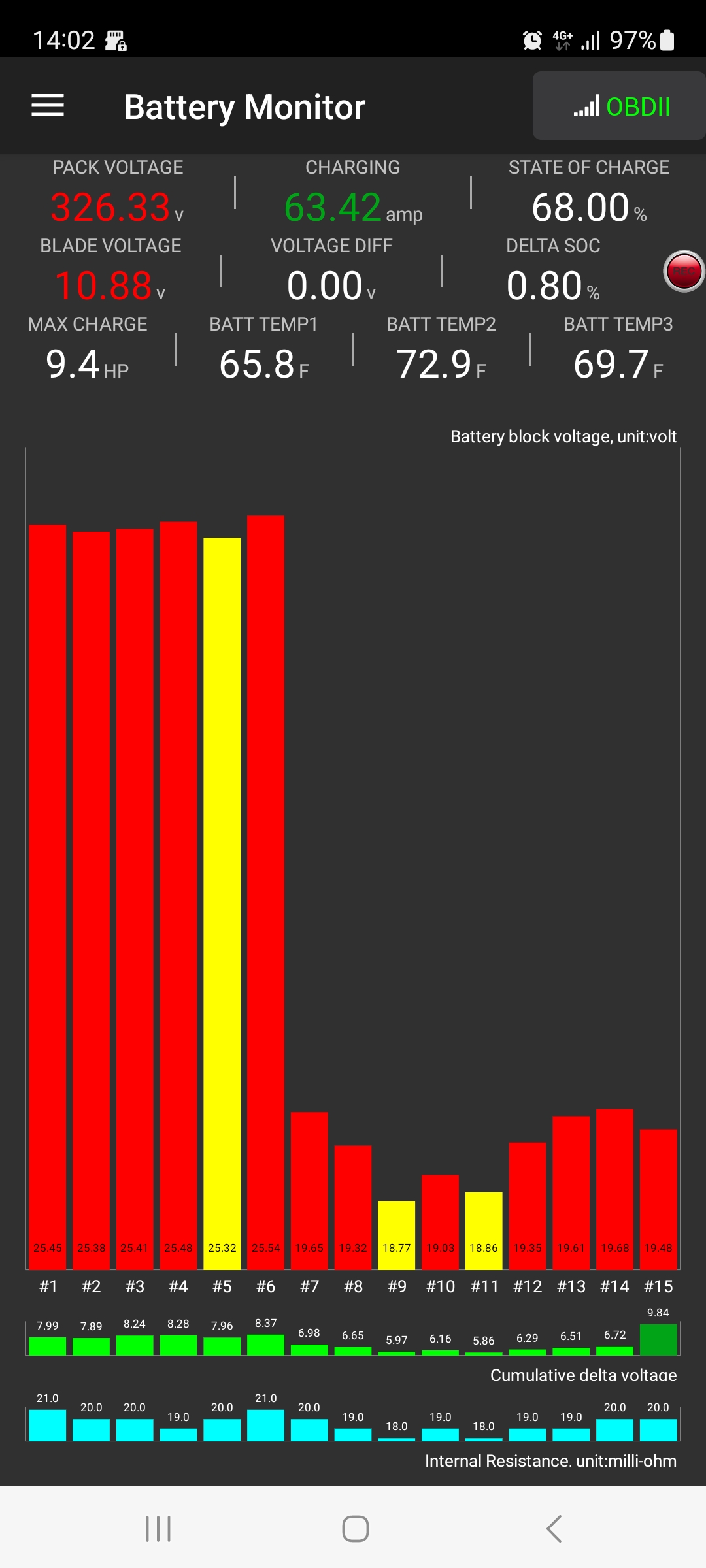

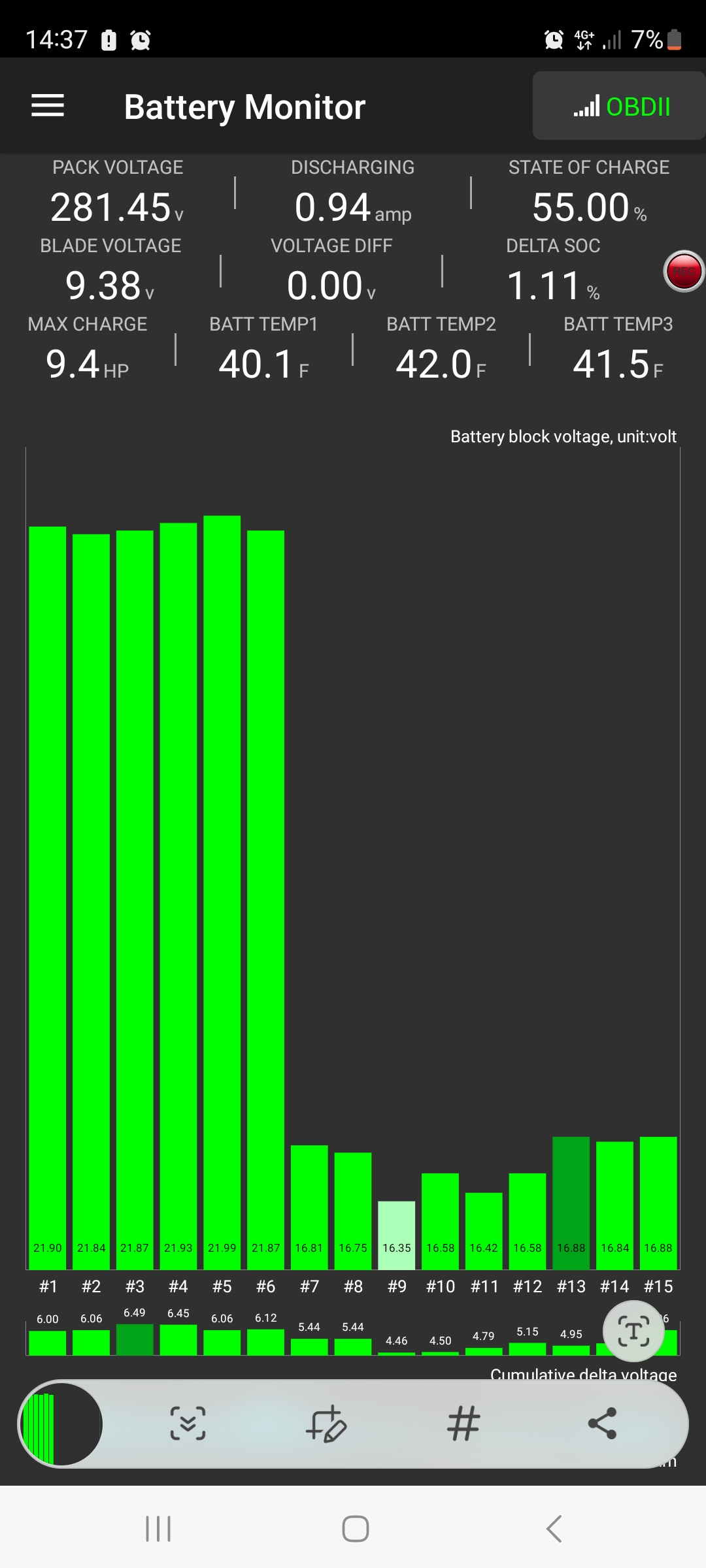

 Regarding voltage. Please find attached report from dr prius. You can see there that when accelerating and braking the difference between max and low  voltage on each block  can be huge. Screenshots were done when car was idling.

i think dr prius is not showing all the data for the Estima as the pack is made up of 12 blocks at 14.4v on the bottom row and 9 blocks x 9.6v on top so 21 blocks
only true way to tell is with techstream - By looking at the data in the CSV, the pack is dying

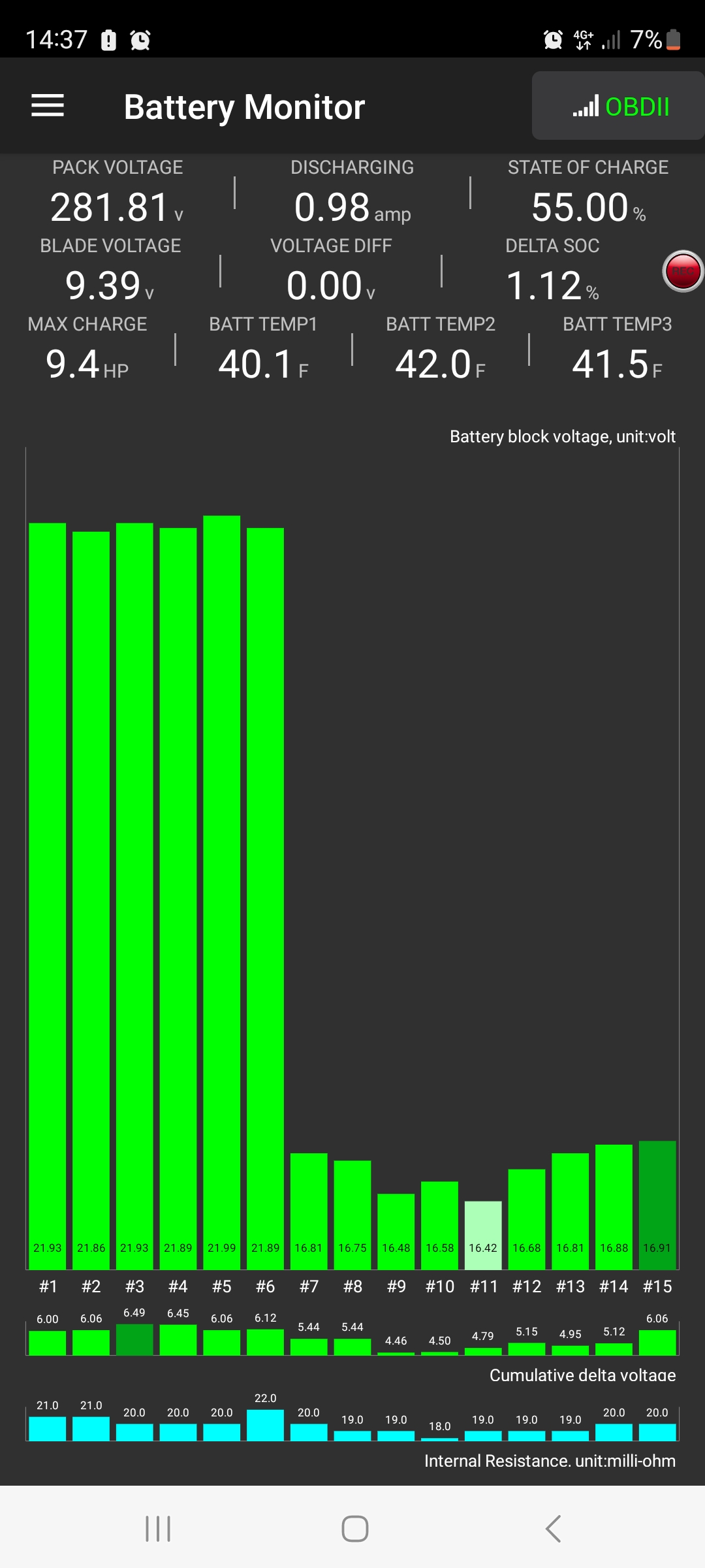

-the voltage when not under load  would show slight v-shape pattern ( please see second pic)

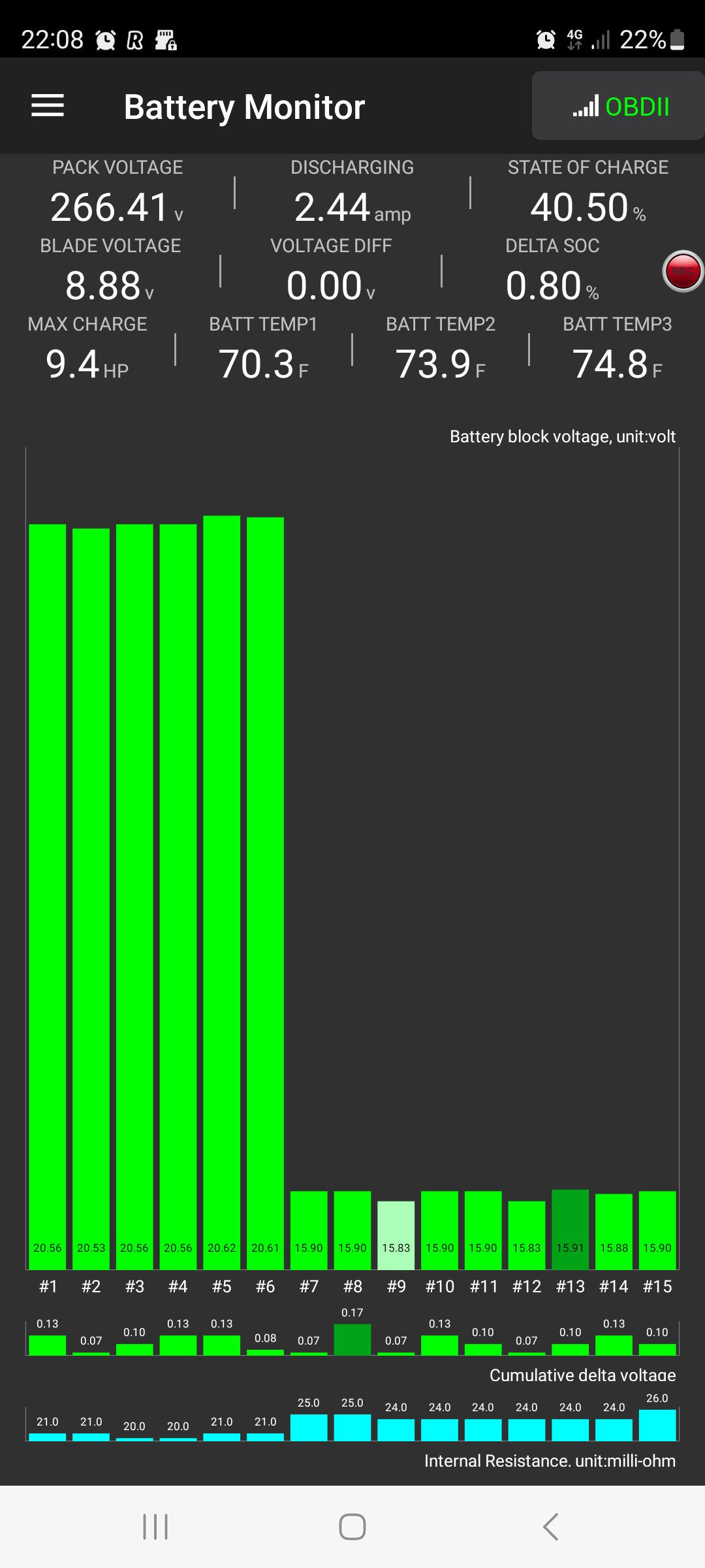

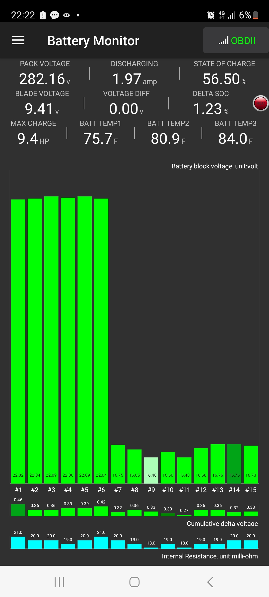

 - v -shape pattern is rather gone ( please see last picture)
- dr prius still shows me very similar data to the old battery ( rather huge difference in voltage when accelerating and breaking,).
-Dr prius capacity test now shows 16 %.. rather than  13%

as i said above the only way with the estima is with Techstream, the pack in the JDM cars is very different compared to other Toyota hybrids that have equal voltage strings (typically 14.4V)
Dr prius doesn't have enough information to fully calculate the values as it's not reading all the strings (21)
