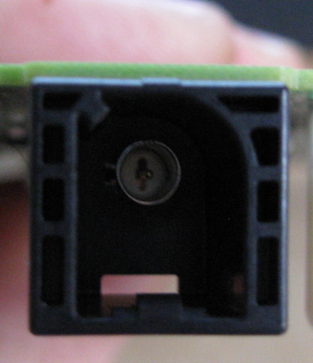

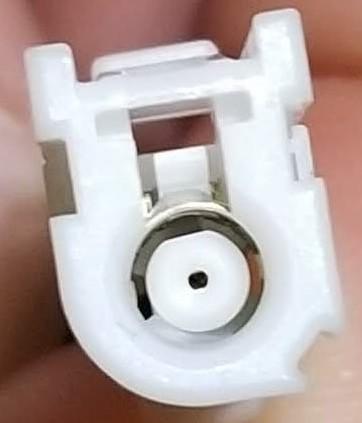

no, the shark's fin is FM only, the Factory dab aerial is stuck to the windscreen if fitted
if you have it, it will be a black connector, this is an SMB Female plug in a Toyota housing remove the tab flick the tab at the front to release it from the housing
it looks like the gps one but black
