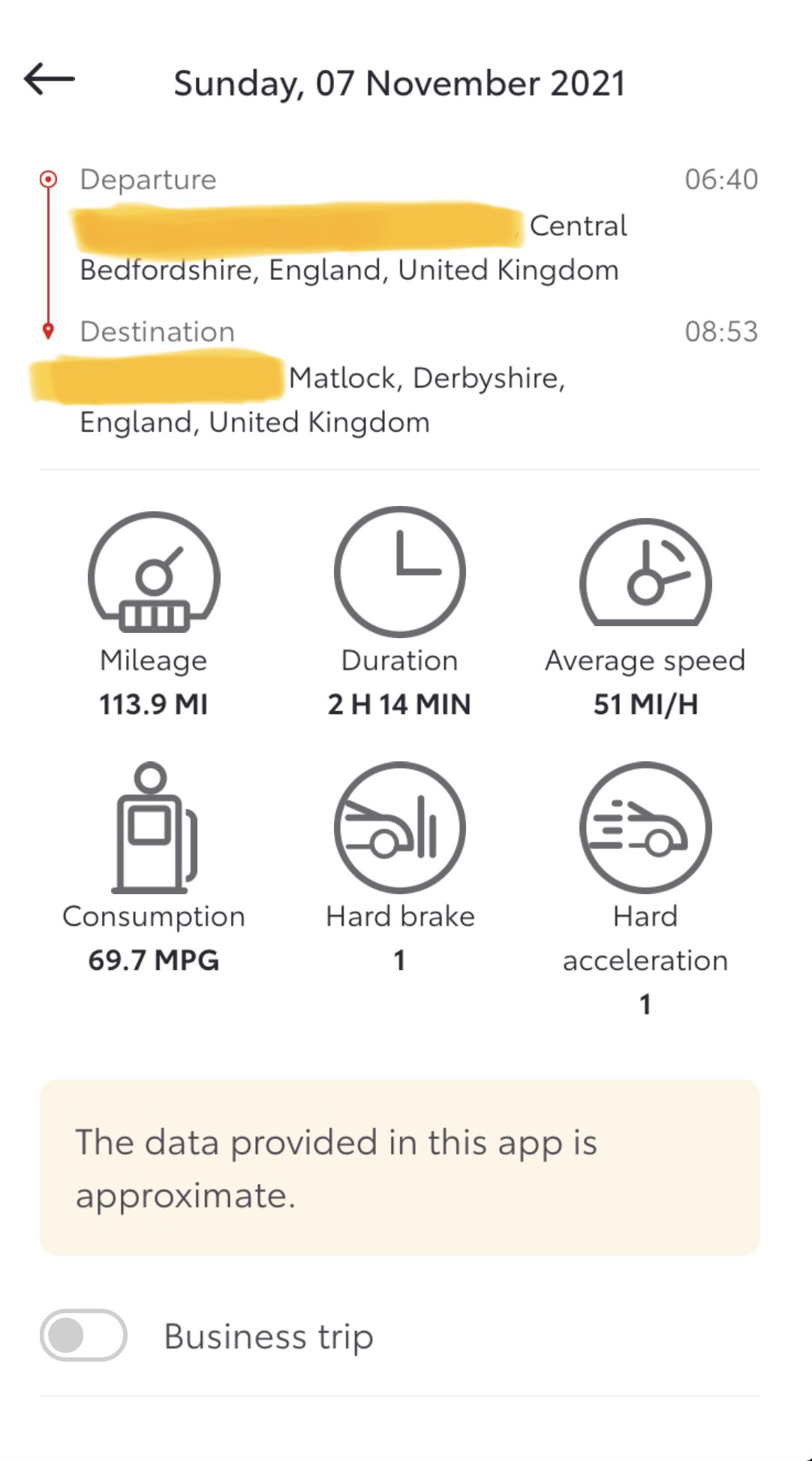

Example, image MyT app below, I think I got around 44 miles of EV on this and doing the calculations the HEV mode was also around 44mpg, average speed 51mph, motorway 60mph actual and cold weather.
Summer much better figures.
As I’ve said I do a lot of local miles and the MyT app suggests if all my miles were using the ICE/HEV then I’d be returning around 150mpg! Meaningless but just the balance of EV/HEV for me.
