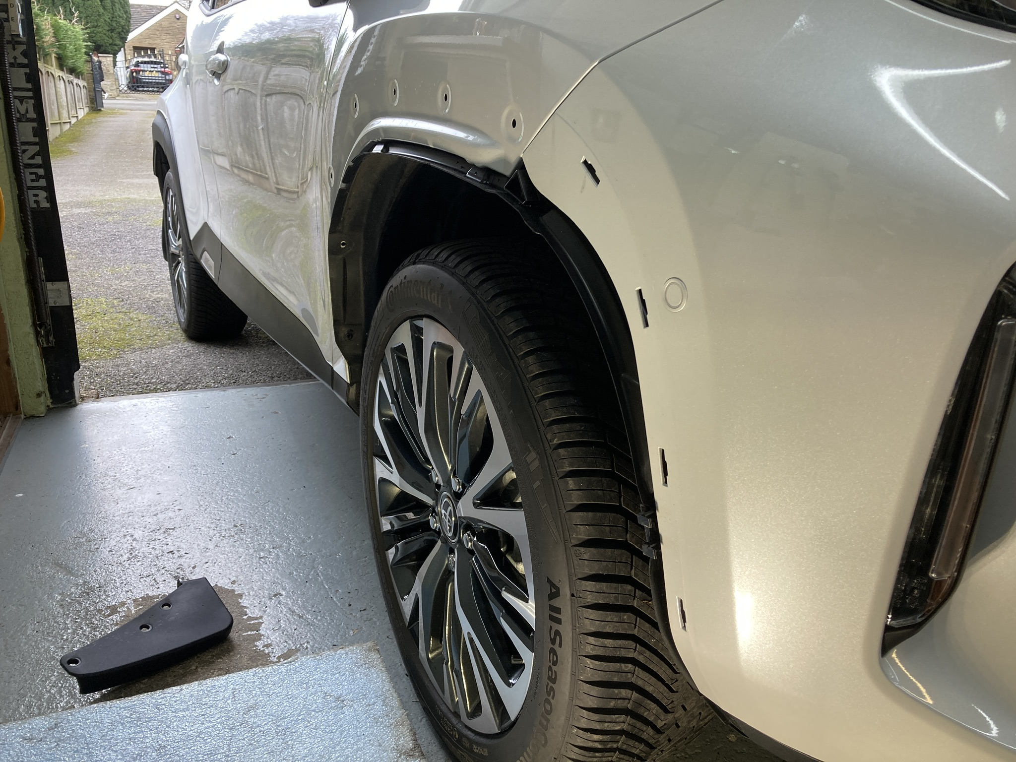

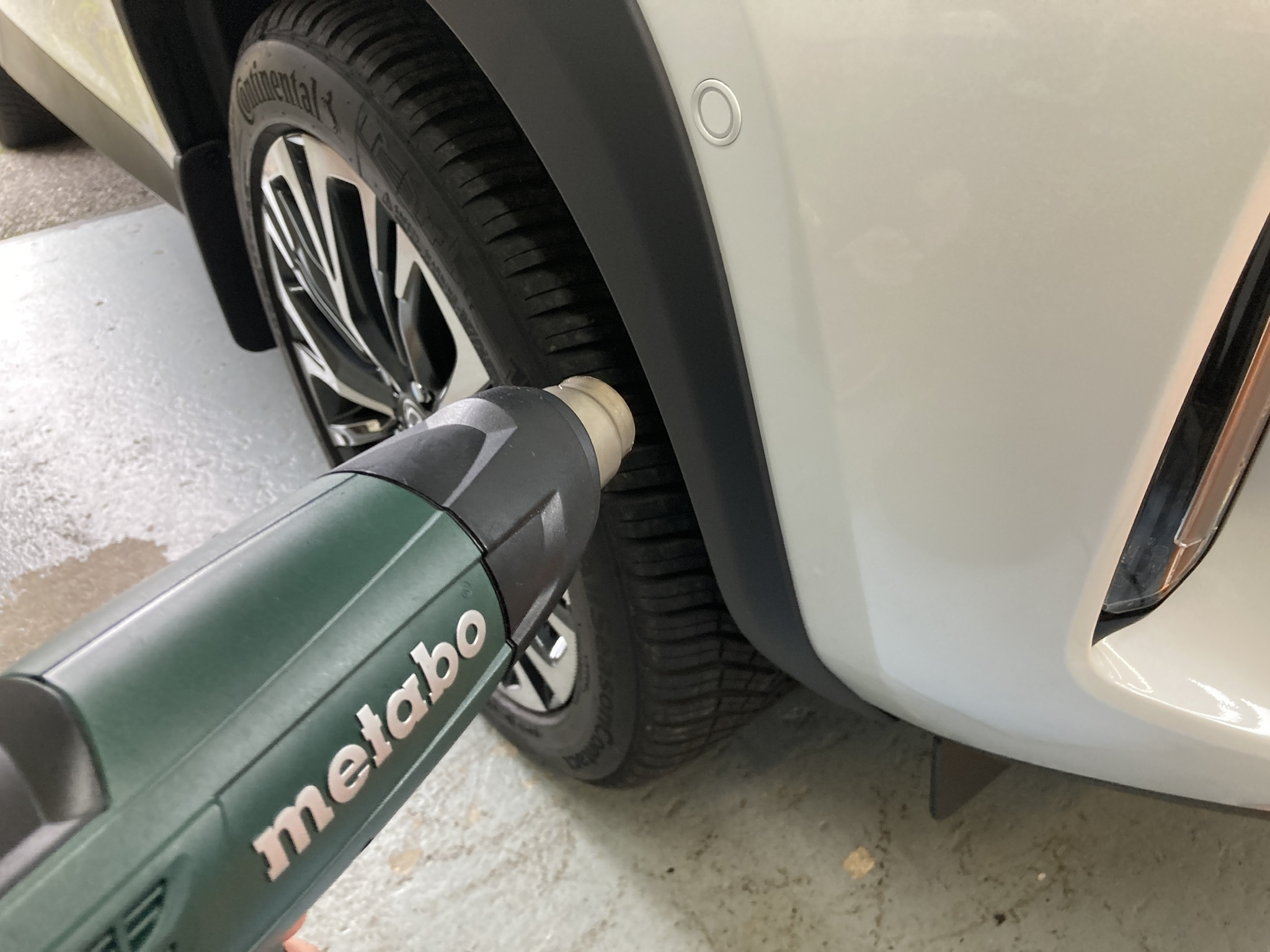

Tony - you can remove them and you need to to fit many accessories because they bridge the bumpers which need to come off.   I warm them this time of the year but anything above 15c I just pull them off.  If the ones in the showroom have a gap it may have had something fitted because they don’t leave the factory like that.  A swift thump with the side of the fist will snap them back tight.
