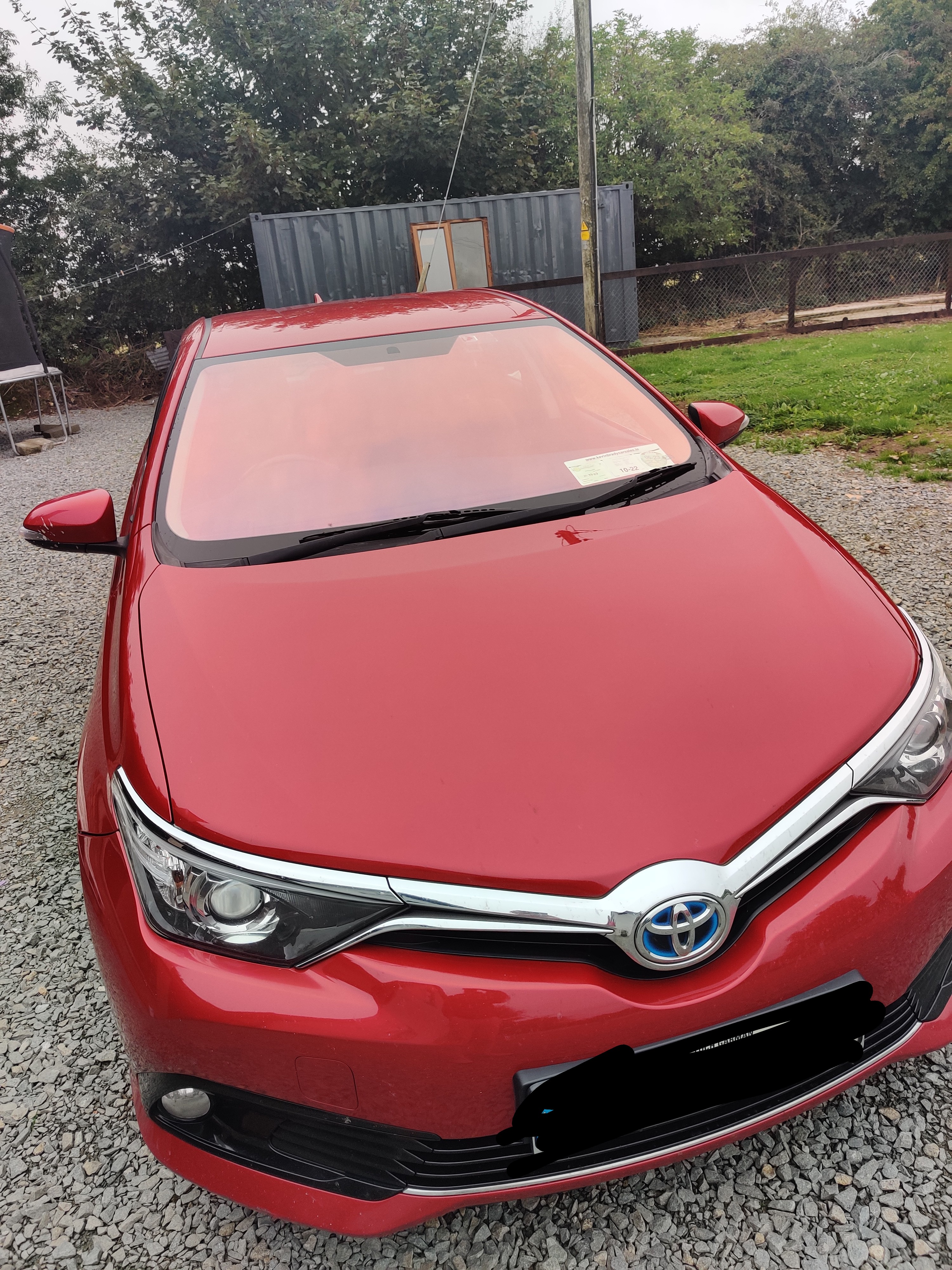

Photos added
The unit it's actually projector not reflector in the pictures, best imo is HID. Need to start from 55w ballast onwards. A relay will be required, watch YouTube videos on how to install. If you cannot do it then pay someone to do so.

Yes correct its a projector unit and i thinking if Reflector unit is possible and if exists. Not sure what parts to look for even... 😄
