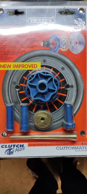

It is possible and happens often in modern cars. Some manufacturers has a specific tools for proper installation of clutch assembly and if this tool not been used will cause exactly that issue.
I remember many years ago I had a clutch replaced and the guy used a tool to centre it.

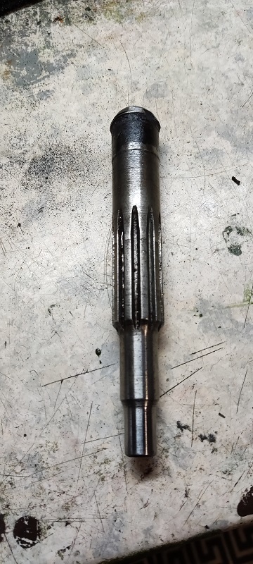

Whenever I replaced a gearbox, I used to remove the 1st motion shaft, burn/cut the end off it, and keep it in my toolbox for future use.

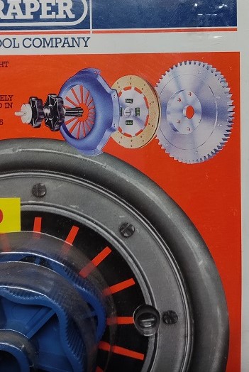

Like this? Also that alignment tool is excellent. Aligning is completed on the bench before going near the rengine.
I have only done it once, successfully, not recommended , to line it up by eye and measuring to place the friction plate central when loosely bolted to the flywheel.
I would expect it virtually impossible for the g/box input shaft to enter the fiction plate without damage.
