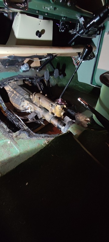

1 hour ago, olonas said:
I would suggest the opposite. Comparitively thick and solid body panels. It's just that there was no anti-corrosion injected into cavities etc..
I agree re part of the floor, that is quite "flexible".
Air conditioning is optional.
I'm sure you're right.  I also know my daughter is infinitely safer in her Aygo than she would be in a Morris Minor.

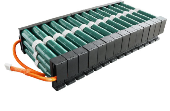

Yes, the hybrid Battery packs are essentially packs made up of multiple (sometimes hundreds) of standard cells similar to those in a laptop Battery. By connecting them in series/parallel the voltage of each adds to the next one. By connecting in parallel you keep the voltage the same but double the current capacity.
Like this but they can also come in weird and wonderful custom shapes to fit the floor pan of the car involved:

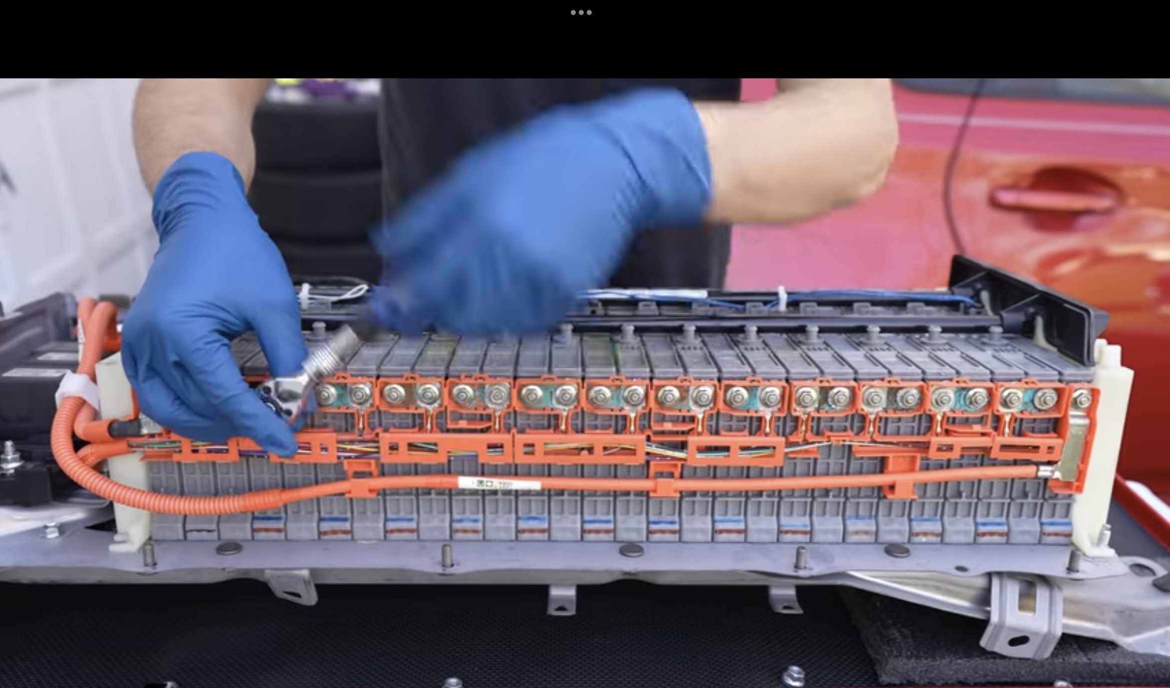

Funnily enough Chris Fix's last video is relevant to this:
