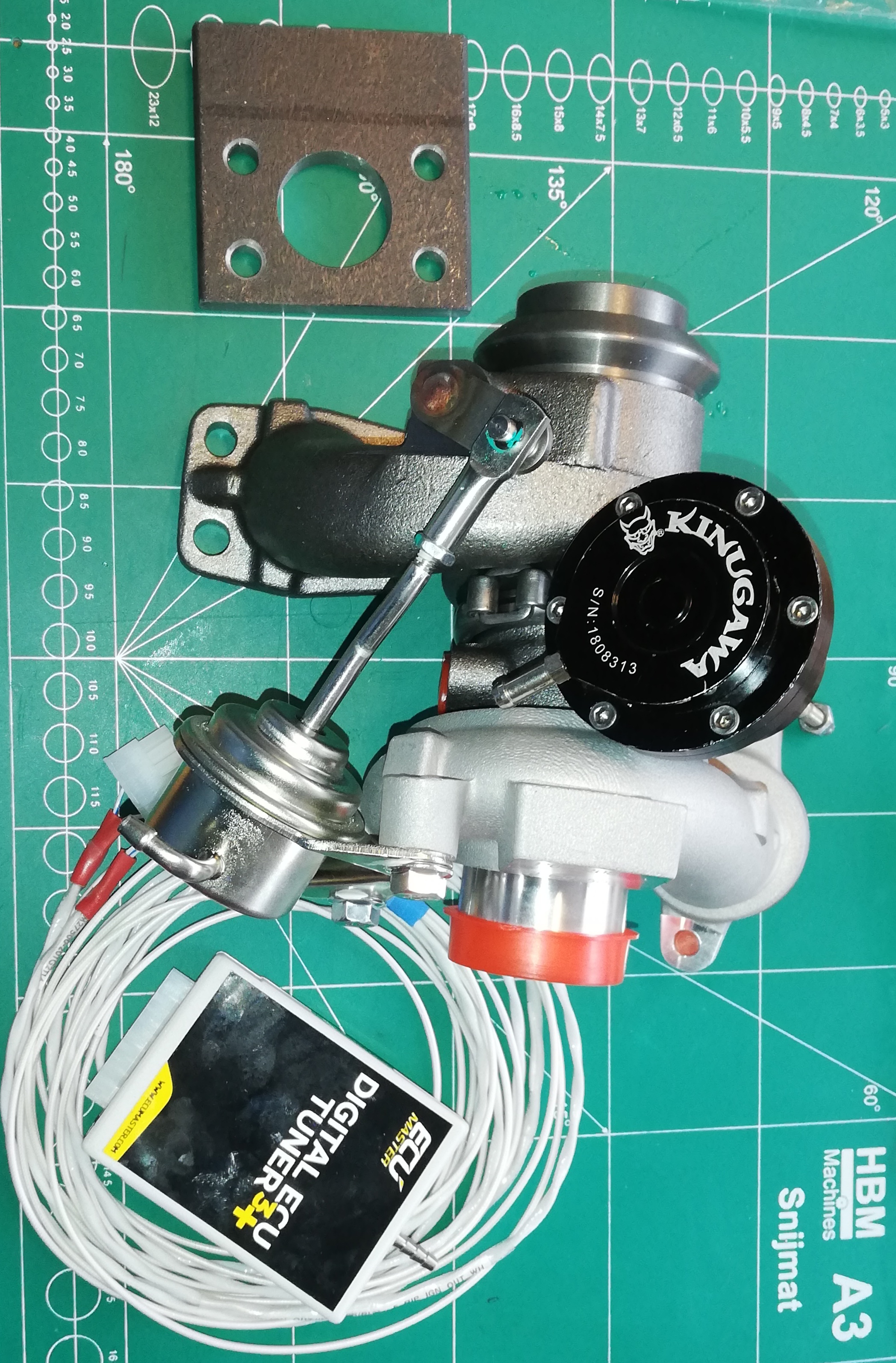

So far I've got some parts in, small TD025 turbo, adjustable wastegate actuator, Ecumaster DET3+ piggyback, 200cell cat converter (will keep it legal-ish, for MOT(by the way; I live in the Netherlands)) making the flanges myself and also the manifold. Biggest challenge (at least for me) will be hooking up the DET3+, it's been done to some Aygos, but these have another ECU/ECM. Ah well, no hurry, I will take my time

Hi Hybrid 21, the wife's Volvo is a 940 with a 2.3 petrol engine..... Although the turbo I purchased is from a turbocharged diesel engine. Maybe not perfect or ideal, but the goal is also not top performance power gain.
