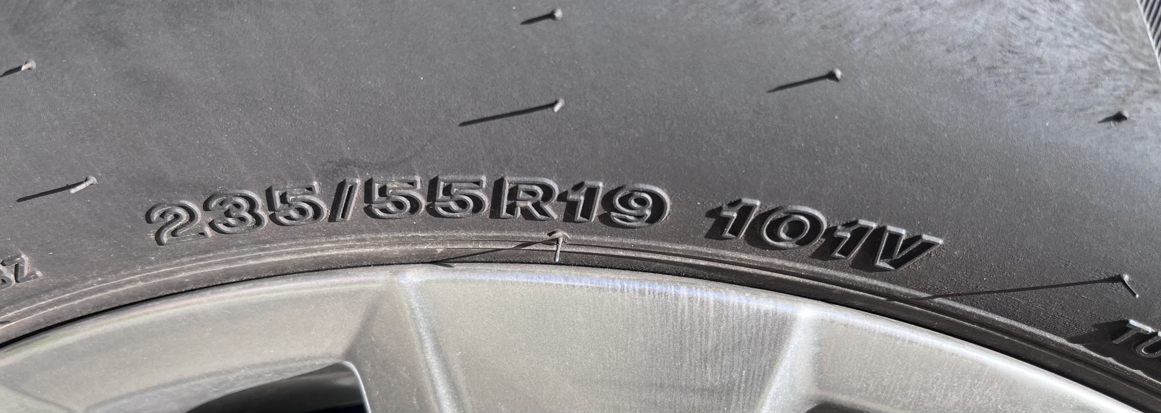

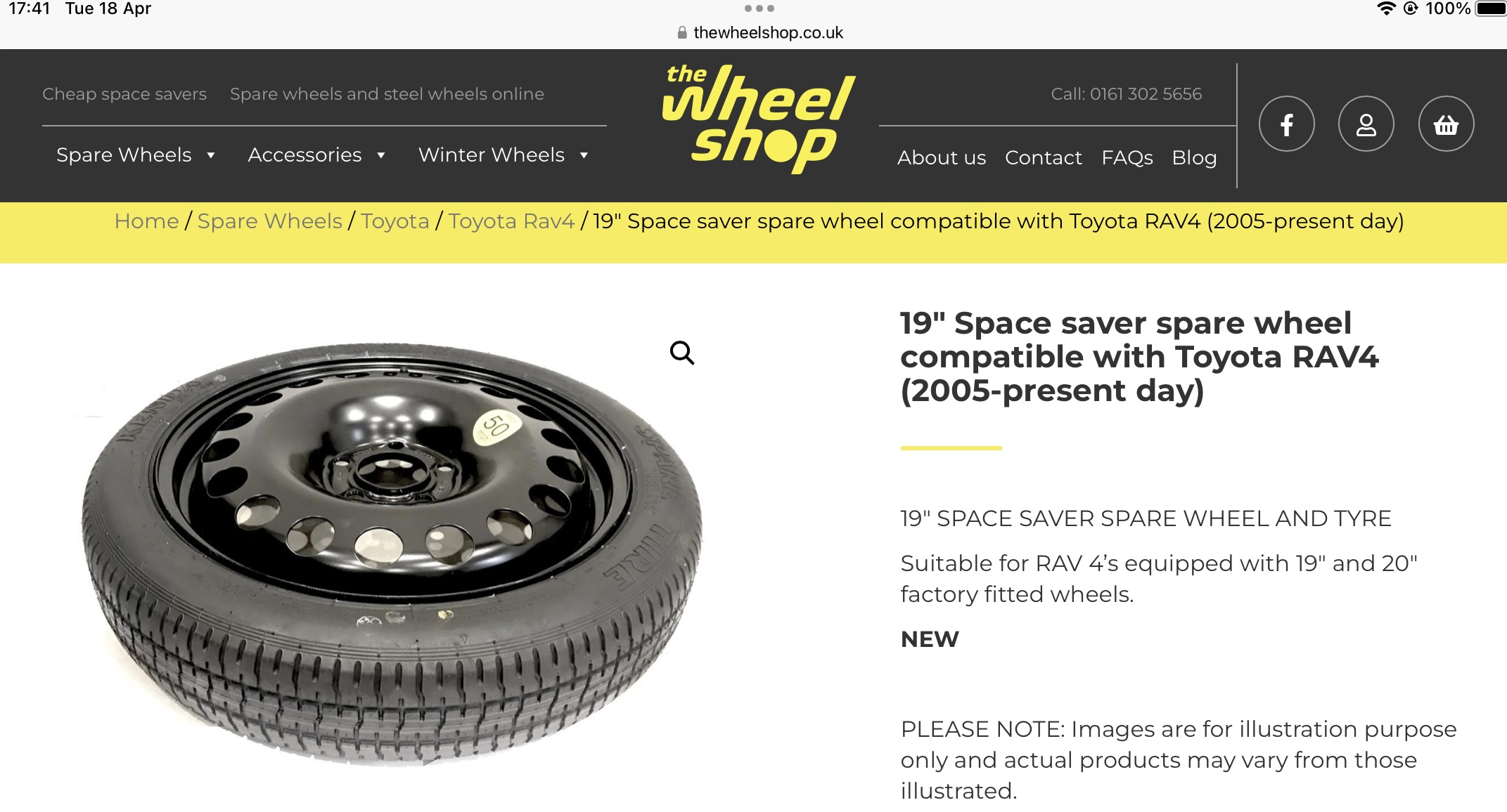

Hello to one and all. Just been talking to the lady at . The Wheel Shop who advised a 19in space saver can anyone confirm this is correct my car is RAV4 Excel 2022 wheel and tyres are 235/55 19 101V photo attached . I am not getting the jack I am to old to change a wheel and I am in the AA thanks again
There are a number of threads on this forum relating to space saver wheels, I have a 2021 Dynamic HEV with 19” wheels and 235/55 19 tyres, my space saver is a genuine Toyota 17” alloy space saver with a T165/80D17 tyre, I believe the PHEV requires an 18” space saver.
Its the overall diameter of the wheel + tyre that is the important dimension rather than focusing on the wheel diameter, and should be as close as possible to the overall diameter of your current setup.

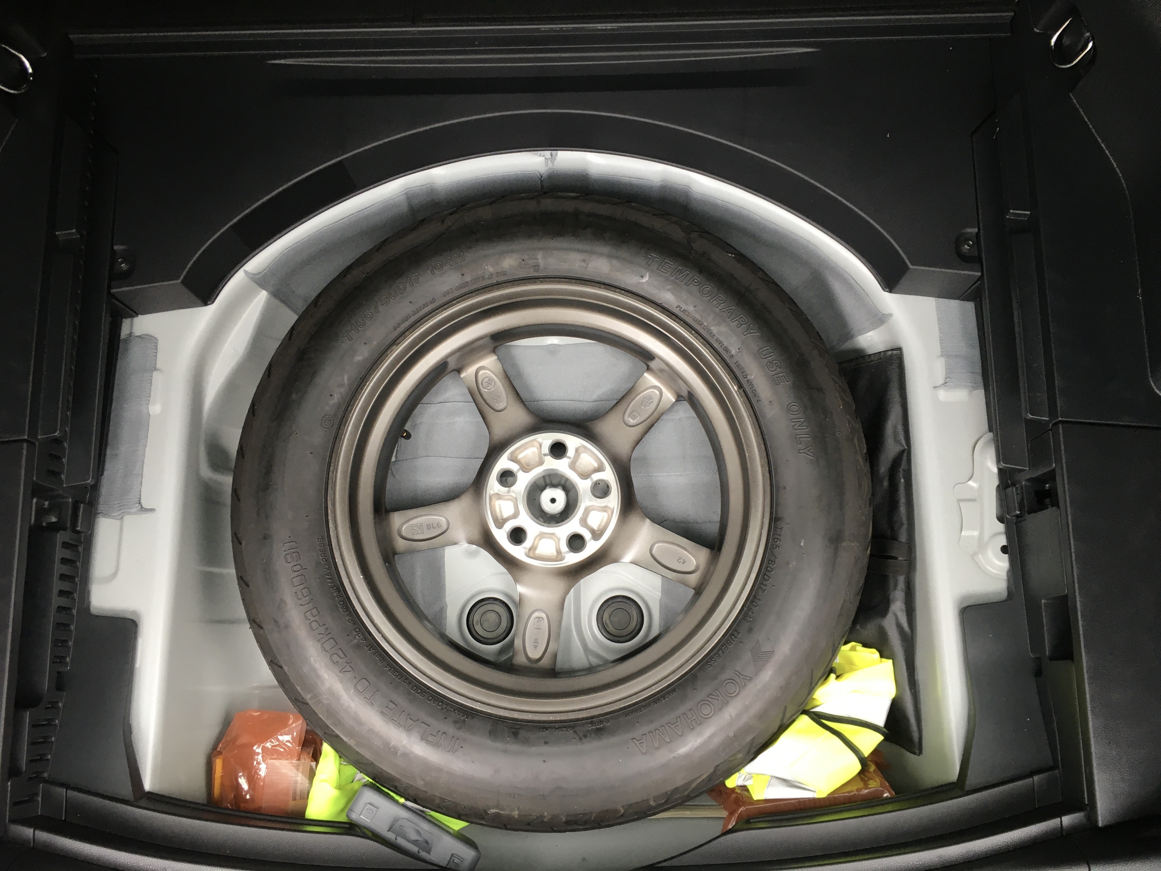

Tyre pressure sticker on my Dynamic.

A space saver is simply a "get you home" spare. It is essential that it has the correct bolt pattern - PCD: 5x114.3 - but there's a fair degree of latitude in acceptable diameter. So you might have anything from a 17" rim with a tyre with a deeper sidewall to a 19" rim with a shallower sidewall.
As above, the OEM suggestion / offering is T165/90 D18 ...
This 19" (steel) offering from the Wheel Shop will work perfectly well.
As will this 18" (alloy) kit from Road Hero / Carnoisseur ... T155/85 D18
They all have broadly the same overall diameter and the required bolt pattern.
philip42h thank you I'll go with your recommendation I will buy from the wheel shop 19in . The reason I am being cautious and asking questions is I am newly qualified driver for Guide Dogs my next trip I have two blind  people with Guide Dogs they are going for training and I would hate to think we were stuck without a spare I have the so called Goooooo 🙄

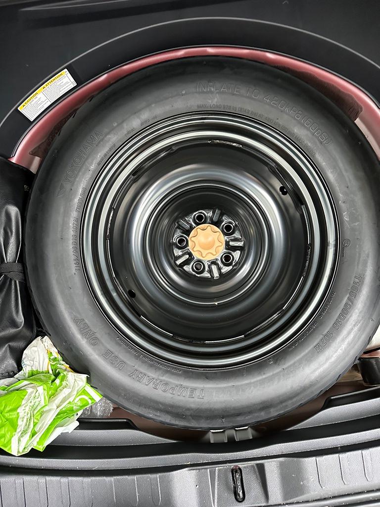

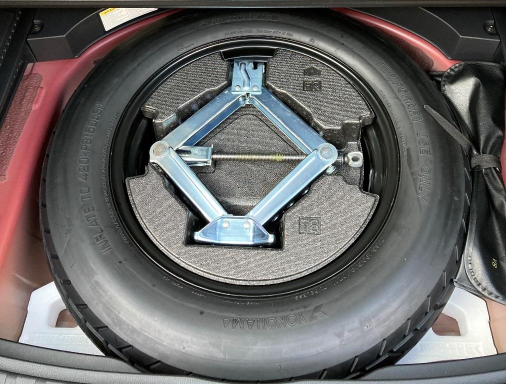

My 2022 RAV4 Excel came with a spare 18" wheel and tyre it is actually slightly bigger in diameter than the full size wheel, you can see the size on the picture below.

Thank you to everyone for all the advice I purchased a 19inch space saver from the wheel shop excellent service mine came the next day I also got the securing  bolt  thank you all again
