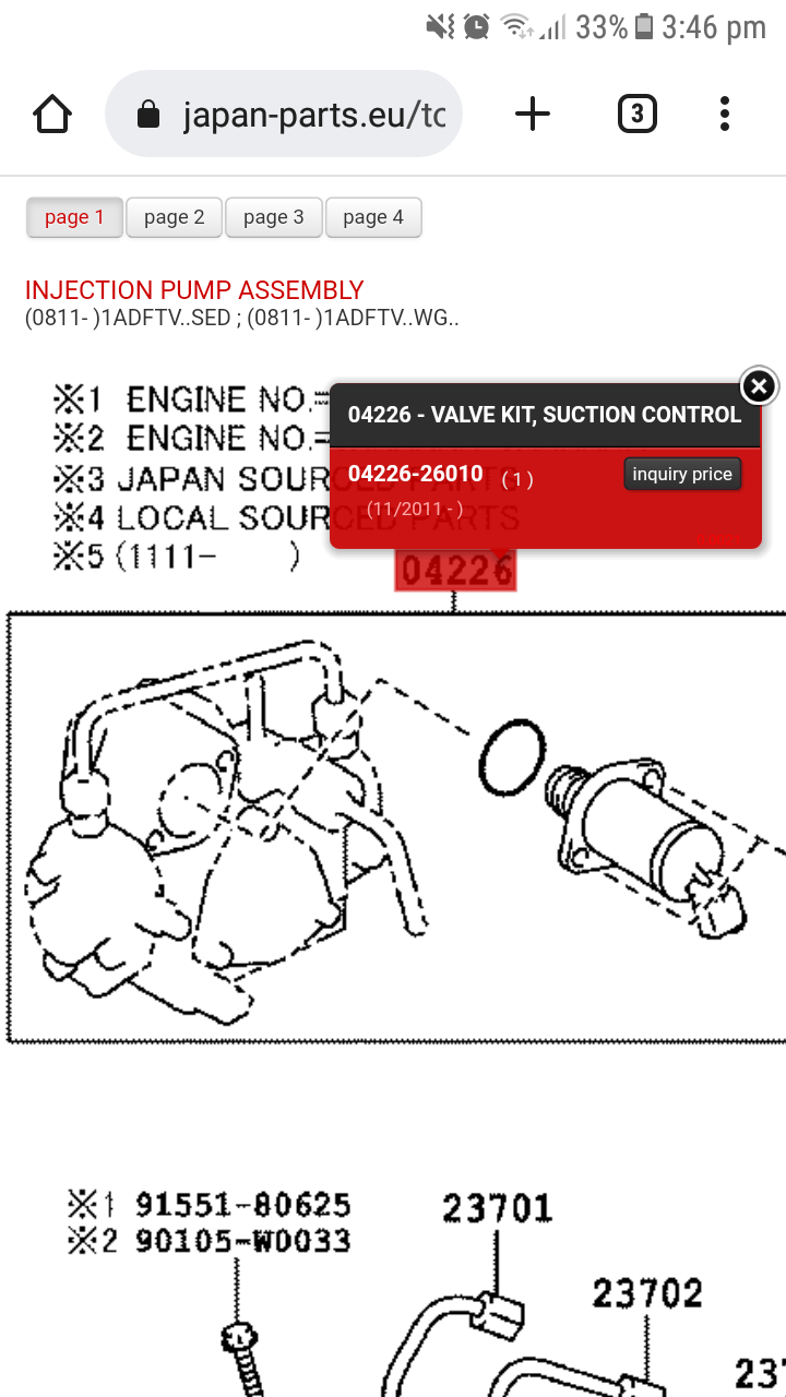

Hello by chance could it be the suction control valve on. The pump might be the problem I have heard this could cause those problems .that pic is for the 2.0 d4d engine yours must be something like it
I'll certainly have a look at this, thanks for your reply! I'll post back with what I find regarding this
Okay, so I changed this valve today. Probably the easiest job I've ever done on a car. Sadly, the lengthy crank time persists. Might the issue now be to do with the fuel pump or fuel injectors?
