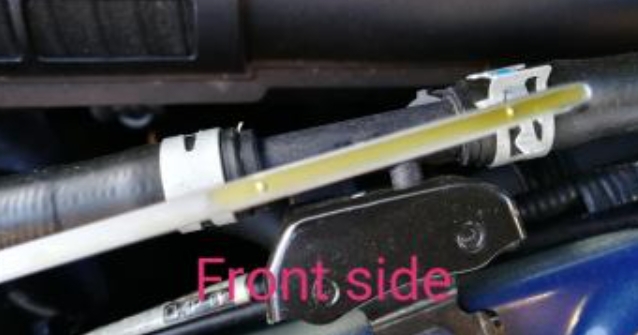

Hello I have a 2014 Toyota avensis 2.0d4d I changed the oil and oil filter genuine stuff yesterday .well as everyone knows to check oil on these are a pain well I filled my oil but filled it above the second mark where I'm guessing should be in between do you guys think it will be ok to be slightly over or take some out. I must get one. Of those oil pumps that can take oil out as I ment to get one but didn't
If it's just a small bit over, then I wouldn't worry about it.  If it's well over the second mark, it would be best to take some out either using an oil pump or by opening the sump plug.

Aye must buy one of those oil pumps to have they will be handy .it's like this much over is that bad back side looks more not know why
I wouldn't worry about it being that small bit over.  I've often had my oil slightly above like that too and mechanics told me that it's fine.

o i thought supposed be better in between those marks half way but never over . just 1st time that much over when i dont have one of those oil pumps .always thought must get one for that reason
If you're really worried I'm sure you can loosen the sump plug a bit and drain a bit out (Into a drain pan!) then tighten it again, but unless you're thrashing it and going up and down steep hills a lot that little bit is very unlikely to make much difference. (And if you are thrashing it the excess will get burnt off pretty quick anyway if it's anything like my old 1.4 D4D :laugh: )
As others say if not too much over then it’s ok. Check how much over is and if it’s more than 5mm above better to get some out. You can buy a large syringe and tube and get it done via dipstick, no need to get under the car again. 5mm overflowed equals around 200-300ml of oil in petrol engines. Diesel if Toyota might be similar, if bmw engine don’t know.

When I had a 2012 Avensis 2.2 D-4D the Toyota garage overfilled it to about the same level you've shown and when I queried it with then they said its fine and it was.
mine also a little above the max mark, like at your pic. everything is good 🙂

If it just a small amount over the max mark when up to temperature then just ignore it.
