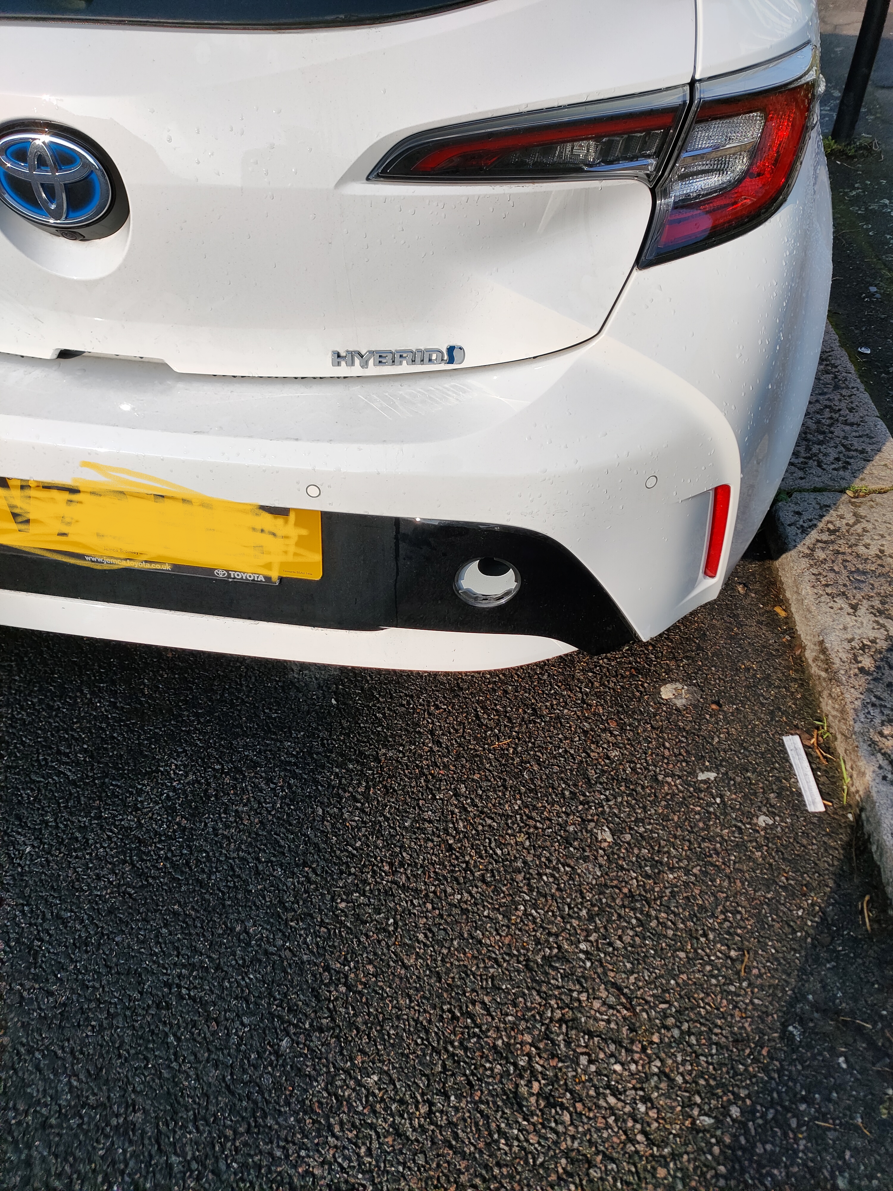

I woke up this morning to find a bumper cap missing. Does anyone know the proper name for this part and where to purchase from please?

It looks like someone has nicked it, or another way of losing this is if you touch an object while reversing, just light knock in odd position can pop this cap out.

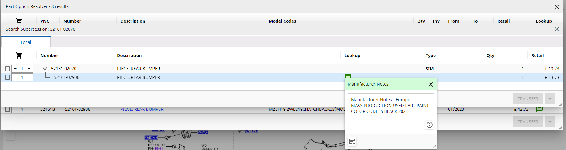

This is only from Toyota dealer as original part, cost perhaps around £10. Rear bumper towing hook or point cover.
Part number 52121-02906 @ £13.73 +VAT per parts catalogue it will be primered and needs painting code 202 Black
