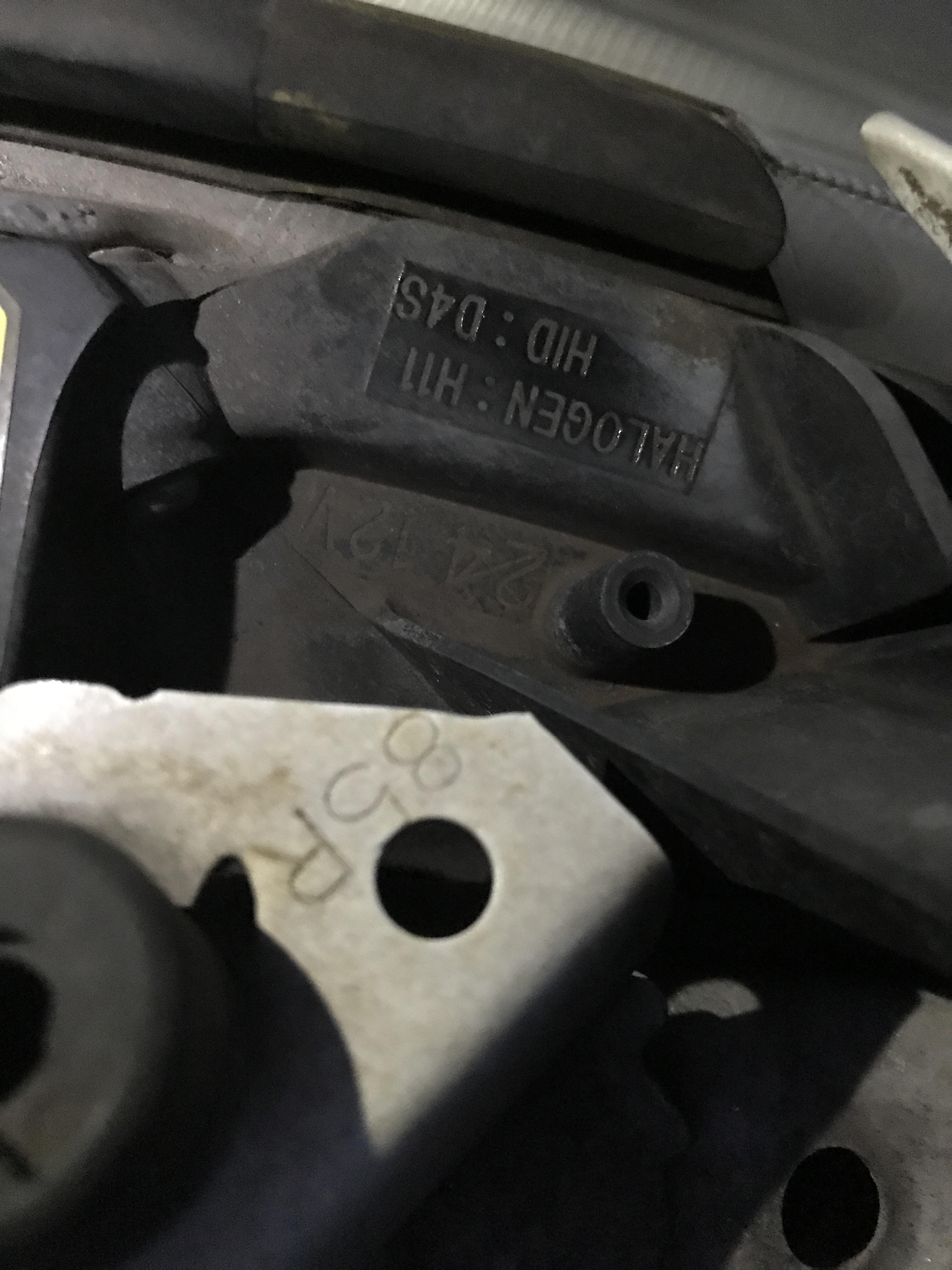

Do you have HID's - D4S should be stamped on the headlight housing

The only mark I see is this one as in the picture. I can’t get my hand behind to get access to the bulb. I’m hoping it’s just a replacement and not a problem with the electrics

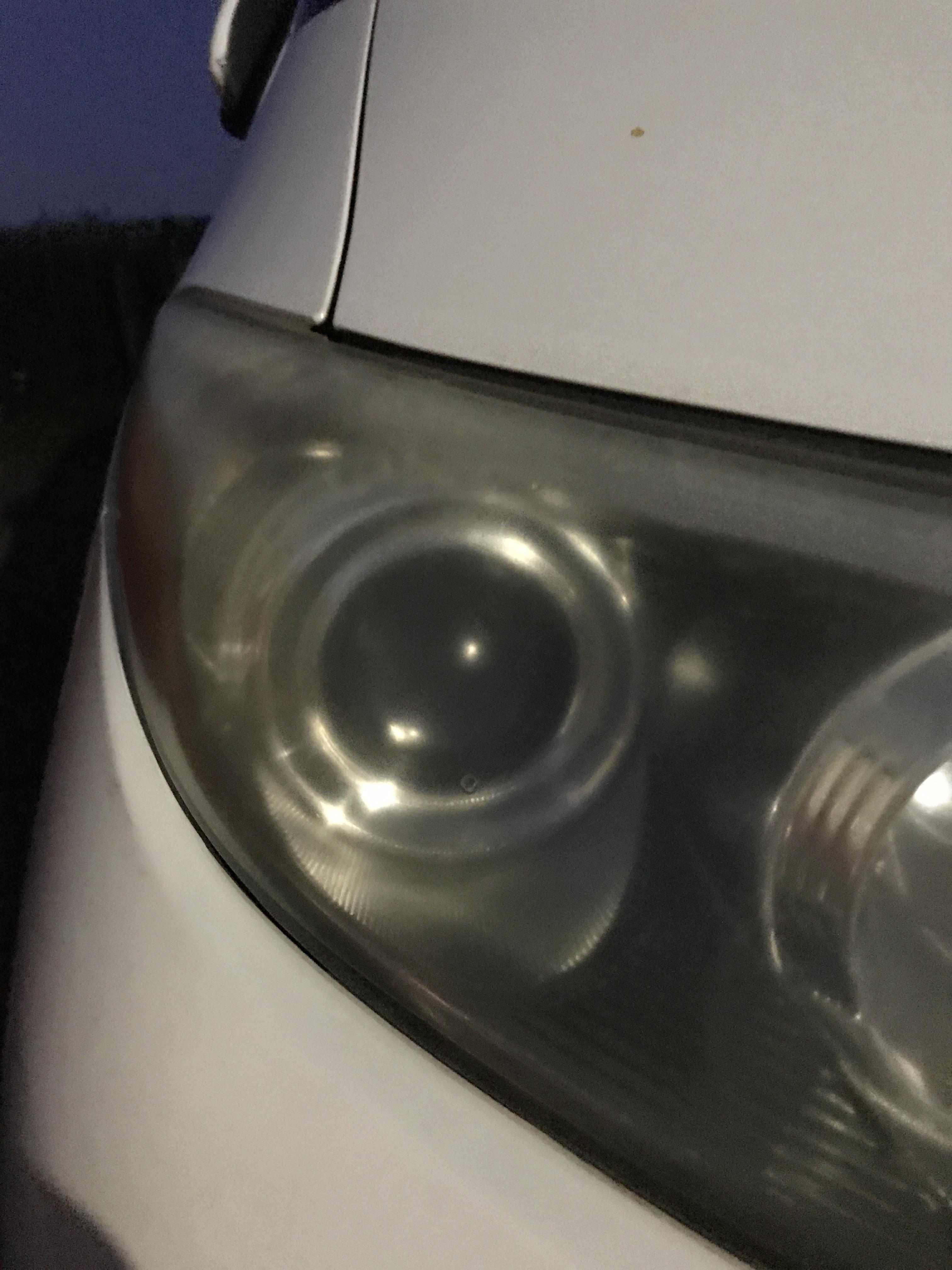

The light is this one. Could it be a projector headlamp meaning it is a HID lamp?
If no corosion present on bulb holder change bulbs.

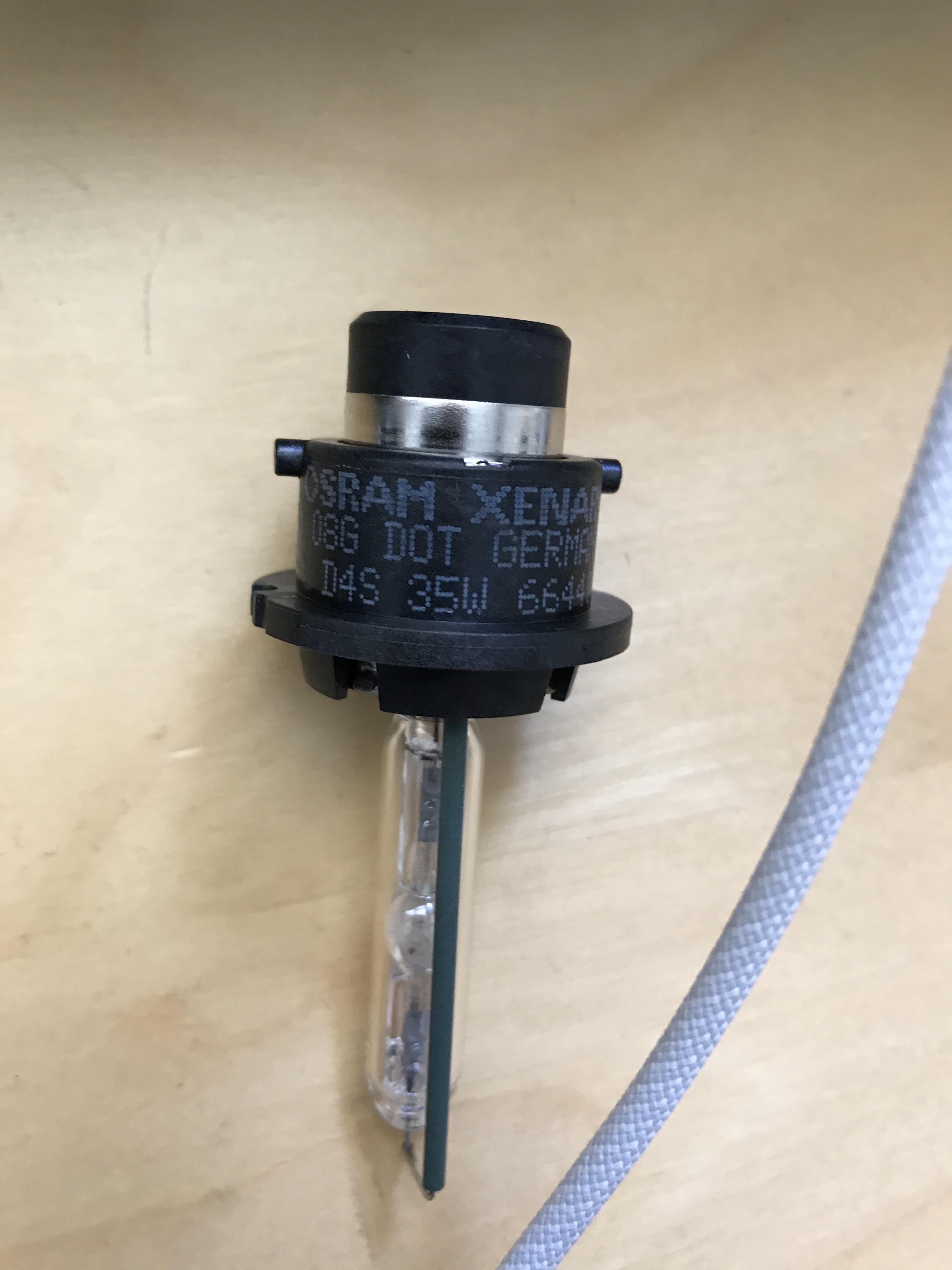

Yea it’s the d4s . I managed to remove the bulb. No corrosion and bulb looks fine.

Change the bulbs, they are more than likely original and will have started to degrade many years ago, they may be changing resistance as they get hotter and the ballast is going into self protect mode, you should notice a big difference with new bulbs
Go with a decent brand like Osram or Philips - bulbs are not cheap but cheaper than the ballasts
