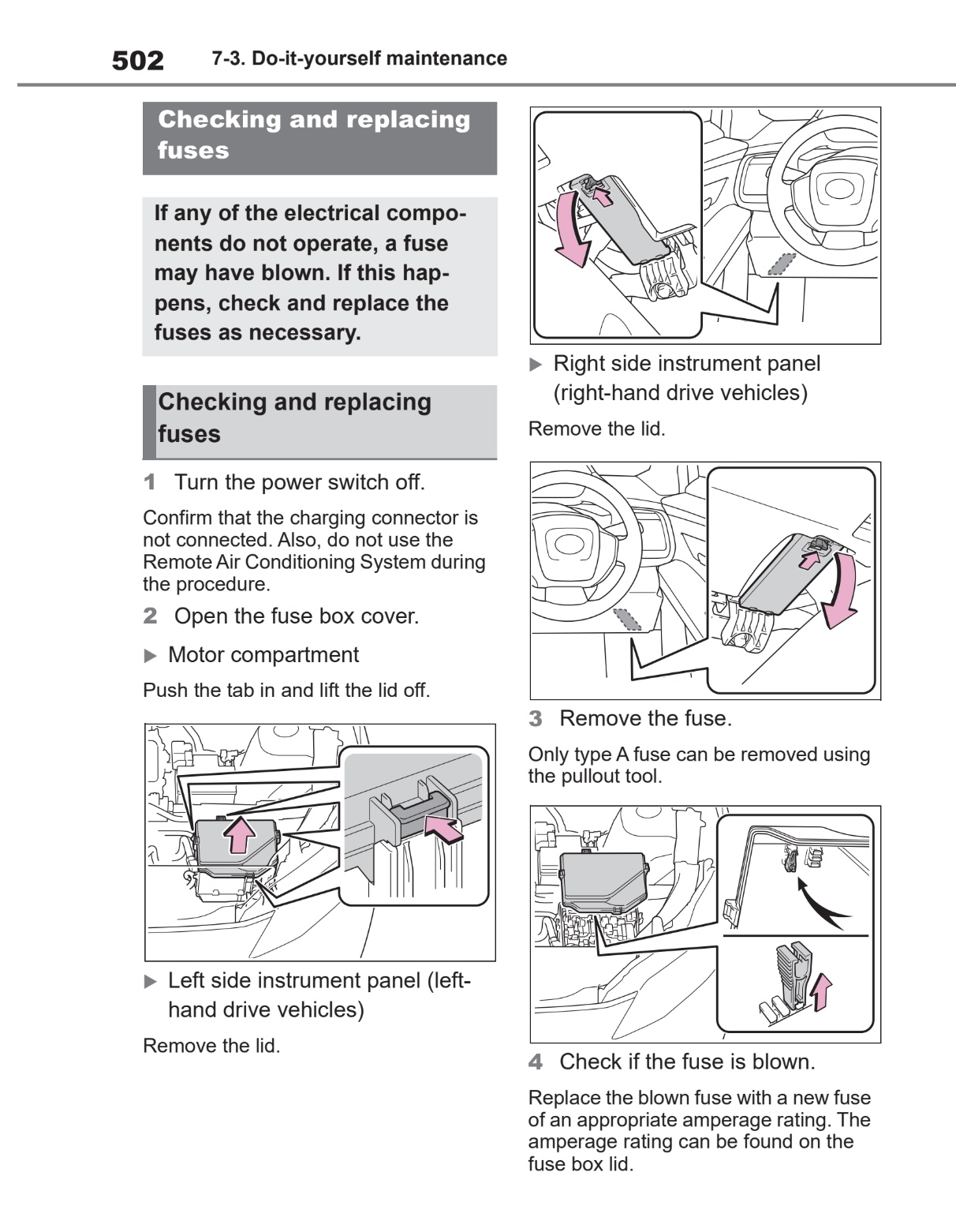

This may be an obvious question so no offence meant, but have you checked both fuse boxes? There’s one in the motor/engine compartment and one inside the car.
Diagram from manual below.
Thank you so much. This never crossed my mind for the 100% EV car. Silly me in deed.

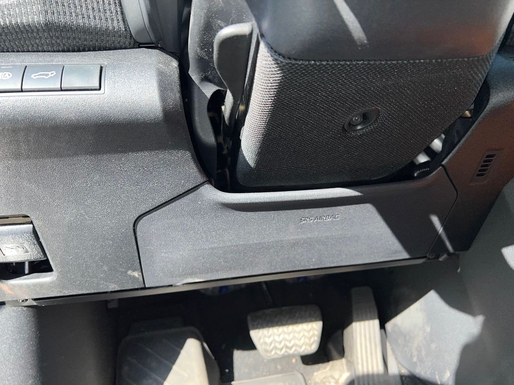

Well, I looked at the location indicated by the photo from the manual and I didn't find any fuse box underneath the steering wheel 😒
I took the photo of my car below.

Hi! Did you find the fuse box? I am trying to hardwire a dash cam, but I cannot find it either lol!
