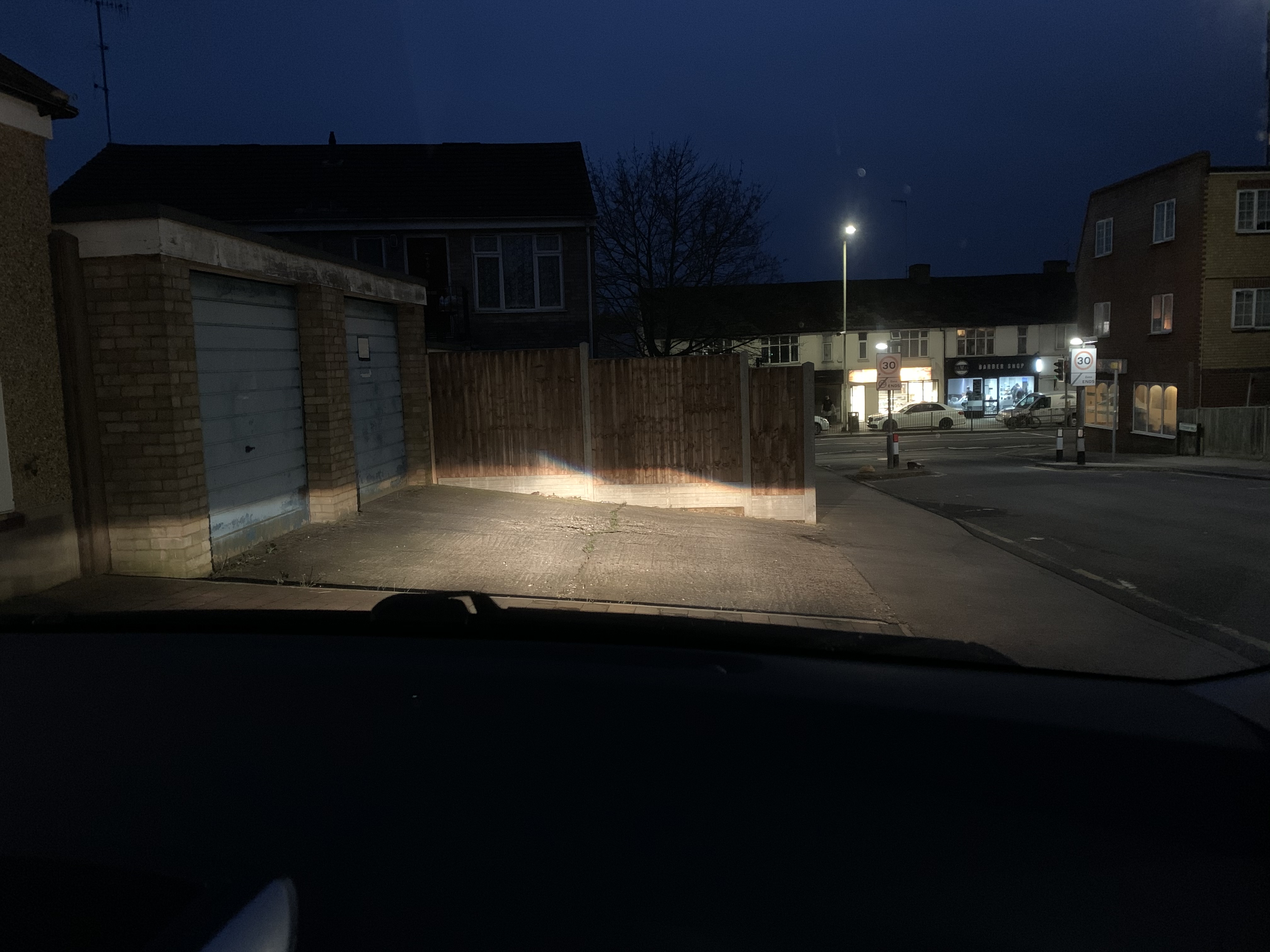

At night if you park against wall at around  5-6 metres away you can see the light pattern projecting onto the wall, note if both lights has same pattern, height and density. Like this picture but these are non led lights so yours will look differently. image.thumb.jpeg.122fda345e816cec4938ba0d535b4a16.jpeg

I will give this a go when it’s darker tonight. Not sure on levelling all they seem to be self levelling as when you initially turn the car on they move up and down slightly before setting themselves
