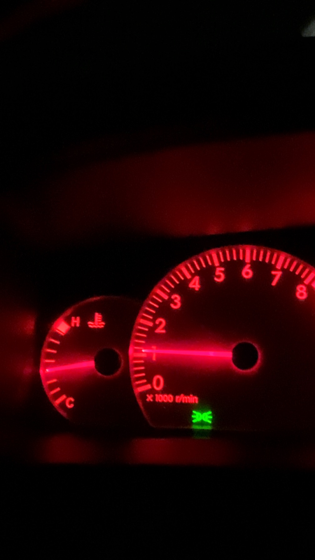

Hello guys, I’m having a rare occurrence well I think so anyways. My car seems to take a bit to reach full temp and once I get out driving my temp gauge seems to drop down below half way and maybe to the 2nd line before the bottom? Is this normal ? Usually tsports heat up to half way on the temp gauge and hold there. Any help or suggestions appreciated.
I had a TSport for many years. Your picture shows a gauge that is slightly lower than where it should be (even the standard Corolla is the same here) but the gauge in my experience never quite gets to the next line above in your image. In other words visually they always look a fraction below a true horizontal position.
It should never vary at all whether idling in freezing cold weather to pushing it hard and up to the 8200 rev limit. It should be rock steady.
Suspects could be the thermostat and also (given the age of these now) a cooling system that needs a good flush (radiator and heater matrix etc)

Aye, if it goes down when driving and up when idling it's a sticky thermostat.

Likely to be the thermostat stuck open. You can try motorway drive at 60-70mph and the temperature gauge will drop further.
