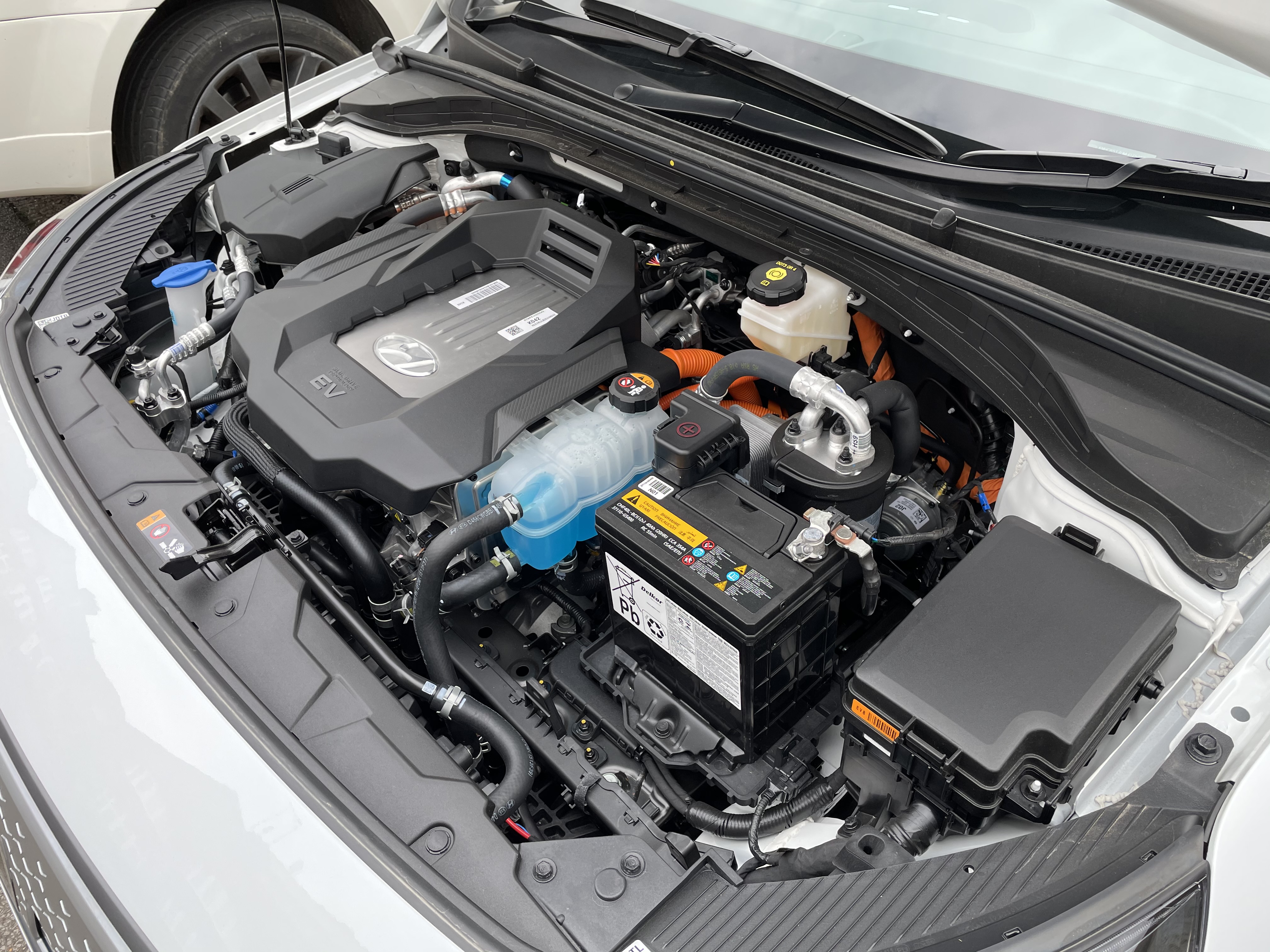

The only Hyundai I have access to is ioniq ev and here what 12v Battery has . This car also has a function to recharge the small 🔋 when the car is not in use. The same functionality has also a Nissan leaf . When they do that there are 3 blue lights on dashboard and one will be flashing. My Neighbor has a leaf and with solar charger when not in use, sometimes for months and the weather is cloudy the solar charger it’s not enough and the car takes over and recharge the 12v Battery. But these cars has large traction batteries., Toyota hybrids doesn’t.

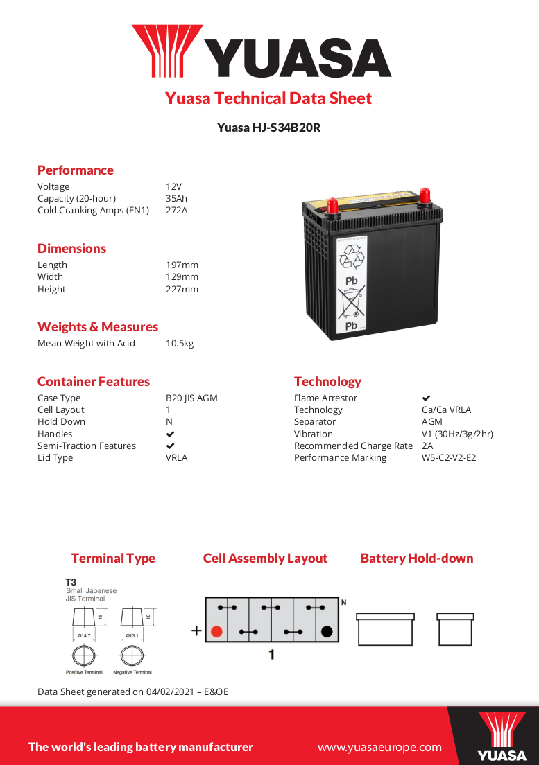

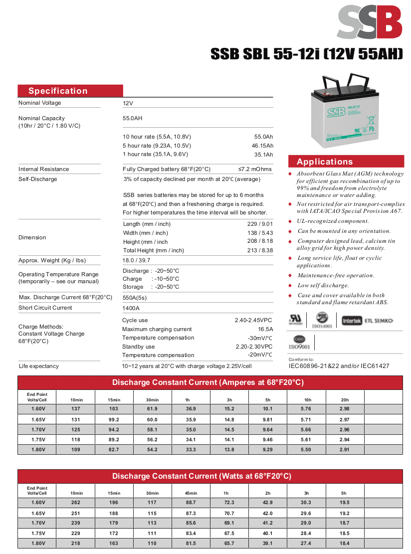

I installed a deep cycle AGM 55Ah that cost me ~£100 instead of original (poor) 35Ah one. A bit tight fit but totally worthy. This type of the Battery does not degrade when discharged. Normally it is used in mobility scooters or UPS systems that work for years!
No problems with Battery since then. I can use dascam parking recording for days.
I did not drive the car for 3 months and the Battery was still fine.
  • Like 5
This is the one I fitted.

Thank you very much for your information, I had a quick look at the 12c Battery area on my car, the space there is quite limited, less than 2 cm space available, the SSB Battery (length) is 3+ cm bigger than the Toyoya Battery (22.9cm vs 19.7cm), how did you manage to fit the SSB battery in? it seems to me impossible.

Of course SSB is bigger as it is a 55Ah vs 35Ah originally installed. It is not a drop in replacement. The fit is tight and the original mount is smaller. You can modify it (that's what I've done), made a custom one or purchase a bigger holder/rack. You also need to modify the terminal posts. All easily doable with some skill at hand.

You can also order the smaller one if you are not fancy to modify it. I went with a bigger Battery as I use Dashcam parking record.
https://www.battery-kutter.de/main/en/Lead-batteries-/AGM-batteries-
