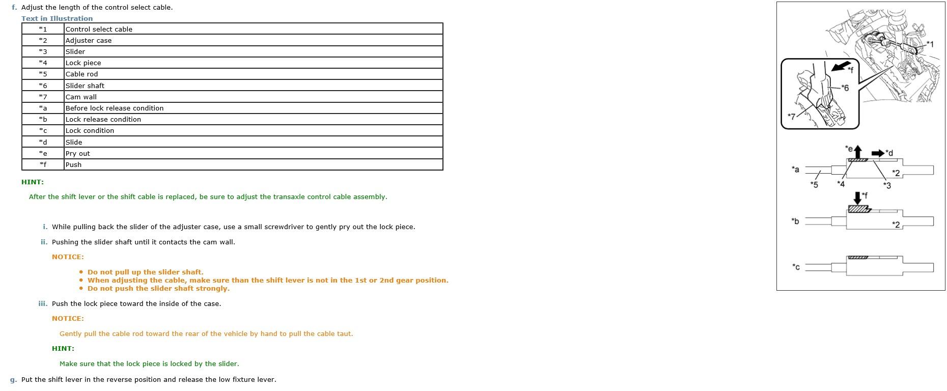

I think they mean TSB#  CP-0008T-0311 - Mk2 Yaris 6-speed gearbox, difficult to shift, especially 1st and 2nd.
I never did get my hands on it, but from what I understand it's essentially a guide to correctly recalibrate the gear shift cables as TMMF botched it in the initial introduction of the 6-speed and 1NR-FE and they somehow go out of alignment..
