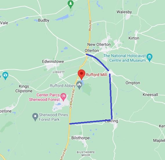

You won't get through now as the council have closed that road
What i didn't realise was if they had used the roads to get round it wouldn't have added much time and miles to the journey, people are so stupid.
