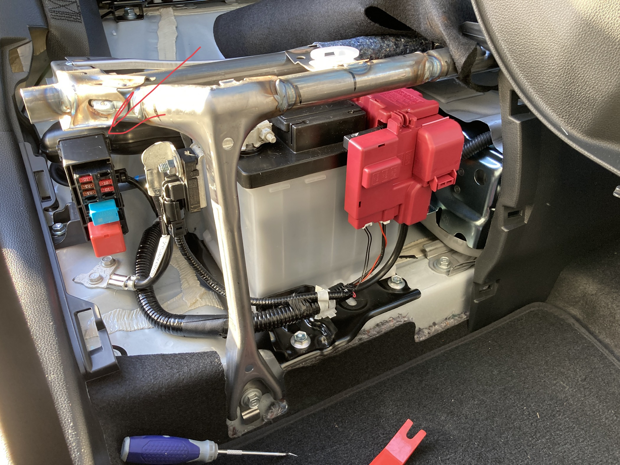

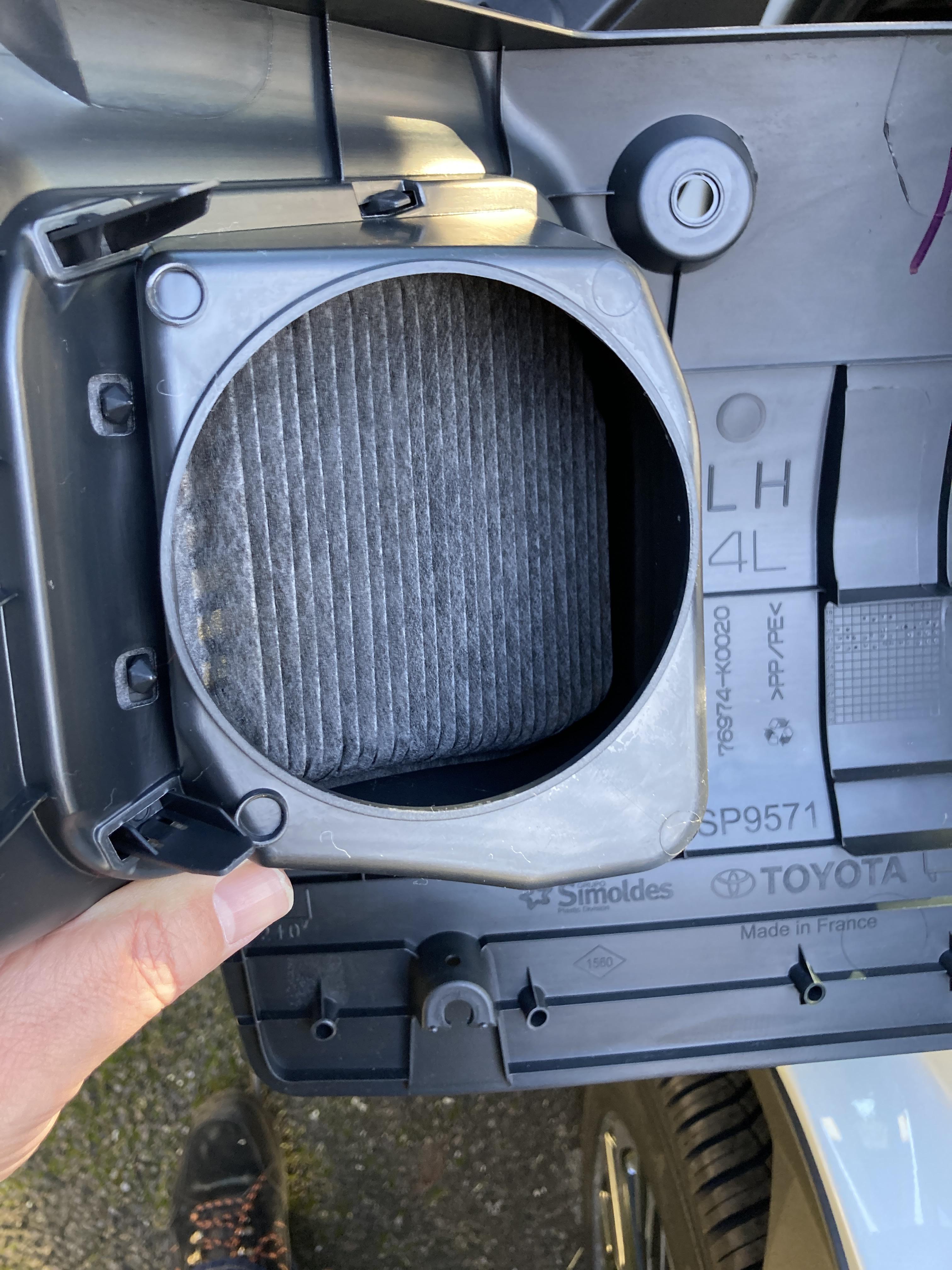

It goes in through a filter at the side of the left rear seat then it is pumped across the Battery to the right side and through a plastic tube and is then vented out through the chassis tube.  I’ve marked an arrow on the photo.

Cheers Roy, there is an intake vent/grill in the rear seat panel, thanks for the info on the boot vents.

29 minutes ago, olonas said:
Is that the infamous 12v battery I see lurking in that really accessible location? (sarcasm mode on)
Yes.
