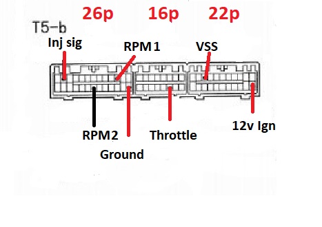

the unit was professionally installed by a company, so Ive no experience of the actual location of any of the wiring or fuses with regards to the Avcr or ECU (have checked basic ECU connection diagrams on line thought)

traced all the wires from the head unit to the loom connector and to the ECU and into the engine bay, there is nothing out of place, as mentioned the unit was installed professionally, so no issues with any of the wiring (that i can see) seems its ground into the ECU
