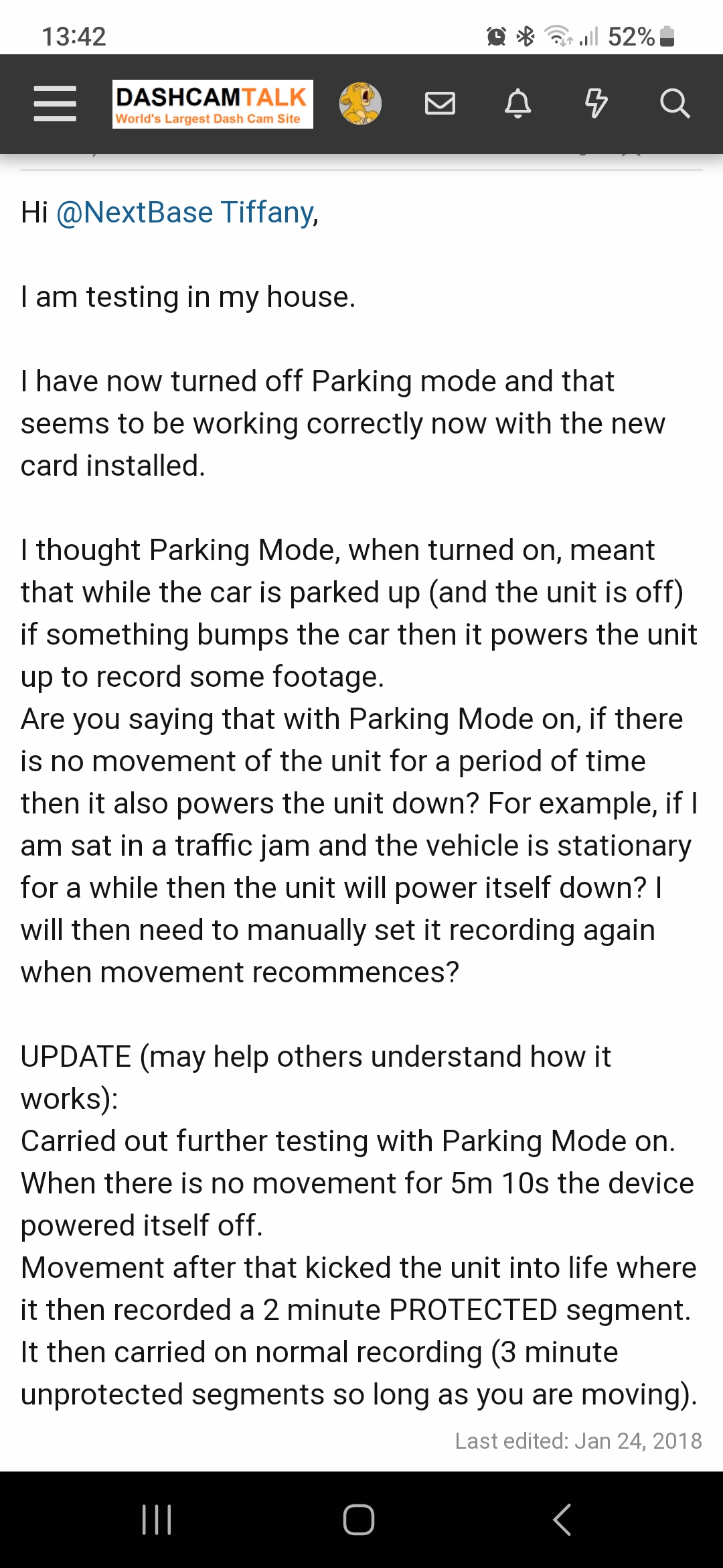

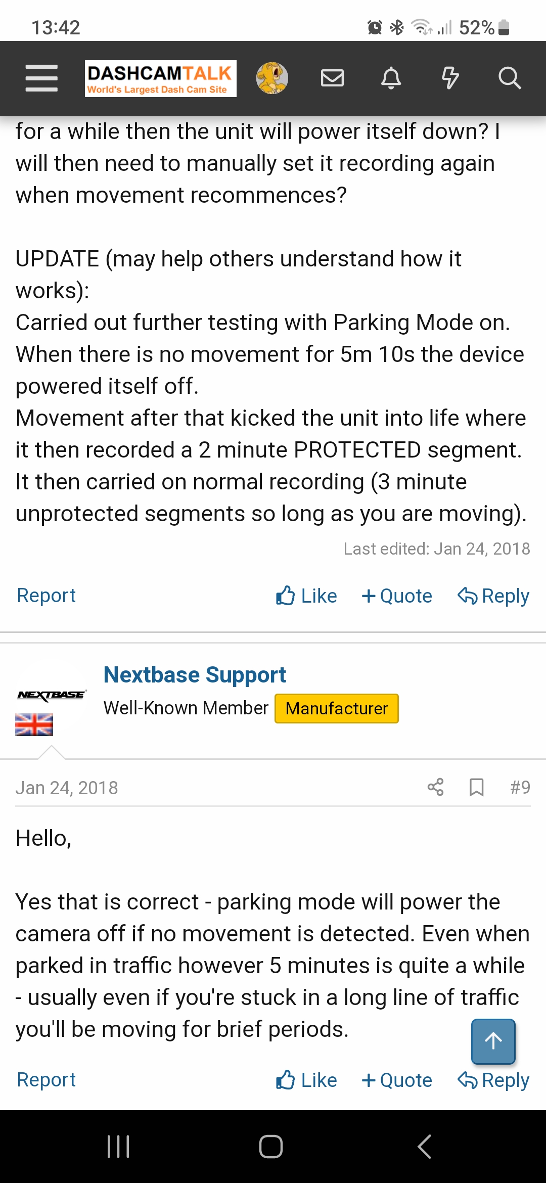

For some reason I could not attach a link from the Dashcam Forum/Nextbase.  I found a question and answer similar to yours, so I've attached a screenshot of the question and answer.
