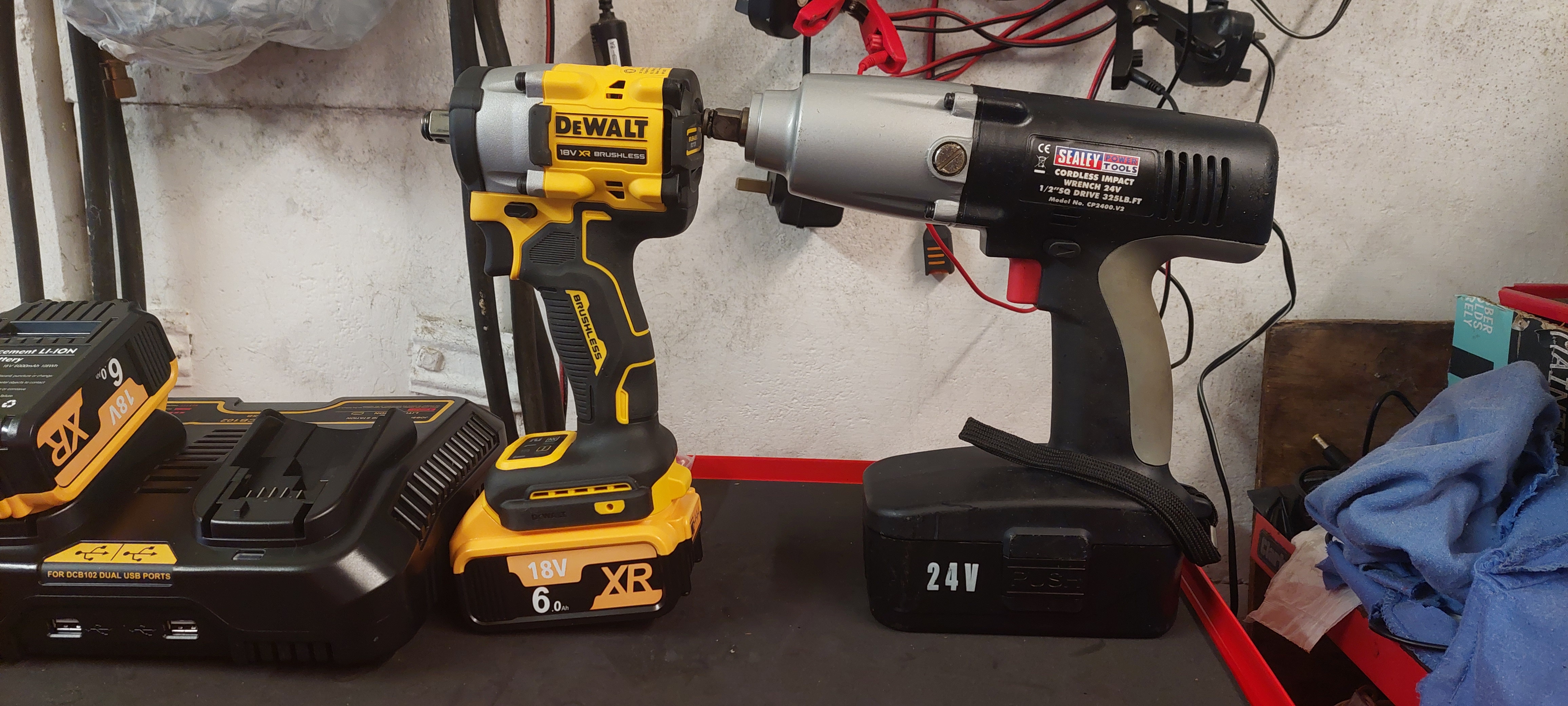

I've just bought one of these for nuts and a adapter to make it a impact driver, it's a lot more expensive but I needed another more compact impact gun to get into tight spaces, it's a lot more powerful than the Sealy gun
 https://www.amazon.co.uk/dp/B07P72CZ9C?psc=1&ref=ppx_yo2ov_dt_b_product_details

The 921 as a breaking torque of 610Nm and 406Nm tightening torque which is amazing given the size of it.

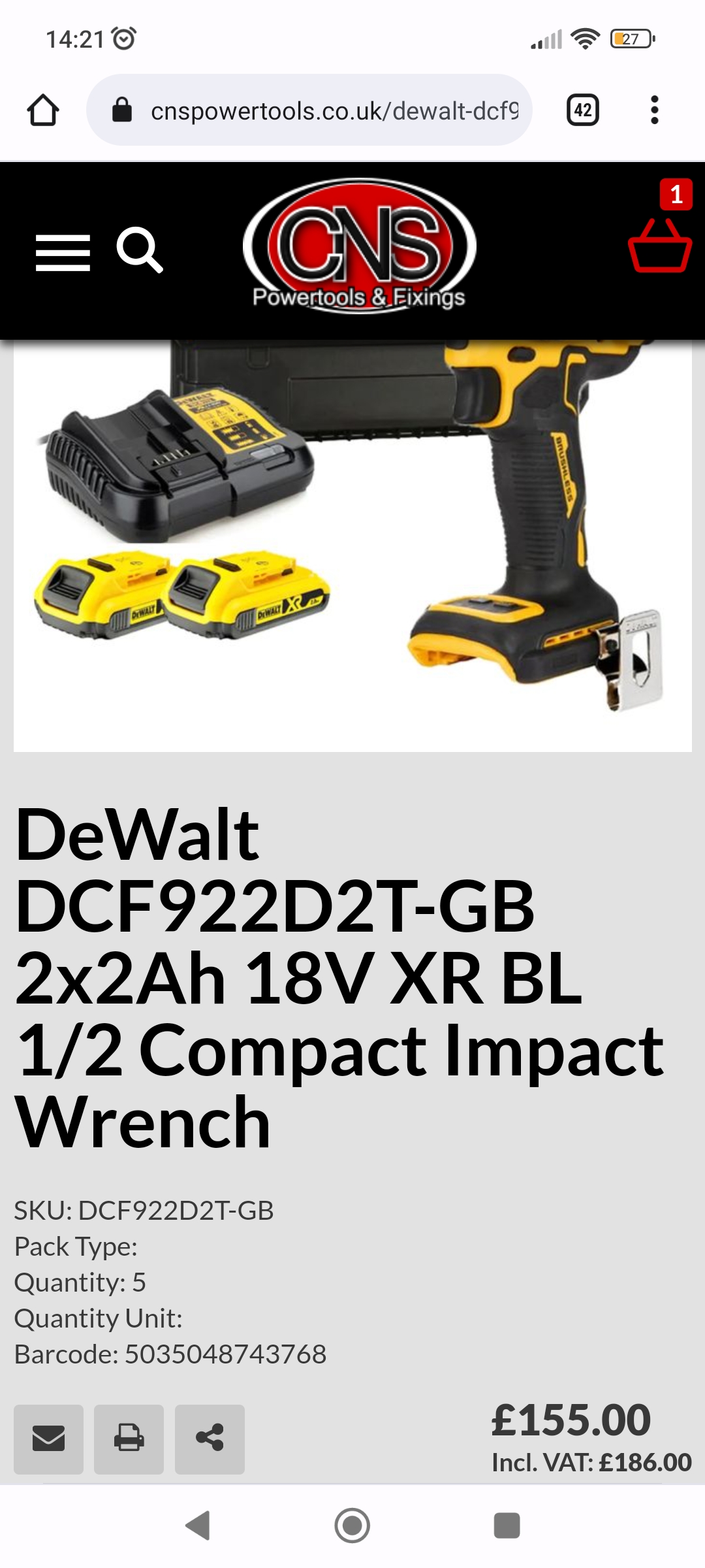

Screenshot_2023-05-27-14-21-32-583_com.android.chrome.thumb.jpg.95695f185972319347cec3a34dfc8fc3.jpg
205nm is peak torque at the anvil at peak voltage, add in the losses, and you can cut that by a 1/3
You want a 1/2 inch drive model that you can put sockets on. And, always tighten manually, not with an impact gun.
