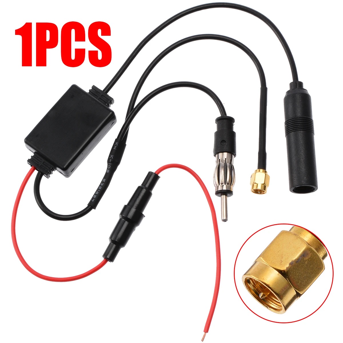

Last question - there’s these DAB adapters I’ve seen online that “tap” into your current radio antenna, get supplied with 12 volts and enable DAB. Are these any good? Given of course that I get the appropriate adapter cables hooked up to it.
I’ve attached a picture of one of them.
No they don't work great

DAB aerial no issue, it's the adapter, it's used by pioneer on oem products and not that easy to find unless you get it from China, you can get a GPS adapter and trim the connector to fit
SMA is threaded
SMB is press fit
DAB is very picky with antennas, YMMV

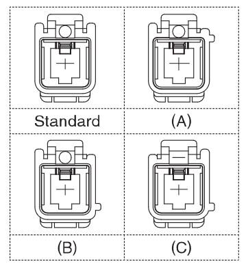

Blue is type C in the diagram

to get a standard plug to fit the blue socket, you just trim the top left guide (looking at the connector face on)
