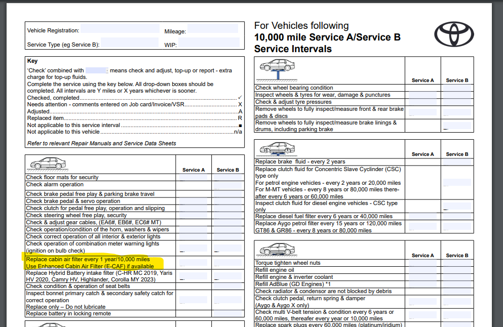

Your dealer is wrong and is mis-leading you, At the last Service price increase Toyota added Replace Pollen filter to all services, taken from online service booking site:
We recommend that Toyota owners carry out a 30,000 miles/3 Years intermediate service as per schedule. Scheduling regular service appointments as per your vehicles service schedule helps maintain the health and longevity of your vehicle whilst helping prevent maintenance issues down the road.
  • Carry out 30K/36 month intermediate service as per schedule.
  • Includes:- Replace engine oil & oil filter.
  • Replace windscreen washer fluid.
  • Check all fluid levels & top up as required.
  • Inspect Battery for leaks, security of clamps & terminals.
  • Inspect cooling system, hoses & connections.
  • Inspect radiator & condenser for debris & signs of damage.
  • Inspect air filter element.
  • Inspect charcoal canister.
  • Inspect brake pads & discs.
  • Inspect steering wheel, gear & linkages.
  • Inspect for under vehicle and under hood fluid leaks.
  • Inspect tyre condition & inflation pressures.
  • Check wheel nuts for correct torque specifications.
  • Check brake pedal travel.
  • Check operation of lights, horns, wipers & washers.
  • Check function of all warning lights.
  • Replace pollen filter.
  • Check seat belts for damage & operation.
  • Check installation of driver's floor mat.
  • Carry out hybrid health check.
  • Carry out wash & vacuum.
  • Carry out visual safety report
Snipped from current Service check sheet:
OK ... 🙂 ... I simply reflected what it said on my most recent service sheet ... last September ... 😉
The information was correct in Sept 22 the changes cam in Jan 2023

Brilliant, thanks for all the replies, so I had the minor annual service - not the full one this time, Toyota said the pollen filter wasn’t included, a bit strange as it is only a 2-3 minute job. Anyway, I will use the links provided and get a Toyota pollen filter ordered. I have to say that the Toyota dealer service that I received was excellent.
I don't know when it changed, as like you I've never had them change the pollen filter in my previous cars, but in my new one they've changed it every service so far! (And I checked!)

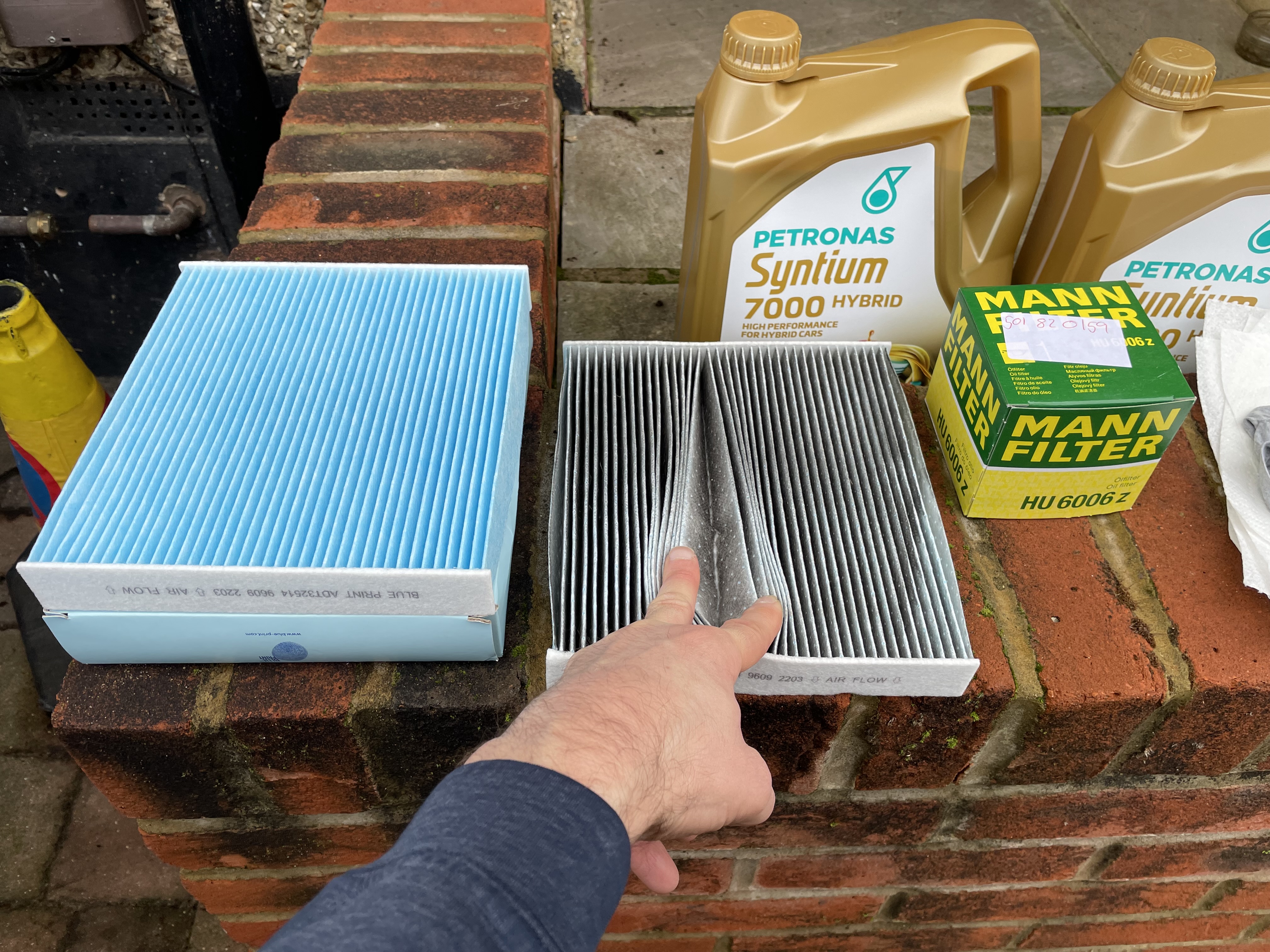

On my 2017 pollen filter is changed in major services, means every other service.  I normally ask them to replace every year anyway or I get the OEM filter with them (last one in 2022 was £22.00) and change myself.  It is literally 5min job.

Serviced RAV4 and Auris recently (both minor services)  and Toyota dealer replaced pollen filters with the enhanced (activated carbon) filters.
You can get 3rd party activated carbon filters online, few part numbers I used in the past:
NAPA NFC4050 - used this last time, under £8
HENGST E4959LC
Bosch R5590
