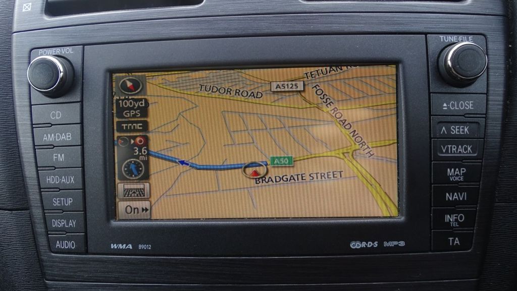

A quick question. The  2011 Avensis 2.2 DCat I bought (not yet with me, to be delivered Thursday) has the central console shown below. I know it allows phone connection via bluetooth for hands free calls, but does it also allow music streaming from an iPhone? I didn't ask at the time because I'm as thick as mince.

Yours is 2018, so I hope it'll work like that in a 2011 model!
Works perfectly - thanks all!

The B9012 navigation unit has Bluetooth streaming, as confirmed by the OP.
