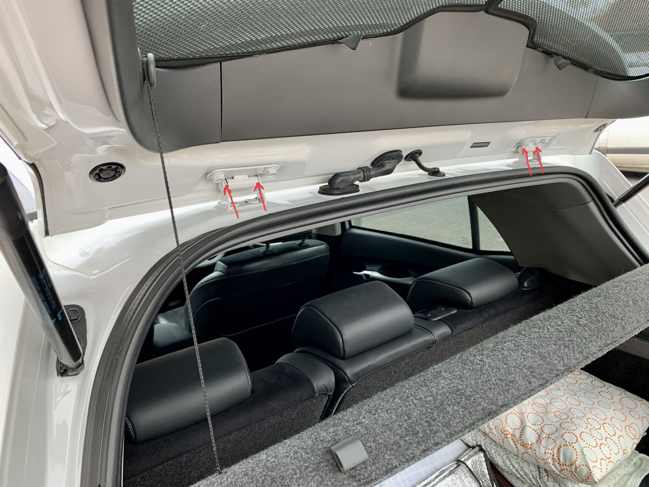

Hi,
this is typical Toyota thing. Usually comes from the hinges and not from the struts. It looks like the struts but it is not. Have some wd-40 original not the  silicone and spray on the hinges and  open close few times. If it helps then after a while you can add some thin oil to lube better and  hold for longer.  Wipe off any excess around as it vector dark and dirty and does not look good. 👍 image.thumb.jpeg.3be9414914197d5fc502cf7236bd727c.jpeg
Thank-you so much, I’ve just sprayed with wd40 (normal) opened and closed and wiped off the residue and the tailgate is as quiet as can be.
You are welcome. Glad it helped. If it starts again , you can add some oil or grease instead . 👍
