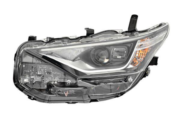

Do these headlights have replaceable lamps or do you have to change the whole assembly?
You can replace the buld from inside ie open the bonnet and look at the back of the light.
Remove bulb cover then remove bulb and read data printed on bulb base/case.
Bulb part number and wattage are what you after.
I don't think these have bulbs you can change. you have to replace the whole thing
That picture is for BI-LED headlights.  It has no replacable low and high beams and also DRL. Only the turn signal, emergency,  and parking lights are replacable (halogen bulbs),
