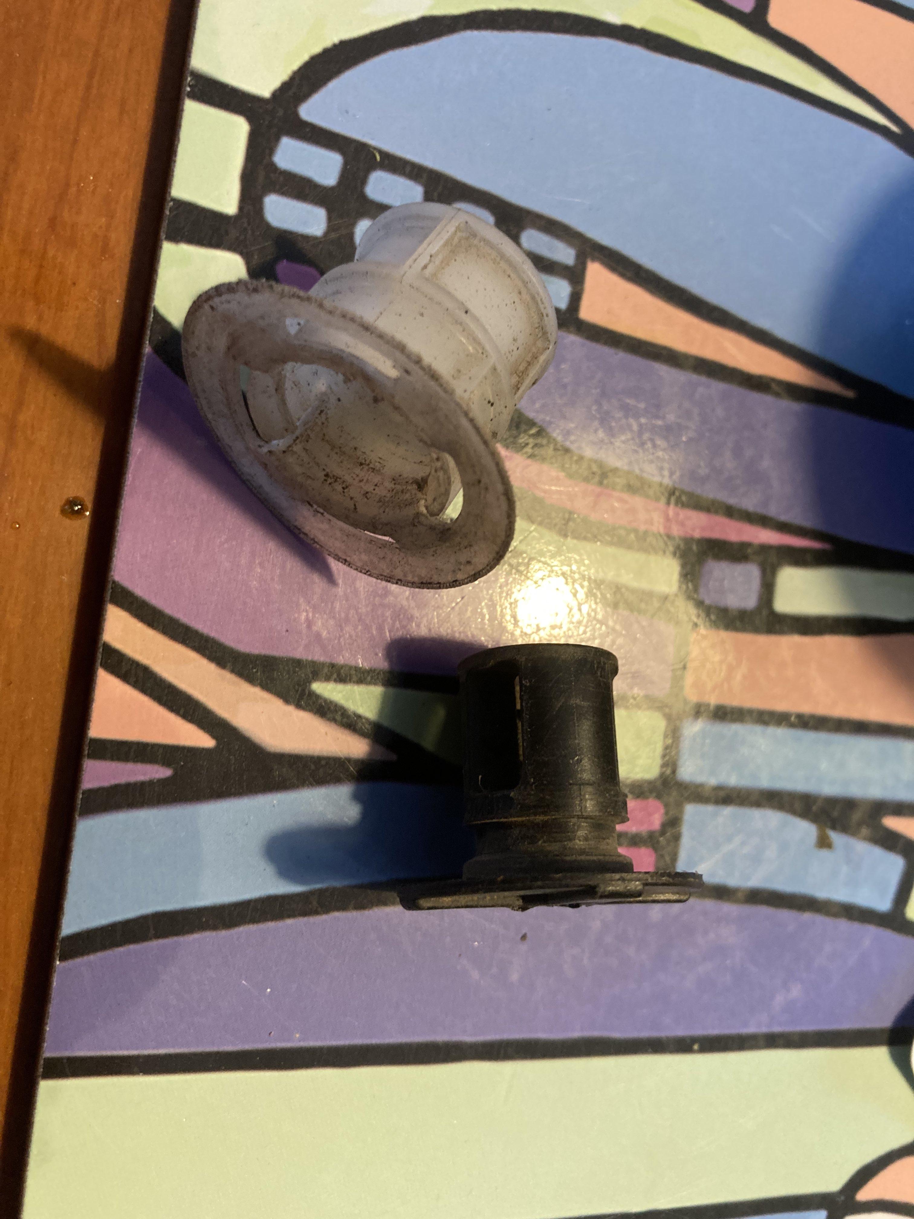

Hi - I had a towbar fitted a few months ago and the undertray is now coming loose.  I'm struggling to identify the clip in the picture in order to get a replacement.

I'm not sure is Your car sedan or wagon but I think they are same clips in both models.
In this pic 58399E part code is 90467-W0012 and 58399F part code is 90467-W0013.
Dealer maybe sells those at package wich includes both parts but I'm not 100% sure about it.
