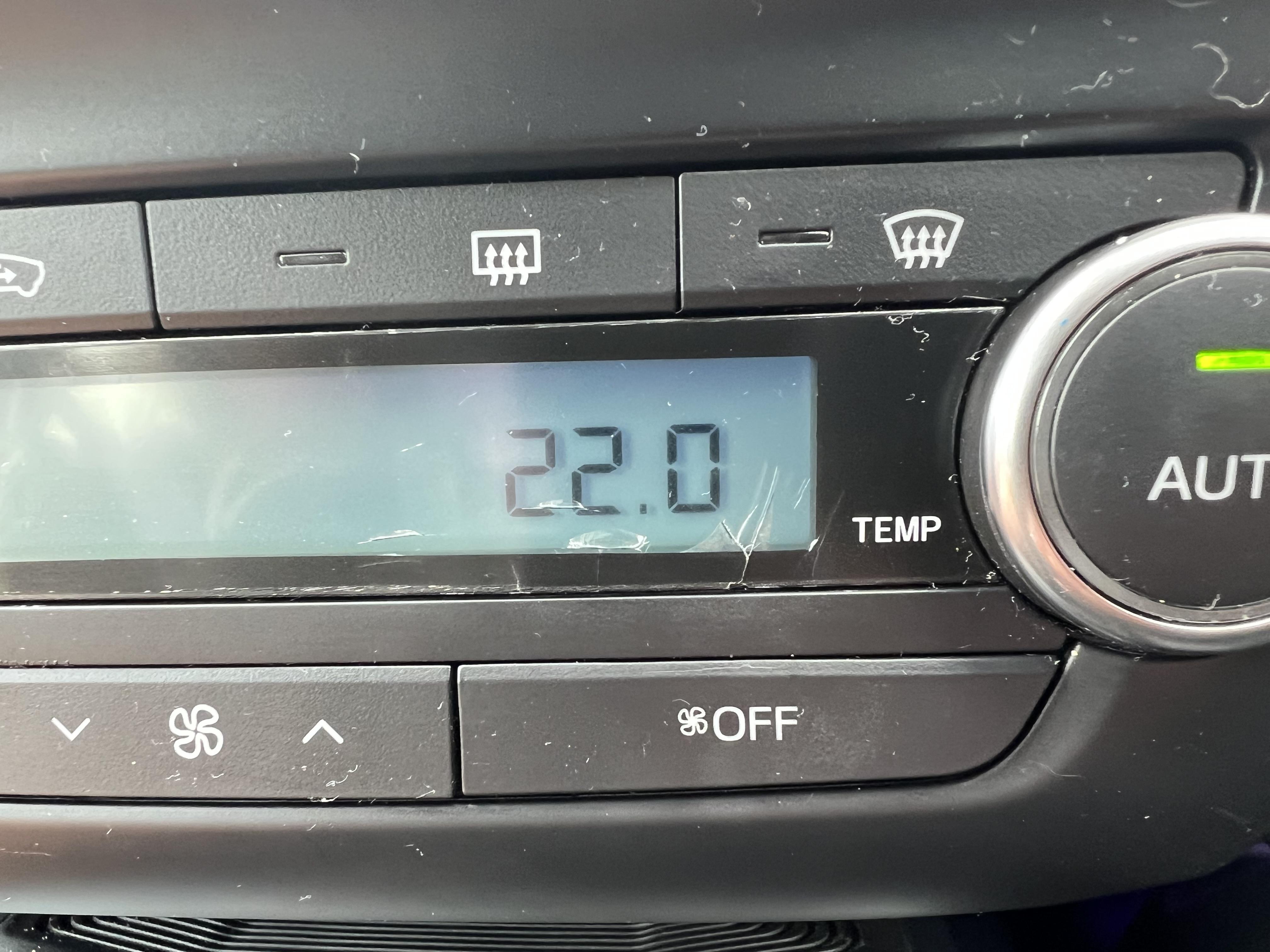

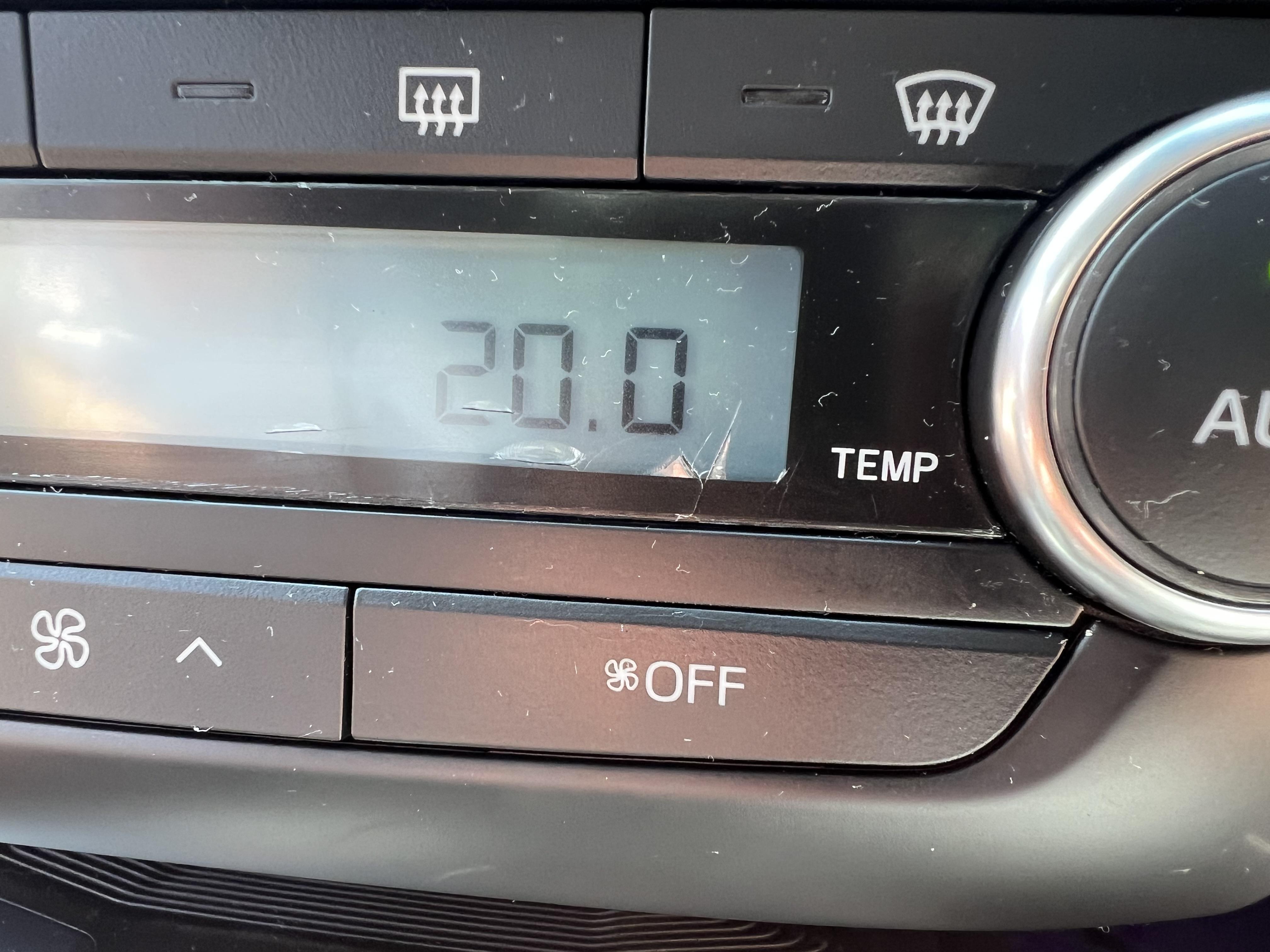

Got an odd issue with the Avensis. The centre climate control unit inside the car, the screen on this between the temperature dials has begun to crack up.
Two hairline cracks on the bottom right started to appear, as well as a slight peel along the bottom right edge. The weeks after, they became more pronounced, the cracks are coming from the inside of the screen (the inside face of the clear transparent screen cover). More are appearing by the week.
Logically, you'd think that something has physically hit this and cracked it. But I am 99% certain this never happened - honestly. There is no sign of impact either, such as scratches / a mess where an object would have hit it.
It's bizarre. I'm not sure what is causing it, unless someone has hit it and I don't know, or I've done it without realising but I really don't believe this has happened.
I took it to Toyota, they said it looks like physical damage and they wouldn't even put the request through as this is how it would seem to the claims department. And sure enough, it would look that way. I mostly wanted to know if this was some common issue they might have known about. Apparently not. I haven't seen it on any other Avensis either.
The unit is something like £980 - they don't sell parts like this. Nor is it really made to be replaced. But it was put together by someone at some stage, so my plan is to find a used or broken unit with this piece in tact and take it apart carefully, harvest the plastic and put it on to my unit. Is this feasible? Any other good ideas to try to fix it?

Some very good news to add to this. READ IF YOU HAVE THE SAME PROBLEM
Although at first attempt my local dealer said "No, it appears to clearly be damaged", yesterday in an actual booked-in inspection they agreed to replace the unit under warranty. This was following a message to Toyota UK on Facebook who opened a case (much easier than being on hold on the phone for up to an hour).
I prepared and printed out a couple of pages. One showed a timeline of my climate control screen as in the background of various photos I took of my cars interior from the day I first looked at the car to frequent cleaning / trying out new cleaning products and cloths. I'd often send a friend a pic of a before and after etc (don't worry - he's as into cars and cleaning them so it's not as boring as it sounds!).  Thankfully these photos saved me, as you could see the initial 'spec', turning into a 3mm hairline line, then a crack on the inside, then others sporadically appearing over the months. And then recently, getting very bad to where the now deep cracks appear to be 'lifting' out toward you and pulling up the screen. This was the first part.
The second part was that I looked at all 68 used Avensis models on AutoTrader on Monday evening. Over half of them had the same issue. Either the plastic was missing from wear or failing of the thin plastic matt finish material that goes over the hard plastic. OR, in some cases cracks along the screen similar to mine. A few had very , very bad cracking identical to mine across the entire screen. This was a good enough basis for me to prove that it was not in fact (a) a one off damage by me, (b) the problem is apparent in other Avensis model - it's unlikely that every single one happened to have a 'smack' to the same intensity / focus area as mine.
So that's it, agreed to be fixed under warranty. It expires 5th September. even if it goes another 5 years before similar cracking then it'll be an old car and not such a big issue to live with 🙂  That's £1,189 on the invoice, £0.00 payable.
Any of you - and I'm aware that it's a tiny fraction left - with last Avensis models rolling off the line in August 2018 like mine - that will soon be expiring on the 5 year warranty - Should go now and log the claim now and try to get this replaced. It appears that with the right evidence they will honour a claim. I'm happy to privately send you my case number an a copy of the document I put together to assist.
