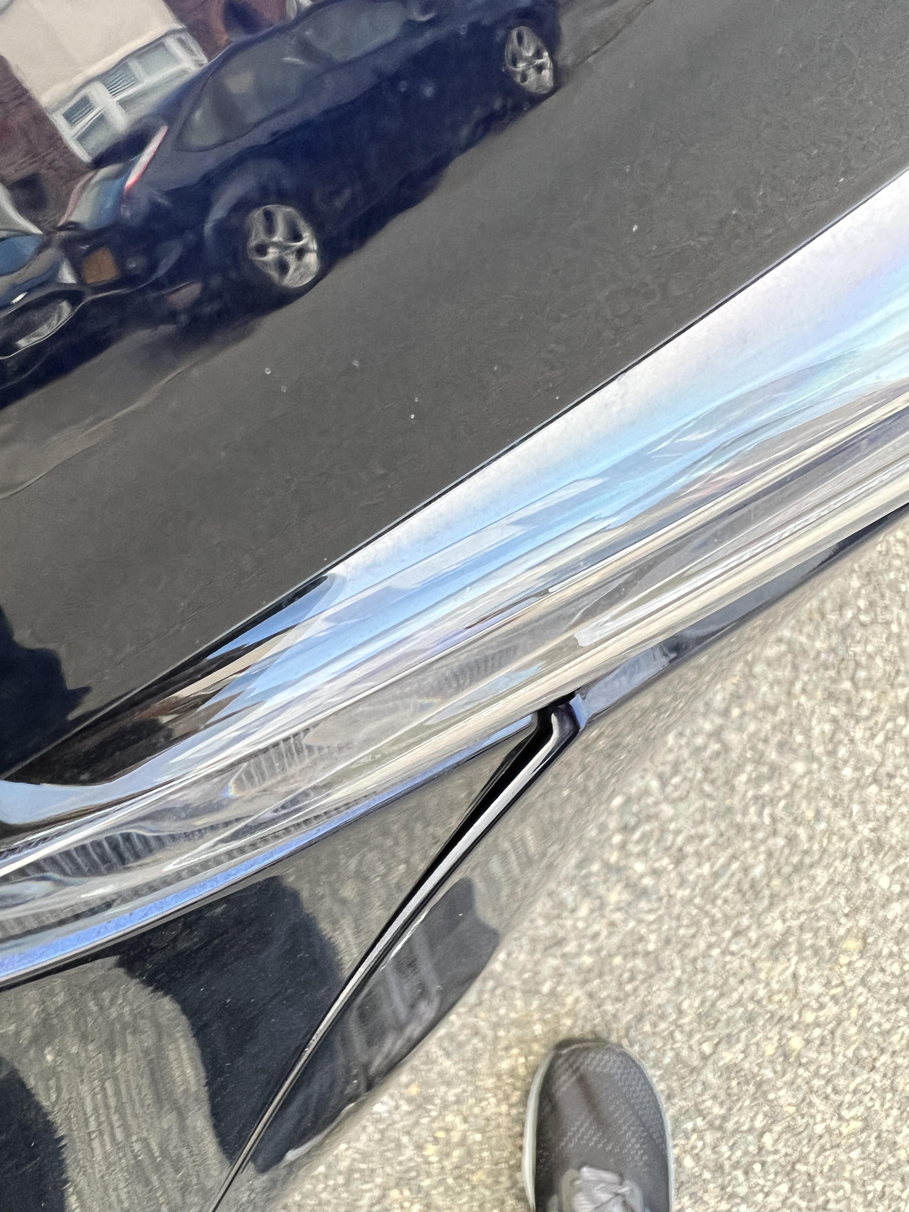

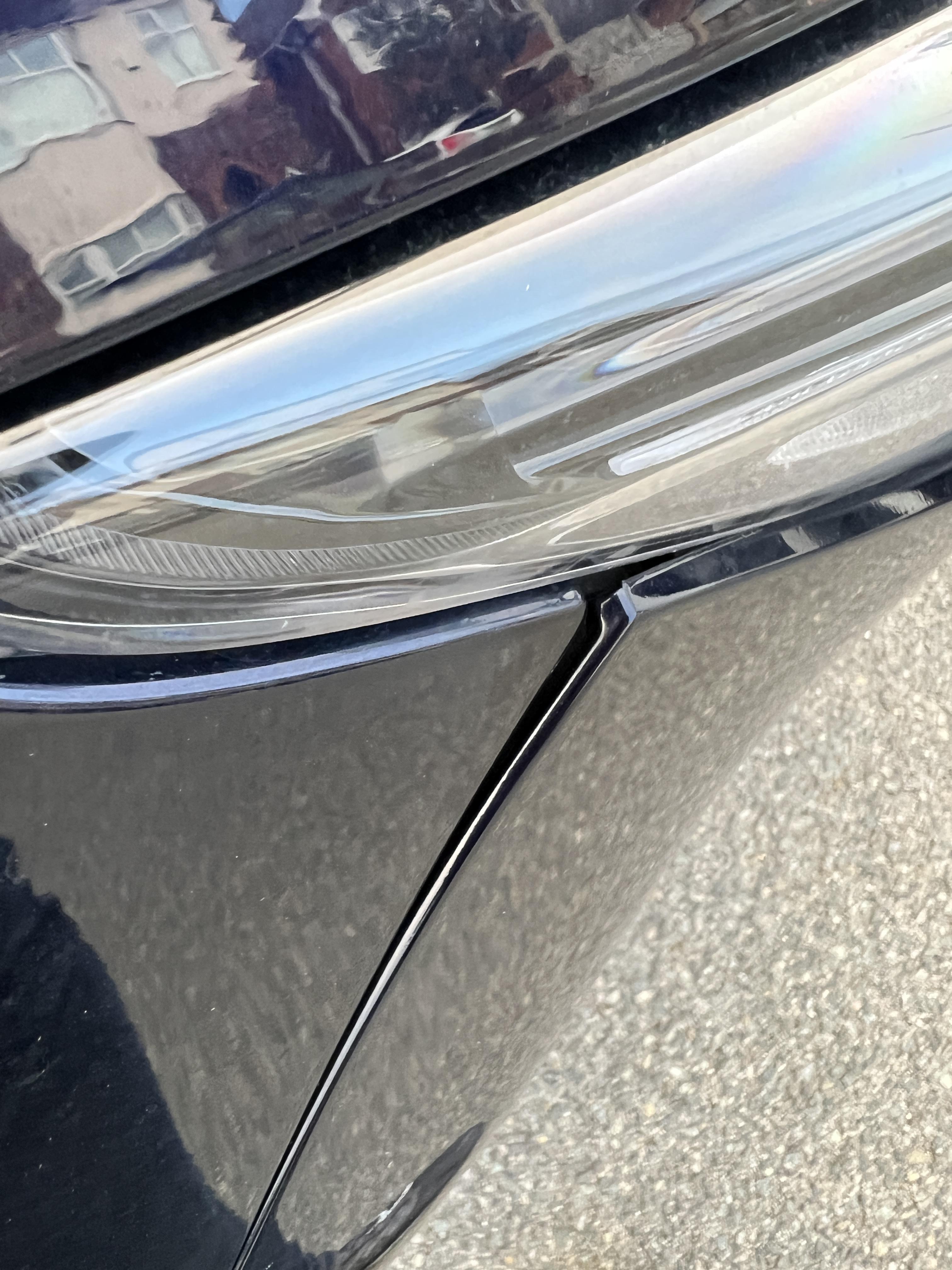

Hi,
I noticed recently my 2022 Corolla HB driver side corner bumper is protruding at the corner, as shown on the images attached.
Has anyone had this before?
I can push this corner in and it kinda stays but after a bit of driving it’s back out again. Guessing it’s a warranty job, I hope!
Doesn't look right to me, I'd take it back to the dealership and get them to inspect it. Looks like the bumper isn't fitted correctly.
Have you had a look underneath the bumper to to see if a clip or bracket has broken. If it's under warranty take it back, but it doesn't hurt to have a look to see if it is something simple that you can maybe do yourself to save taking it back to the dealership.👍
This could had happen after you had a bump into something. Sometimes even just so slightly that you may never notice you have hit wile in reverse and this is exactly what would happen. Bumper flexes and opens at the corners. In some cases is possible to reattach just with a push but if it doesn’t means you will need to take off , align or replace clips under and fit again. If the car was always like that very likely wasn’t fitted correctly in factory. We have seen already few of these on other Corolla cars. Or perhaps they all had a little bump while I transit., people these days aren’t very carefully while handling others properties.
