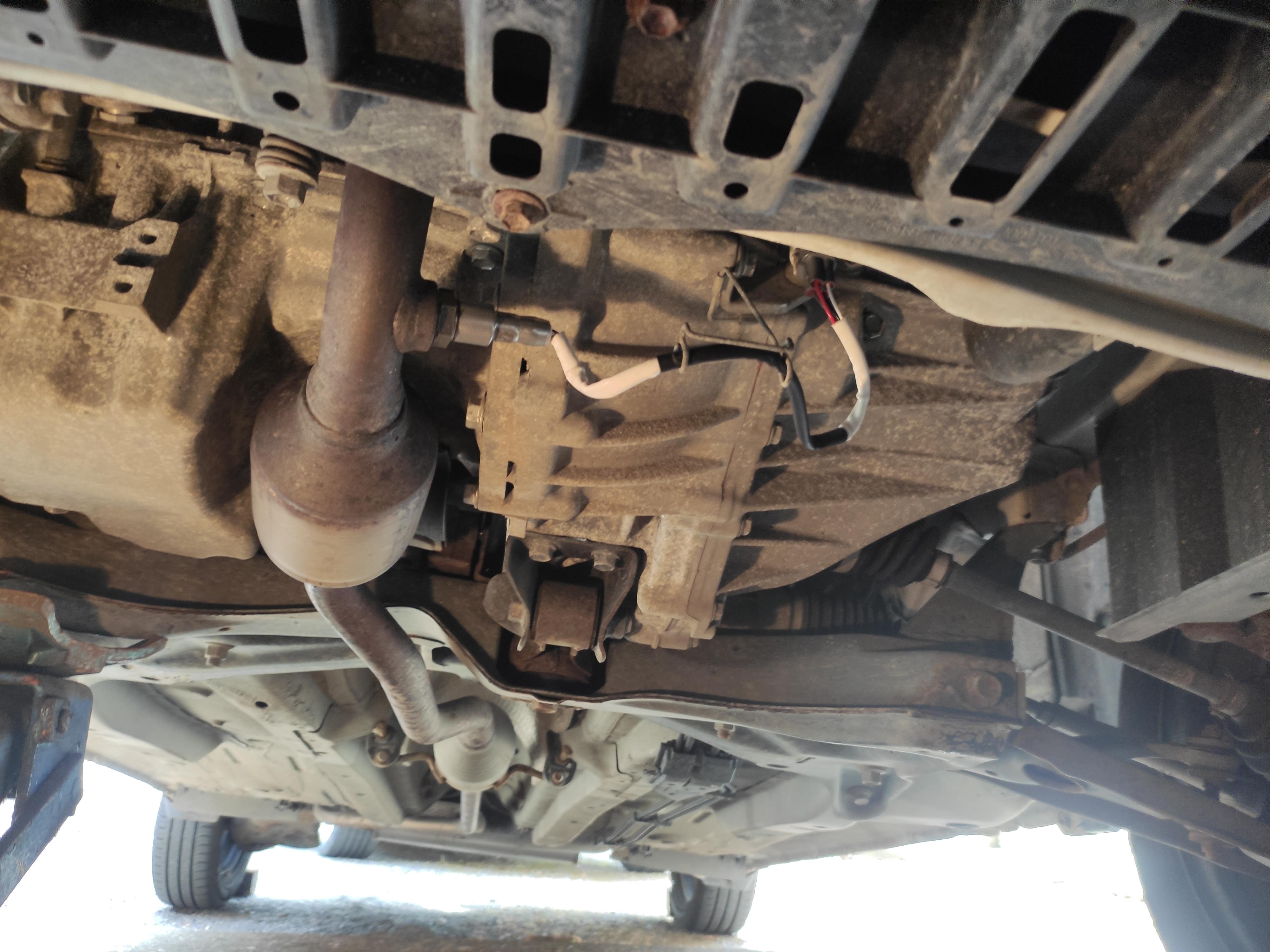

I have limited spannering skills and changed the post cat sensor myself. I did buy a sensor removal kit from Amazon which made the whole thing easier. Still needed a fair bit of effort,but managed it. After replacement, ran it for a while, turned it off and on again and the lights disappeared. Didn't need to reset them, just be patient.
I haven't got any pics of when i did it. If you jack the car up and look at the exhaust downpipe it'll be really obvious where it is.
I managed to swap the sensor yesterday, I was very, very close to giving up but managed to get the old sensor off. As you said the lights don't go away immediately, so I need to take it out to see if it makes any difference. Fingers crossed. Thanks for the advice, much appreciated.
